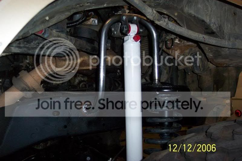

After the axles were in it was time to makes sure the 40's cleared and measure fore brake lines and shocks.
Shane M
Aug 12, 2007
65
Prescott
89
Shock mounting.

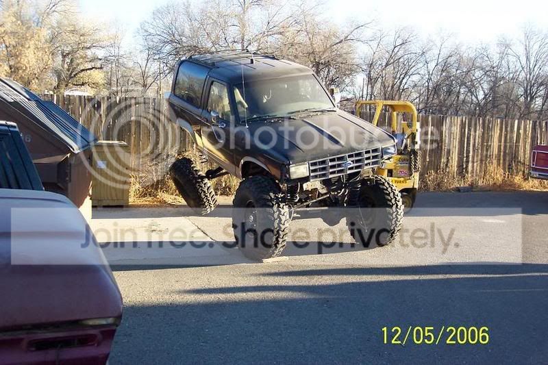

Now it was time for some wheelin/testing.

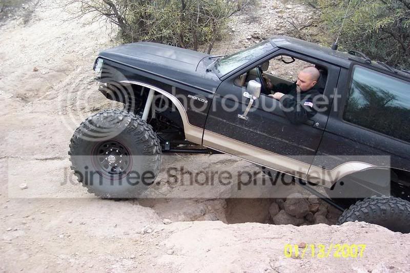

Next trail.
And the first carnage. Bent .250 wall DOM link.

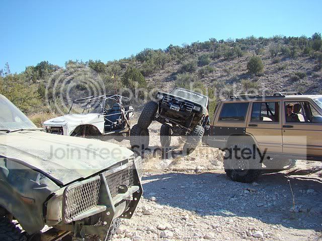

Then it was off to Moab.
Jeeps dont do well
But B2's do
Couple more of a little obstacle called Rockchucker

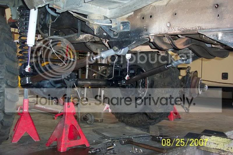

After sweating bullets with the 44 front (it did have superiors and CTM's) the time had come to build my 60 I have had for a few years waiting. It got built using 5:38's, detroit, Spicer x joints on stock shafts for now, hi steer, superwich hubs, and all new bearings, brakes, seals.......It also got pushed foward 2 inches to better the approach angle and to use the winch as a suck down. WB is now 113

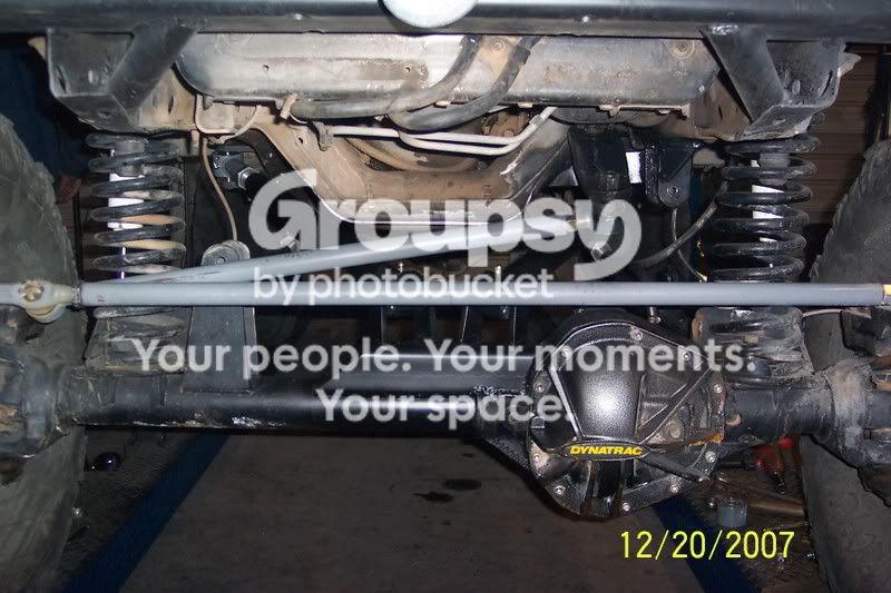

After a wile on the front radius setup with the new 60 I wasn't linking how it worked. So a 4 link went in the front too. Although it doesn't flex more, it just doesn't have the bind.
