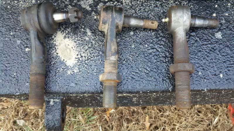

I took mine apart today and mine must be the older version like you mentioned. The 4lower TREs appear to all be the same while the upper for the pitman arm is a tad bigger, about the size of a stock ranger TRE. I read on the net that stock ranger TREs would work for the 4links on the superrunner setup but the ranger TRE is bigger.. Are the threaded ends on B2 or 2wd ranger TREs smaller than those on my 4x4? Unless i can find an oem replacement ill just have to make my own tubes and probably just run heims with the misalignment spacers. should be easer to maintain and replace.
Here is a pic of the ends.. left is stock ranger, center is one of the lowers from the superrunner, and the right is the centerlink/pitman arm end from the superrunner

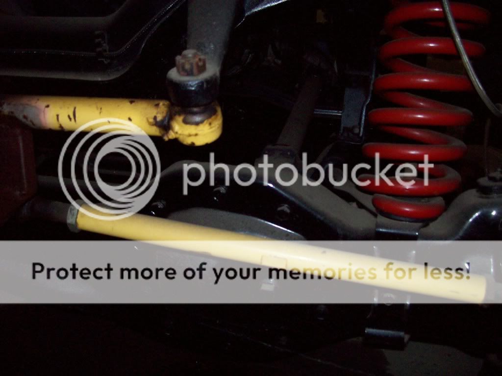

Here is the older set up.You can see where the tube has flat spots machined in it to turn the tube to adjust the length.I bought this set up new in the early 90's.I also dropped the center 3 inches.

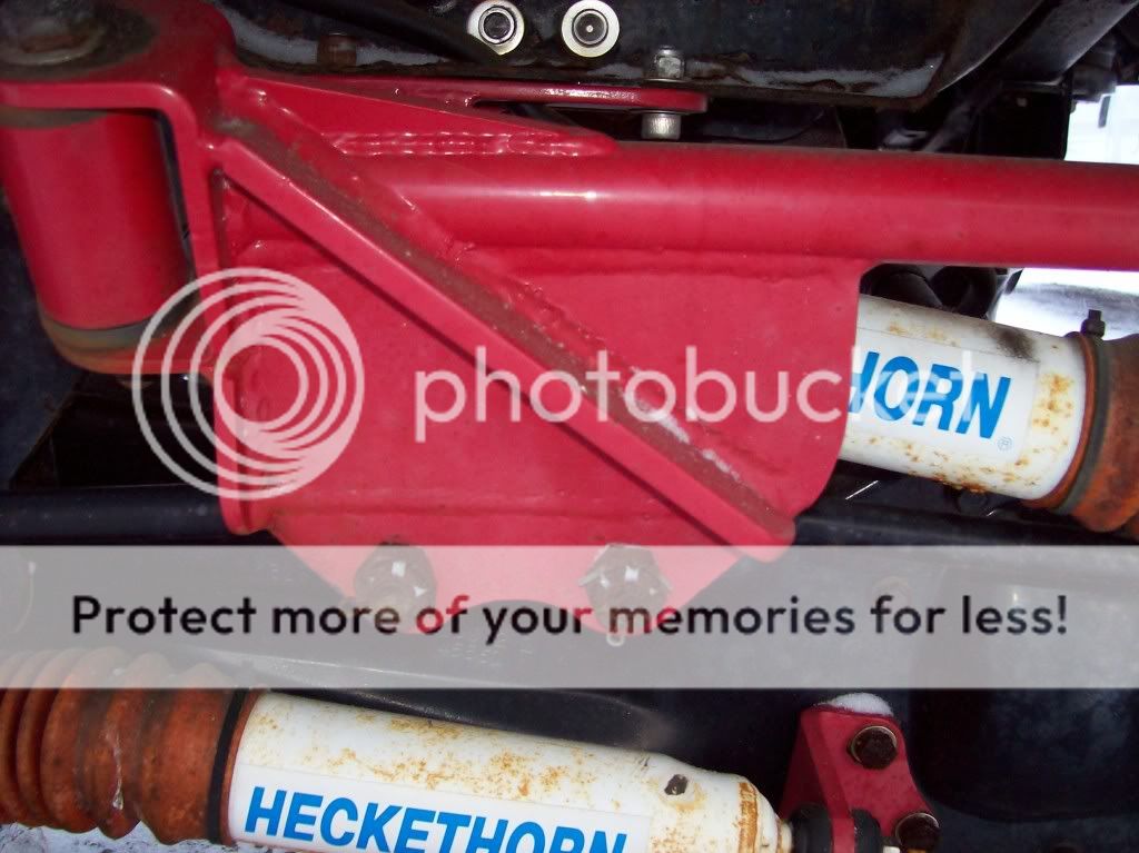

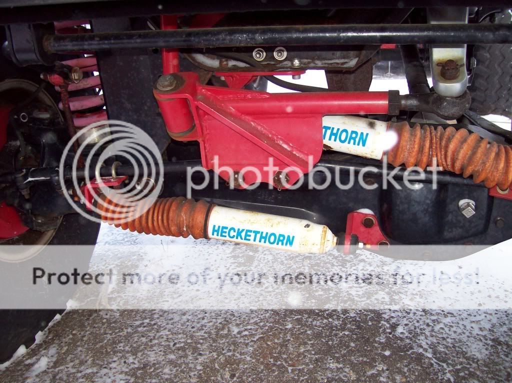

Here is the newer set up with short and long tre's with regular adjusters.This is the set up superlift sells now.I dropped the center 3 inches.And replaced the welded tre on the pitman arm with a explorer tre.I tapped the tube with a 22mx1.5 tap and used a jam nut.The tube is 1&1/4 dom.I also replaced the bushings with UHMW.The superlift poly ones had to much play in them for me.

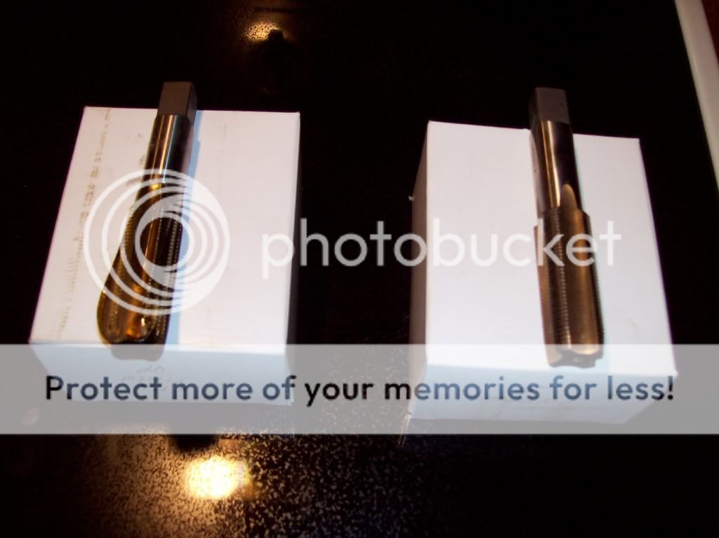

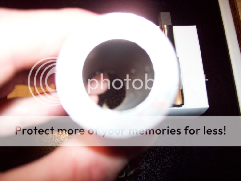

Here are the taps I am using to make my new links.
left one is m20x1.5 LH and the right one is m22x1.5 rh in the boxes under the are 25 jam nuts same thread as the taps.
K-Link...Heims or TREs?

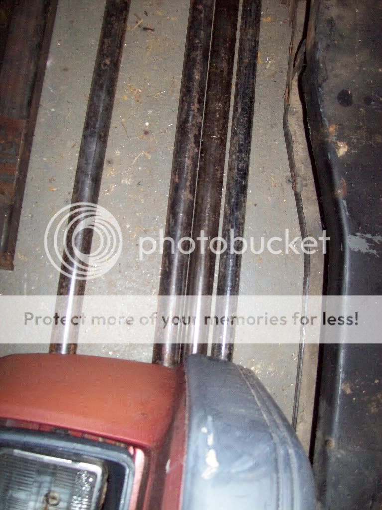

And here is a 10 ft stick of 1&1/4 dom 250 wall for the upper link and two 11 ft sticks of 1&1/4 290 wall for the tre links.
I am having the drop centers laser cut so I can build my own set ups.Just waiting on them and my reamer to show up.The 290 wall is so I can tap one end m20x1.5.I will have to drill the dom to size to tap each end but that way i don't have to use inserts.And it all will be off the shelf right and left explorer tre's and jam nuts.Let me know if you need anything else.

I am going from memory.The drivers side is m22 RH thread and passenger side is m20 LH thread. stock explorer short tre's.One has to be RH thread and one LH thread to be able to adjust it without taking one end lose.With RH and LH threads turn the link one way and both screw in turn the other and both screw out.The taps are not to bad high.Rh was like $20 and LH was $39 I think,bought them back in the summer.I have the number of the place and they ship if you are interested.
