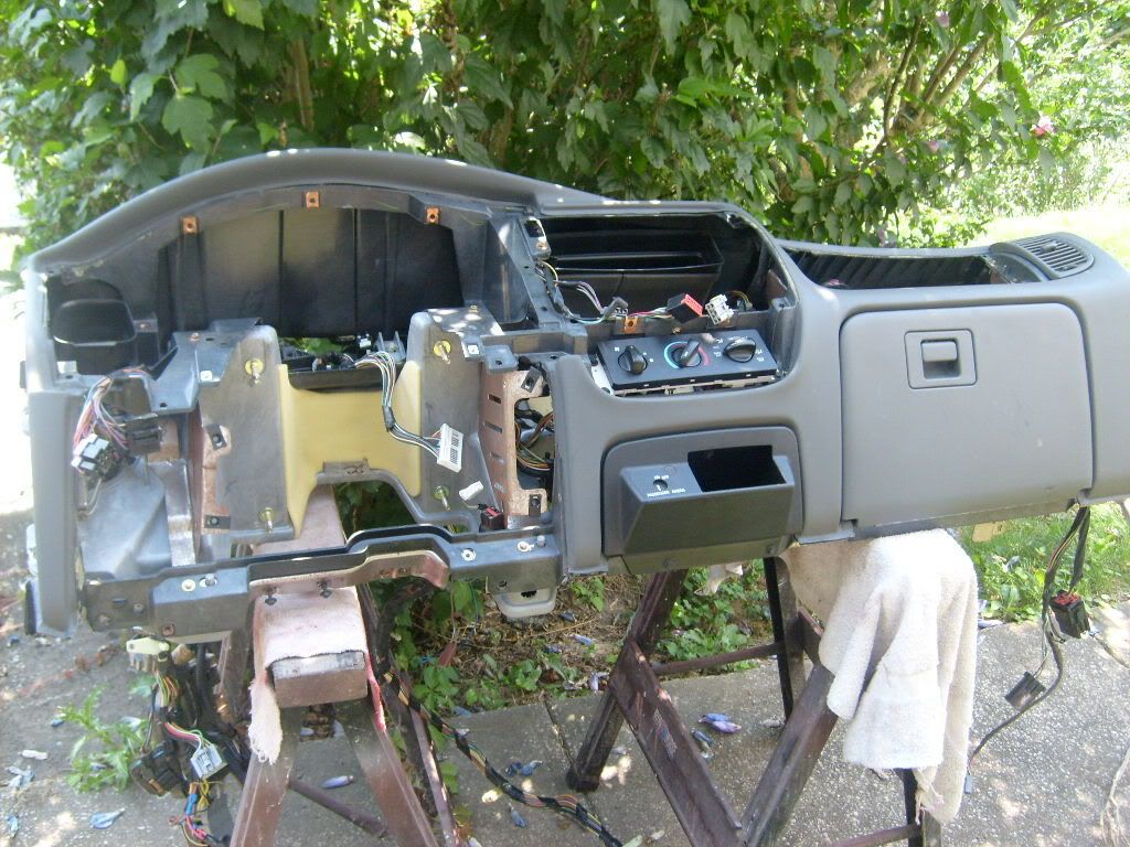

I am not going to cover removing the dash but here is the factory dash removed without any modifications to the harness.

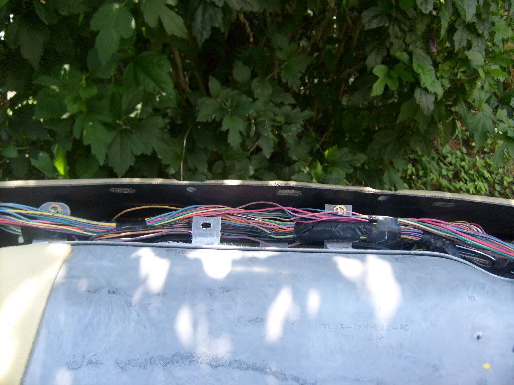

I removed the factory harness from the dash. Note the door plug near the fuse box with only 4 wires on the drivers side.

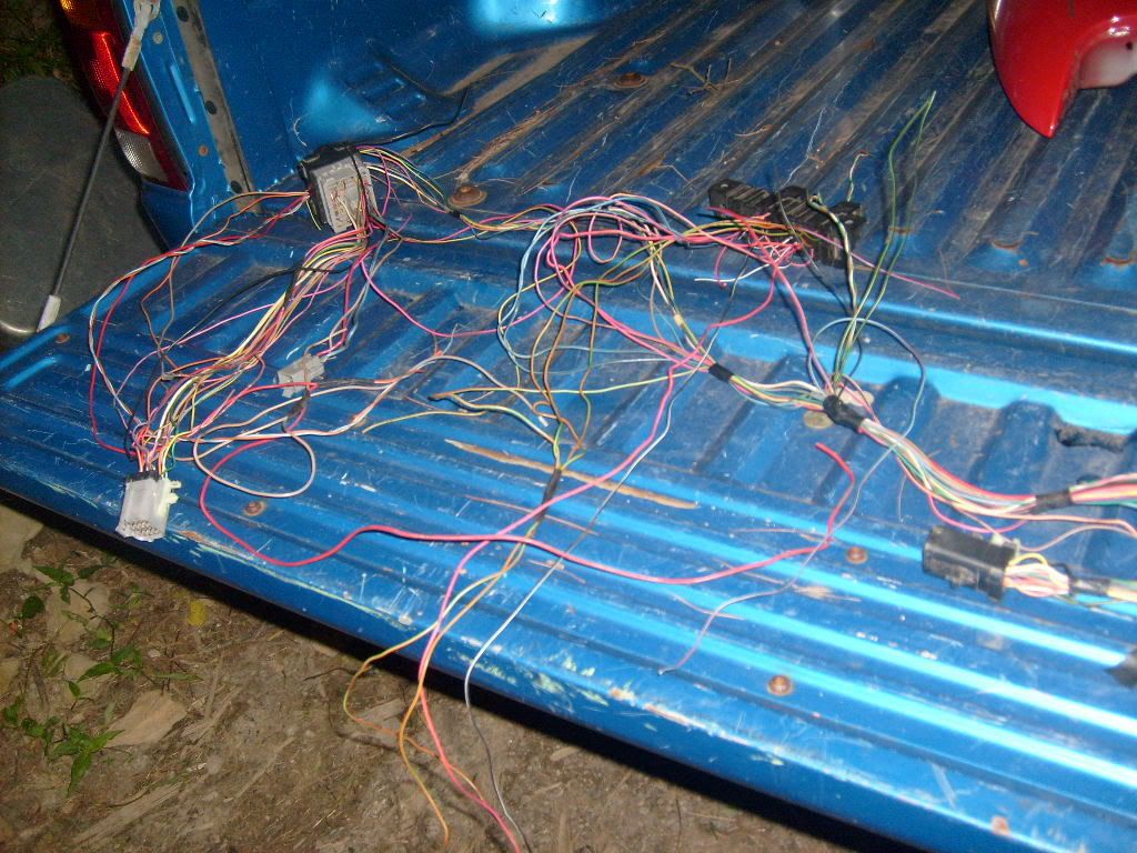

After dismantling the donor harness here is what is required for the power doors.

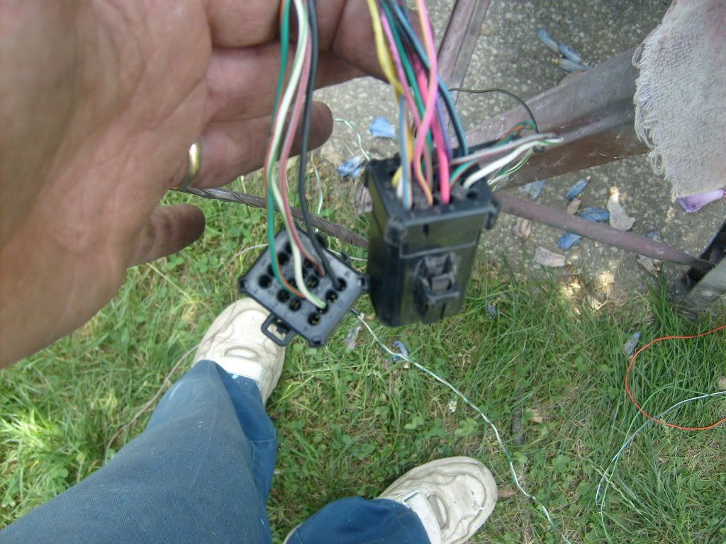

Here's the difference between a power door plug and a manual door plug. Note the wires on the power door plug donor I have folded over, these are already existing in your truck.

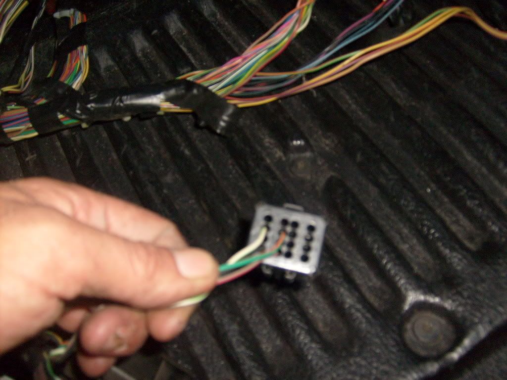

The first step is to remove the wires one by one from the donor harness plug and istall them in the corect position in your factory harness plug. If you look at the picture above you will see a red piece of plastic inside the plug, this has to be removed and then use a tiny screwdriver or scribe to push the tab back and remove the wire. This is what a removed wire looks like.
