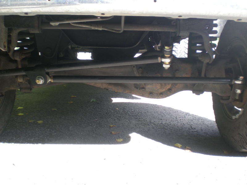

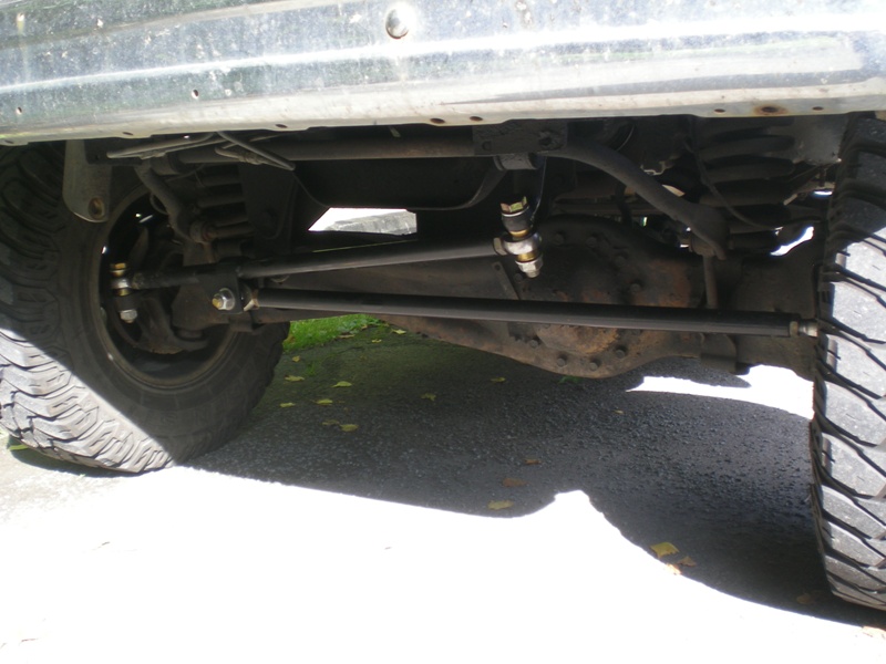

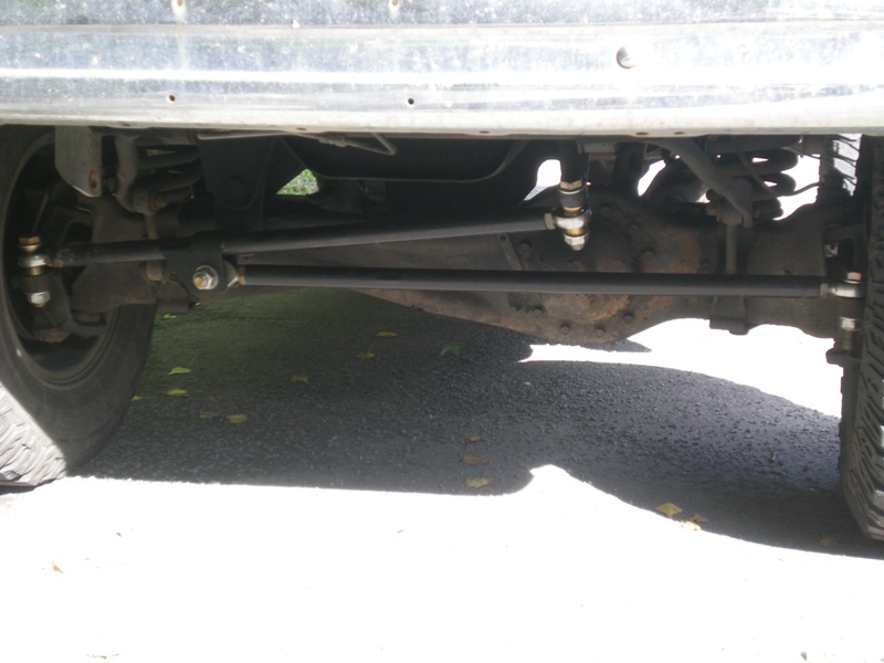

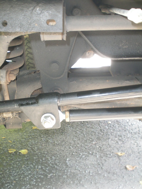

Here is mine
Stone crusher steering system
That's all there is to the infamous "stonecrusher" steering? I'm surprised no one else makes anything like this. Two lengths of heavy wall tube, four rod ends and some misc hardware and you're in business.
