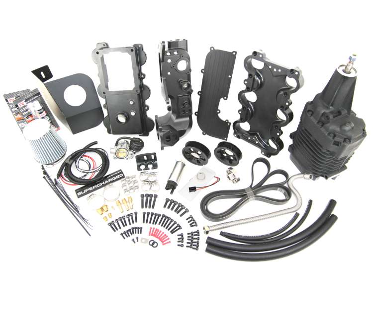

Here is a write up at fourwheeler.com that touches on supercharging a 4.0. It's what I have loosely based my build off of. The price of the SC kit is pretty high, but it seems pretty inclusive. It covers the injectors, root charger and plugs, plus all the mod stuff.
Hell, it looks like something even *I* could install over a weekend. Anyway, HEREhttp://www.fourwheeler.com/projectb...rd_ranger_fx4_supercharger_install/index.html is the link.
I have heard that BamaChips no longer supports this install (I could be wrong, just heard), but there are a few programmers that can send you a canned tune for a small fee.

I have an older BBK kit with the Eaton/Magnuson M62. Ill get some higher resolution pics before it goes on, and during the build.
Needing 4.0 Supercharger Info
It came with a FMU (secondary fuel reg basically) and the BBK ignition control, but that stuff is outdated and not going to ne used.
I plan on going with an SCT tuner and tuning by Henson Racing. With EGR delete, Aeromotive pressure reg, and 30 lb injectors.
Im finding that there is very little info out there on the BBK kit. I have even talked with BBK directly ans was told that since it was discontinued over15yrs ago they have nothing on it and provide no tech support or specifications for it.
