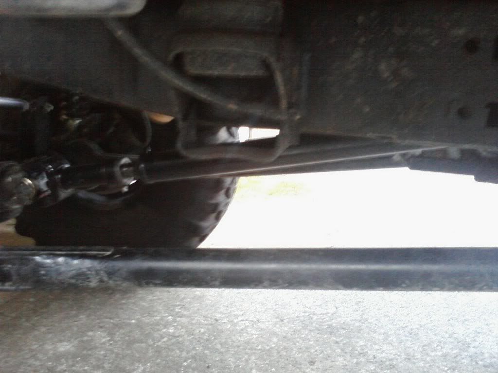

I really hope you beef up those radius arms a bit, they don't look like they will hold up
HA HA HA yeah man they are just laying in each other in that pic right now so they are welded now! ill get more pics soon it also has 5 inches of the DOM sleeved onto the arms and its pretty dam strong i think we will plate it on Monday.:icon_welder:
