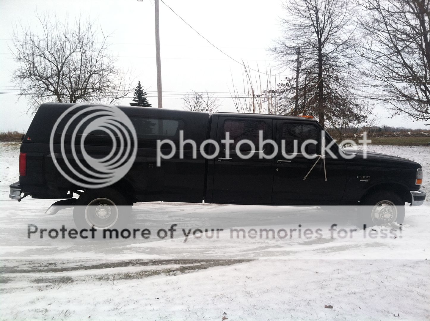

We had our first child on July 4th 2012. He has changed my life and its been very awesome! Just before he was born, I decided to sell my ECLB 2003 F250 with the 7.3L diesel mated to a ZF6 for a truck with a bigger cab.
I am a sucker for the 92-97 full size body style. I just love those things. So I began to hunt for a clean, 1-owner, white, 96-97 crew cab long bed, single wheel, 4x4, XLT, 5-speed F-350 with under 250k miles. I looked for several months. I learned that my definition of clean was different than many other people.
Then i found this. A black, one owner, 138k mile, crew cab dually powerstroke with the 5 speed. The only issue is that it wasnt a 4x4 and was a dually. While I am a fan of duallys, i dont need one. But i bought this one as I couldnt pass it up. I cant change the miles or the fact that I was buying it off the orignal owner.
So I drove 400 miles to pick this up in August 2012. I got a great deal on it.
I tried to live with it only being 2wd, but it just doesnt work with my life style. After getting stuck several times, I decided to do a 4wd swap over this winter. I will be keeping this truck out of the salt.
Ford did not offer a 4x4 crew cab dually in this body style. You could only get 4x4 duallys in regular cab chassis cab configurations. From what i hear, they did sell some CC DRWs in canada which made there way into Montana and such.
During the trip home after we got out of Chicago. I went from a truck with 35s and 3.73 gears to a truck with 30s and 4.10s. She screams down the highway haha.

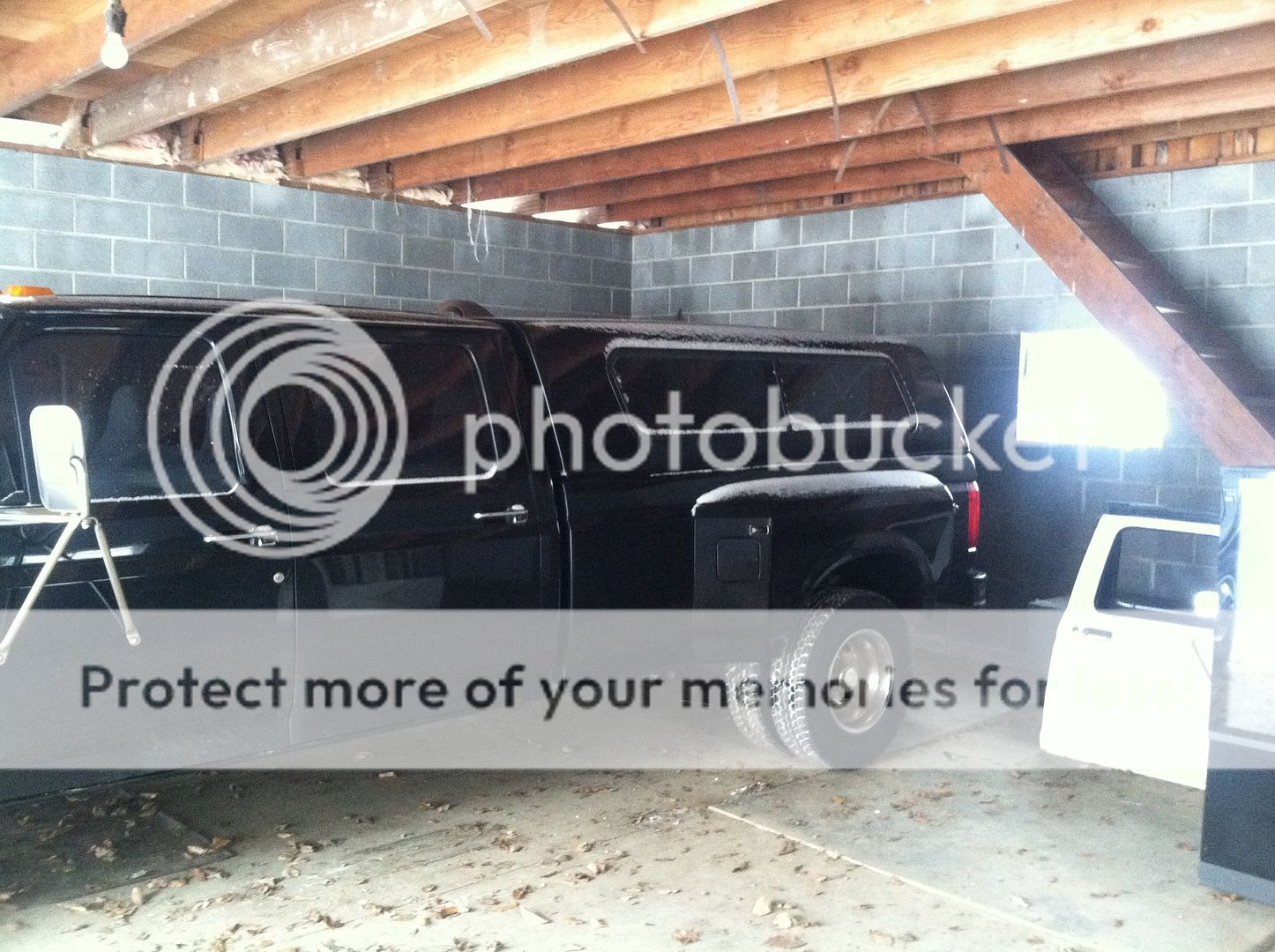

I have been tearing into the truck after my family goes to bed.
After 3 nights, I have removed the doors, front clip, bed and cab. This weekend will be the t-case and trans. I sold the frame to a friend which is why I am stripping it down.

Got the cab out of the garage. Lifted it with ratchet straps hanging from the rafters. Then dropped it on the ranger to store outside until I make a scrap run.

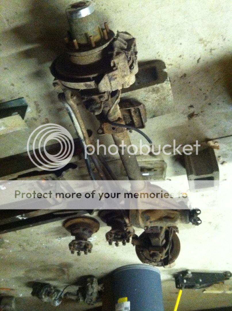

Got the 351W, C6 and front axle out. I ran out of cut off wheels so I will have to pull the rear axle and front springs at a later date. I am trading the track bar and front leaf springs for dually outer hubs. I still want to run a radius arm setup. We will have to see how much I get or owe uncle sam.
