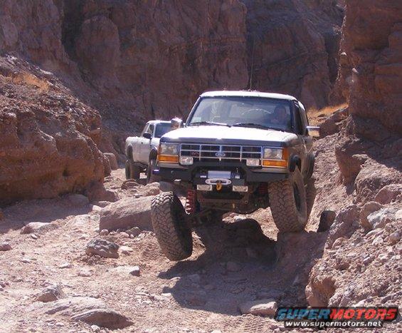

This is with all urethane bushings & extended radius arms:
It's possible there may be some reasons to use rubber (possibly price?), but more flex or articulation is not among them (not if you have extended arms anyway).
