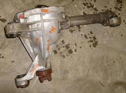

Like it says, has anyone squeezed a fully selectable diff locker (Eaton, OX, ARB) into a D35 SLA, while the front suspension is still stock? What about with a 4" lift?
Stock it is a very tight fit to get a fully rounded diff cover in there, if it is at all possible.
I'm not asking about the lunchbox lockers...just the fully selectable type.
Thanks!

the front diff in 98+ Rangers is NOT a regular Dana 35, it is smaller.
the ring gear has only 8 bolts on a circle less than 6" centerline.
be sure to get 98+ Ranger or 95-01 Explorer parts.

Yeah, isn't the 98+ Ranger/95-01 Explorer a Dana 30, and then the 02-11 Explorers a Super30?
4,667
yes it is....but the setup hampers jeep e locker useage...
it has been done, and is not a reg bolt in part for part.

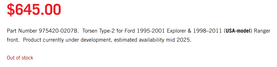

My second choice would be a Torsen, made just for the D35 SLA:
https://torsen.com/product/ford-dana-35/
Chip at OX stated that they've only had 1 other person ever ask about installing their diff locker into a stock suspension Ranger.
