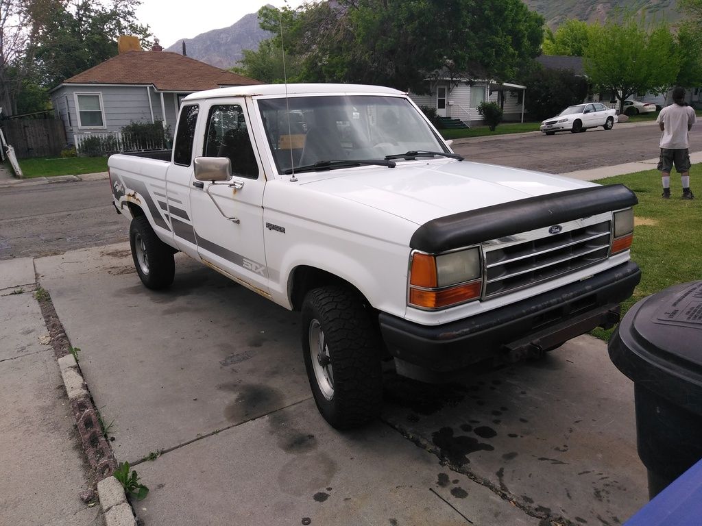

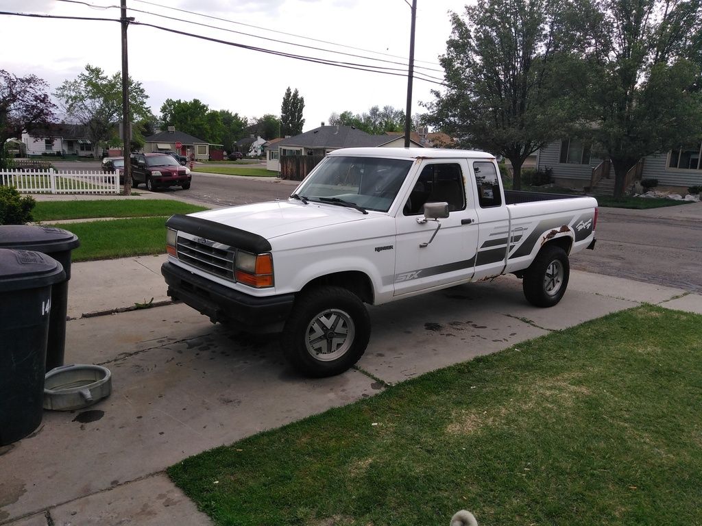

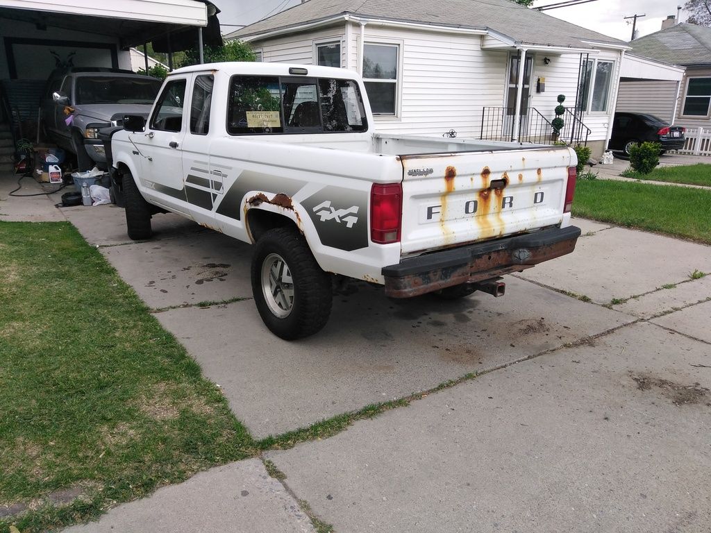

Ok so after a blown engine in a eb explorer, then a blown transmission in a 2nd eb explorer i said screw it and sold my baby a built raptor and immediately bought the perfect truck before anyone else could snag it. A 1993 Ranger supercab with the 4.0 and m50d trans, also has a manual transfer case with of course manual hubs. To say I'm excited is an extreme understatement I've wanted 1 of these even back in highschool when i had a B2.
It already has a 2.5 inch cat back exhaust with flowmaster muffler, a K&N filter, 2 inch lift, and they swapped in a 8.8 out if an explorer that has the lsd and 31 spline axles.
So I'm going to add in lockers both front and rear and up it to a 4 inch lift.

looks pretty clean! i wish i still had my 1991, love that body style.
im not sure if you are going selectable for the rear locker or not, but the lunchbox for the limited slip diff is pretty expensive, i would recommend super packing that limited slip. all the traction of the locker without the noise or expense. i talk about it a bit on page 2 of my build. link is below.

Good looking truck--too bad about the rust, but it's fixable.

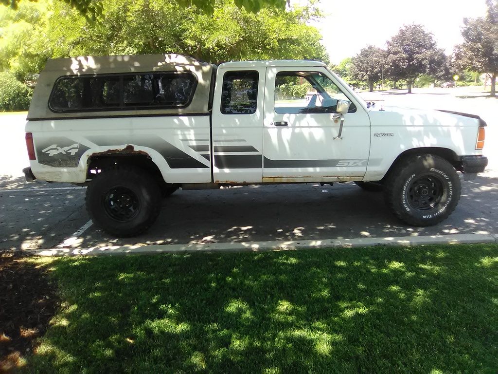

I'll end up with a selectable or at least i want too, will have to wait and see how busy we are this summer. I thinj the previous owner did pack it up to much, i know he said he made sure to shim it or something, but tight turns and wheels are spinning.

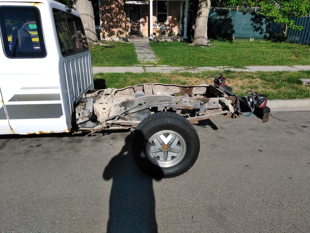

Anyways had it packed up and everything to head off to Houston, filled my gas tank as full as it would go went back to my dads to grab my phone charger then leave and the fuel pump completely stops working

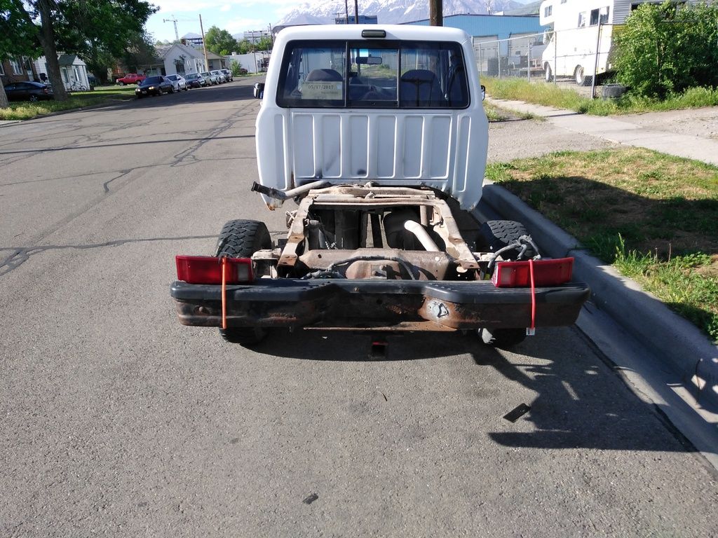

I ended up using the steamer on the frame and everything. Wanted to wire brush it and paint it but time and money said wait till this fall.

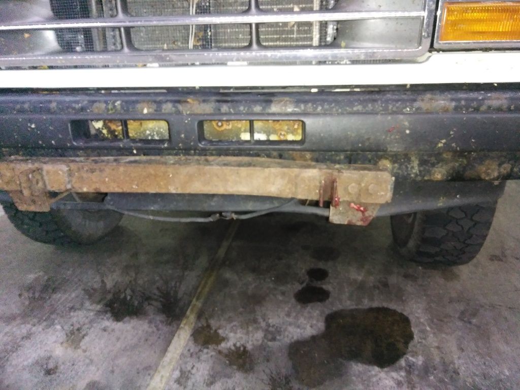

Got it all back together took off and somewhere middle of Texas at about 5 in the morning i had a pack of wild boar run across the freeway, hit a medium sized between 55-60 mph and damn was that an impact. If it hadn't been for the push bar she would've been totalled

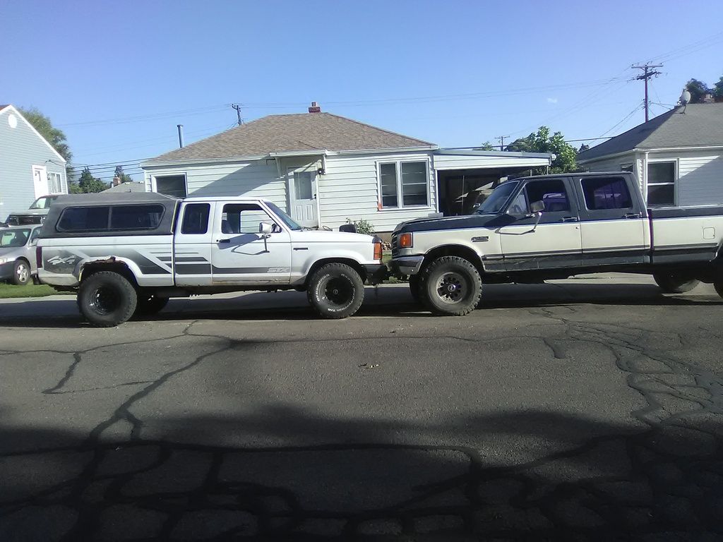

I had a bunch of ttansmission work and in pretty sure the shop didnt actually do anything. That said I ended up limping back to Utah and bought another truck a 88 f350 crew cab.
However its not a daily truck so I'm fixing the Ranger.

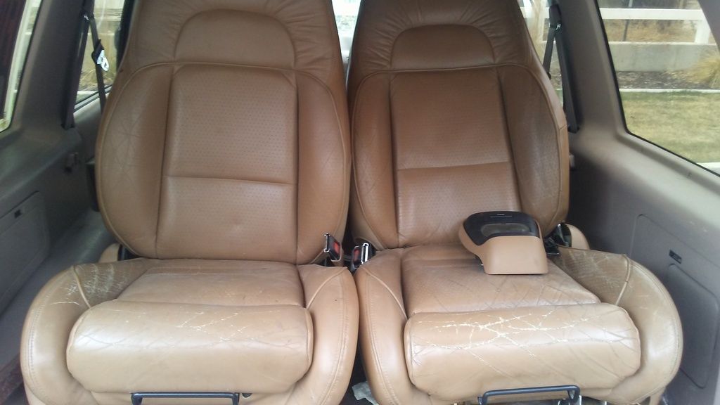

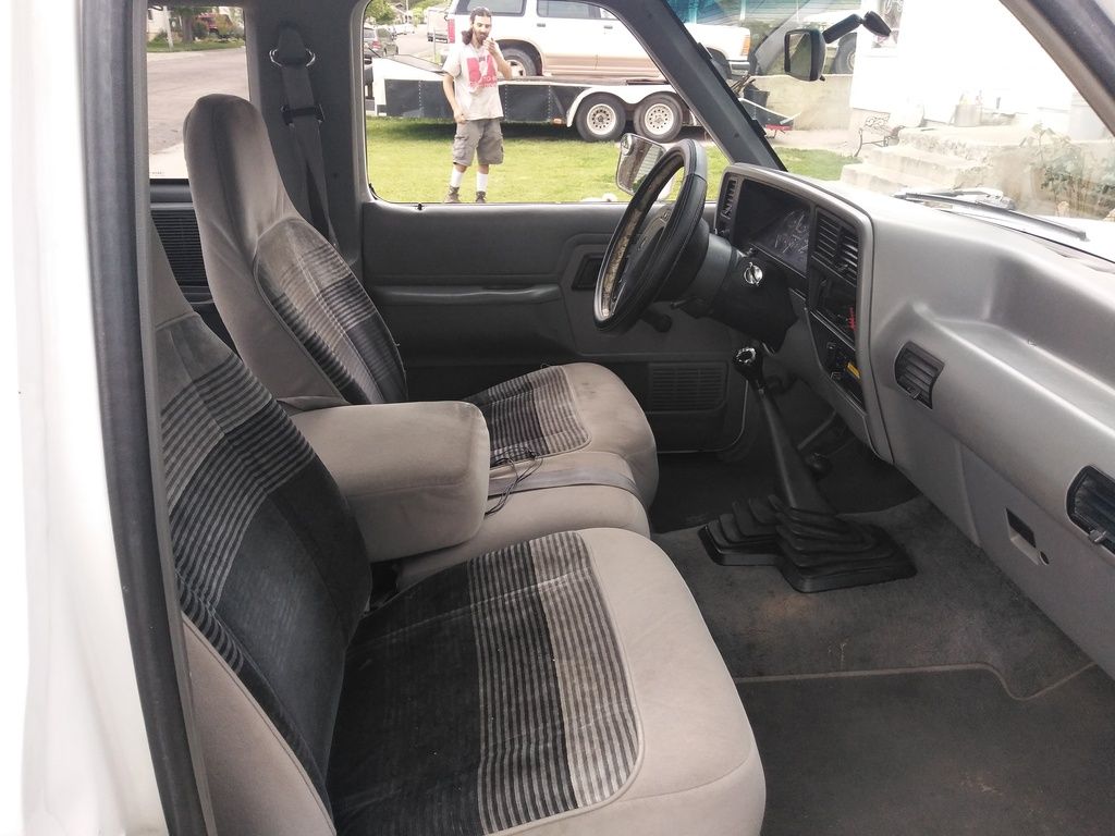

First I scored some nice leather seats onnhalf off day using plasma money

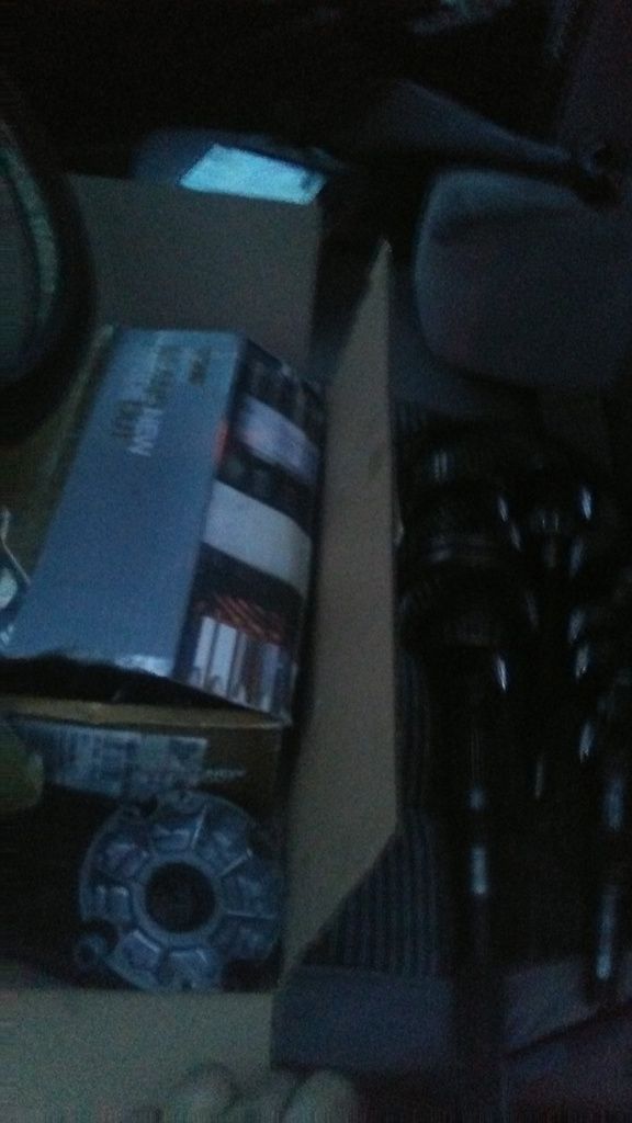

Hopefully those will be in by end of weekend. But first and more importantly I'm going to finish pulling the transmission and ripping out the damaged guts and installing these
I know bad picture it was getting late out. Anyways picked up all the intrnals for a rebuild from BlackB2. Turns out we weny to school together nack in the day, was nice catching back up.

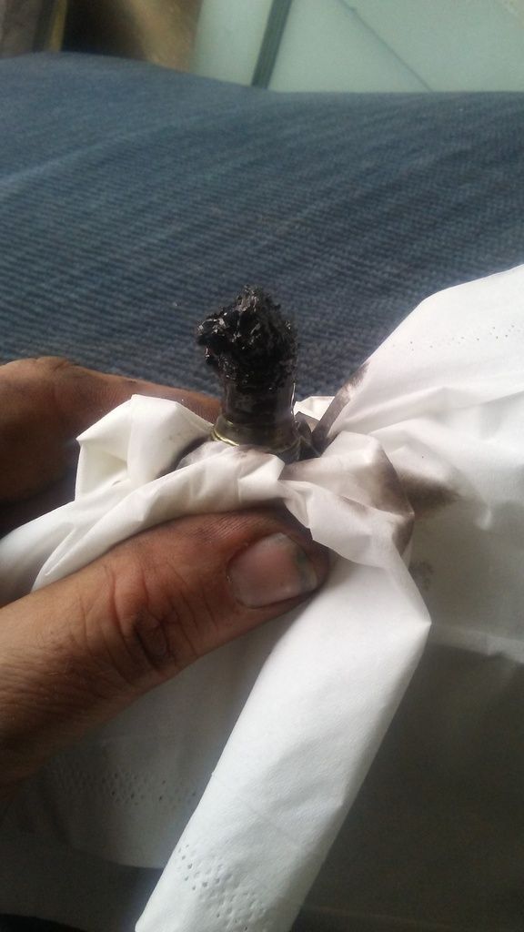

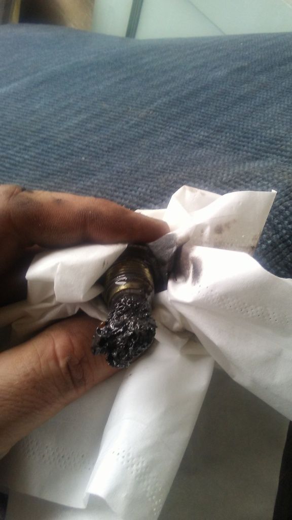

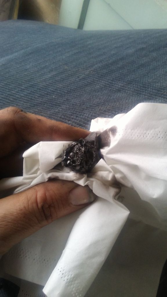

Anyways I have mostly everything unbolted and ready to go. We'll finish tomorrow when there's light outside. However i did drain the fluid and upon pulling the drain plug I found this
Smelled massively of gear lube and had a few metal chunks in it :/
Also I'm pretty sure there should be more fluid then this:
There was maybe 1/2 to 2/3 a quart of fluid in it and it smelled massively of gear lube too even though it was red

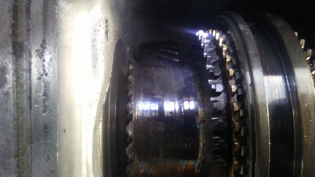

Well I think I found the problem. Probably gonna spend the next week fixing it
It dropped some more fluid that definetly didnt look or smell like atf

Yikes.
If the shop that did the work used a heavy weight oil like gear lube I would call them and let them have it.

Well transmission is back together.
I finished buttoning it up today as I had to wait innthe clutch to arrive. The pressure plate and flywheel were still good but the previous clutch was completely fried, even brittle to the touch and somewhat glazy lol.

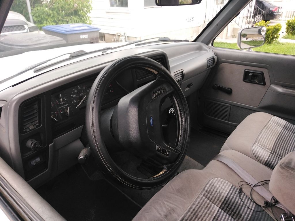

Anyways while waiting on the clutch I seized the opportunity to install my new seats.
I'm very happy with them absolutely love em if I'm honest. The center console isnt in yet I was just lining it up to see hiwnit fits when Napa called with the new clutch.
