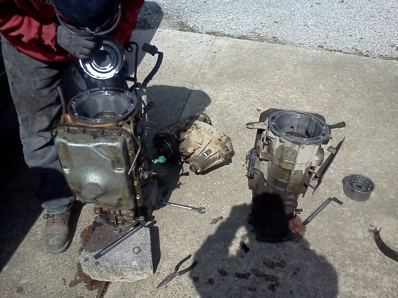

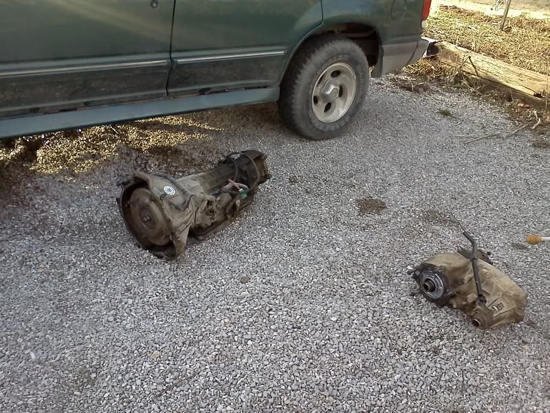

Just bought on February 23, 2012. It was stuck in 4-low, so we swapped and installed a manual transfer case. It was starting and ran in first gear, but we reused original hardware on the filter by accident. So we dropped the transmission pan again (hoping the only issues was air). Now it doesn't want to shift at all. It starts fine but struggles to drive and gets up to 3000-4000 RPM, then I have to let off the gas for it to wined down.
Second day of having it home and in total we changed- air filter, transfer case, transmission fluid & filter, wiper blades, spark plugs, oil change & filter.

Ok so I replaced the solenoid that threw the code and it still wouldn't shift. Next thing to check was the intermediate band. Tried the adjustment screw, and sure enough it went all the way in. Weird I didn't see anything in the pan.

Picking up a 5r55e from a buddy from work. Was rebuilt recently, but he started having shifting issues and trouble getting it to downshift when coming to a stop. From the research I've done on this it sounds like a solenoid or the valve body gasket. I'm going to check the bands and swap all the electronics from Katie's tranny to the new one. Hope it works out.
