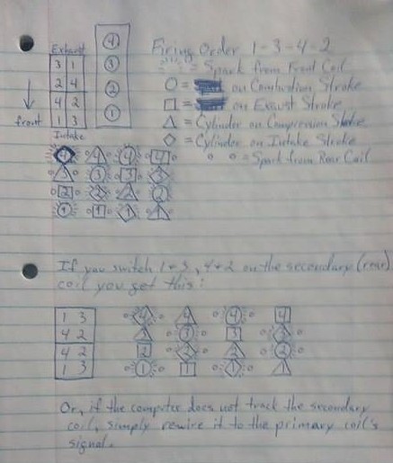

Step 1: open your hood and locate your coil packs (you'll only be working with the FRONT pack)
Step 2: label your wires so you know which ones they are
here's a little diagram just in case
4 2
1 3
Step 3: remove all 4 wires and re-install them in this order...
1 3
4 2
Step 4: enjoy (so simple its mind blowing)
you just modded your truck
this mod turns the exhaust spark into an ignition spark
so you now have 2 plugs firing on the ignition stroke instead of just 1.
this burns the fuel more efficiently and in turn gives you better MPGs and more power.

Here the problem with your theory.
That is a 2 channel coil (wasted spark system). It fires #1 + #4 and #2 + #3 at the same time as pairs. That means when the #1 cyl is being fired on its exhaust stroke, #4 is being fired on its compression stroke. (ignoring the other coil, for now.) Switching 1 + 4 does nothing, except move which terminal, on the same channel of the coil, the wire attaches to.
With this 2 coil system, wasted spark system, you always have both plugs firing on both the comp and exh stroke. One is being fired on the main coil (on purpose), the other is being fired on the secondary coil (as wasted spark).

If both spark plugs were to fire at the exact same time in two different locations would that not cause two flame fronts to collide creating abnormally high cylinder pressure? When carbon or high compression ignite the fuel mixture in a second location the two flame fronts traveling toward each other and the rapidly expanding gasses cause extreme but short cylinder pressure. So.... two plugs firing at the same time would cause the engine to detonate or ping. I have not messed with a 2.3L dual plug head, but I would have to assume the second set of plugs fires after the main burn in hopes of igniting any unburned combustables for emissions?
