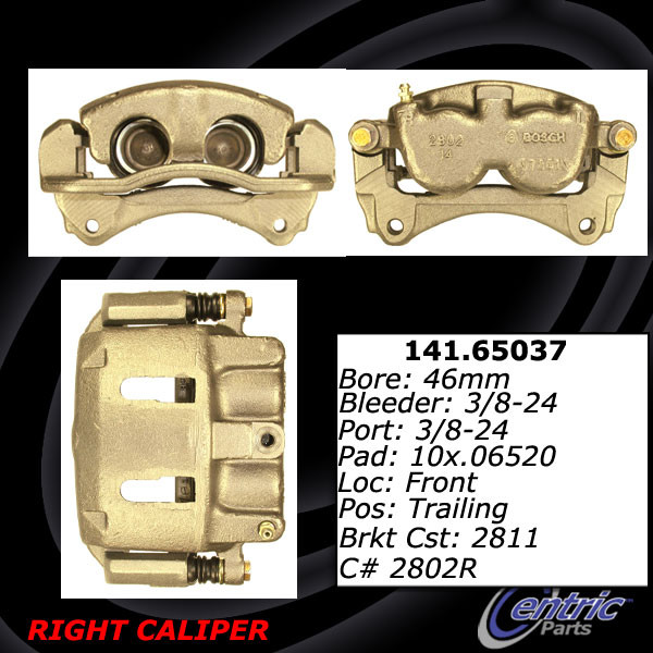

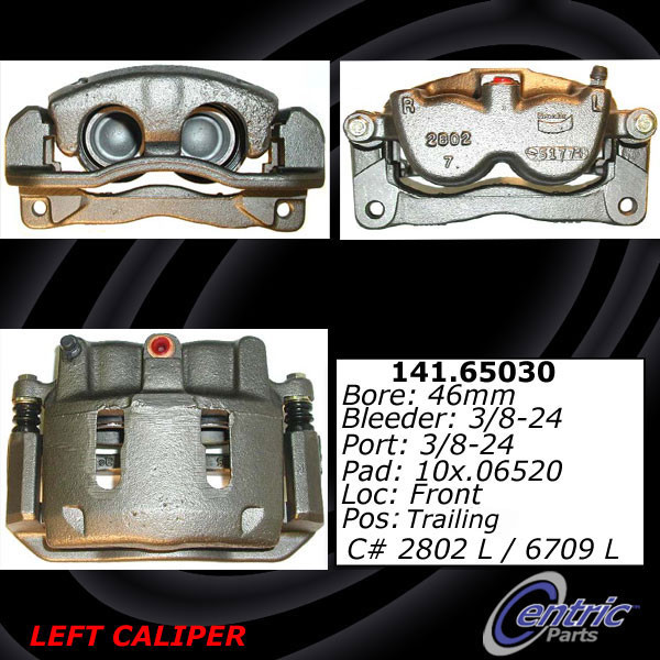

I've wanted to do this as well, I own a 98 XLT Splash, it has lite duty suspension,
talking strictly 2wd front coils... what differences are there in the the knuckles used on the smaller 10 1/4 (260mm) rotor setups vs the larger 11 1/4" (285mm) rotor set ups?
Rockauto lists both a 10 1/4" & 11 1/4" rotor for both '95 thru to 2011 that are used on either the Mazda/Explorer/Ranger.
To the best of my knowledge the calipers are the same, I'm aware that the brackets used with each of those setups are not the same so the knuckles for each setup are different castings?

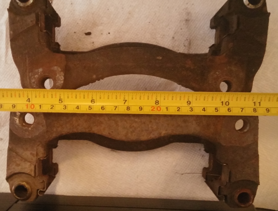

I can tell you will 100% certainty, that the 4x4 knuckles are different between those with the 285mm (11 1/4") and those with 305mm rotors (12"). The part numbers for both calipers are the same; Superlift provides 2 set of holes in their lift knuckles for you to choose which rotors you have.
For coil spring Rangers; I am not so certain. Based on the attached pictures, I would swear the bracket for the 260mm rotors is 7.5mm shorter than those for 285mm. Let me go check something...

while in Rockauto I too was looking at the pics they supply for the various brake arrangements...two supplied photos for either the 2001 & 2008 (samples) years, both 2wd, the older year is for 10 1/4" ...the later 2008 is for 11 1/4" rotor. Both are designated as 2wd suspensions. The 1st pic is the later truck, 2nd pic the older truck
I'm assuming that there are two different knuckle castings for the 2wd trucks seeing as the bracket castings are different (mounting hole center to center are not the same).

Late braking (intentional pun).
Knuckles are indeed different - I had a 260mm rotor knuckle in garage...
As seen in the attached, the mounting holes for the 260mm rotor are 173mm apart, while those of 285mm rotor are about 144mm apart. (and that might actually help me with my adapter for Crown Vic rotors).
