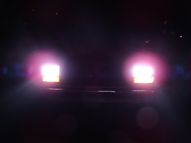

At the start of the night, my headlights looked like this:
Just standard 9004 Sylvania bulbs in old, faded, water filled headlight housings.

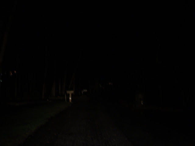

Now before I show you this beam shot, let me warn you that there was much more light in real life than the camera actually showed. It was difficult to get the camera to pick up the beams properly, so very little light is shown. The camera was on the same setting in both the before and after beam shot though, so it will still give you an idea of how much improved the headlights were afterwards.
Beam shot before:
Terrible isn't it. Thats my neighbors mailbox just barely showing up in the picture.

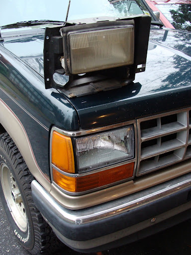

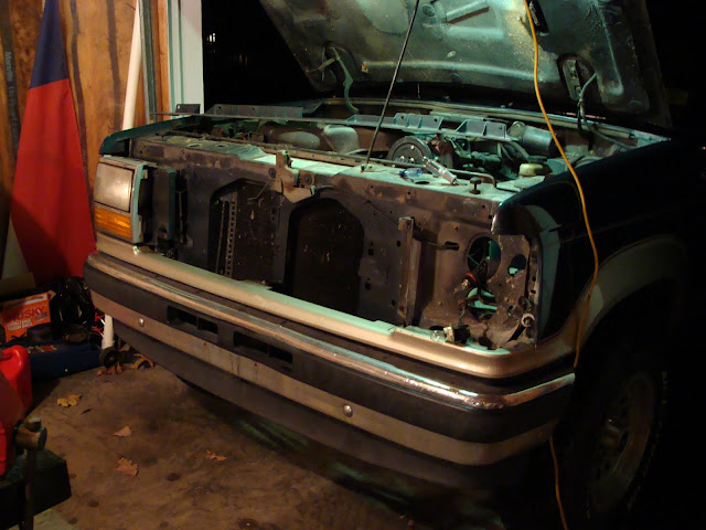

So I started tearing apart the front end on my car:

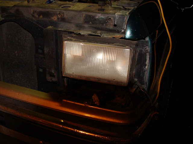

Close up of the old headlight. You can see water inside it:

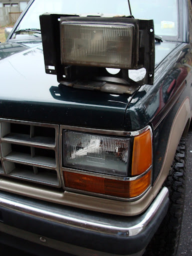

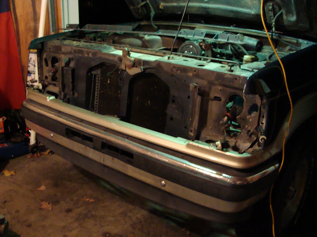

One side out:

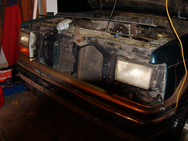

Both sides out:

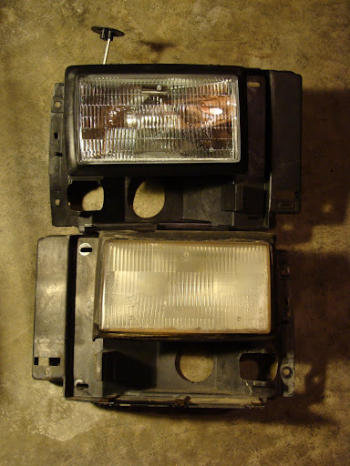

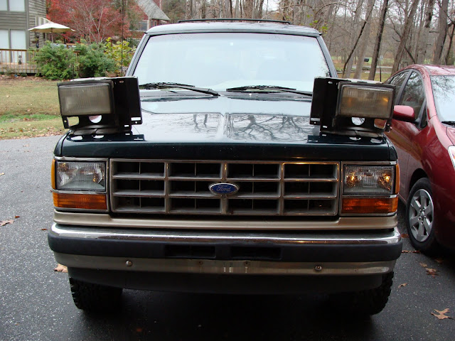

The old with the new. Fancy guessing which are the new ones? :D

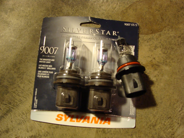

My new 9007 Silverstar headlight bulbs still in the package, alongside a standard 9004 Sylvania headlight bulb.

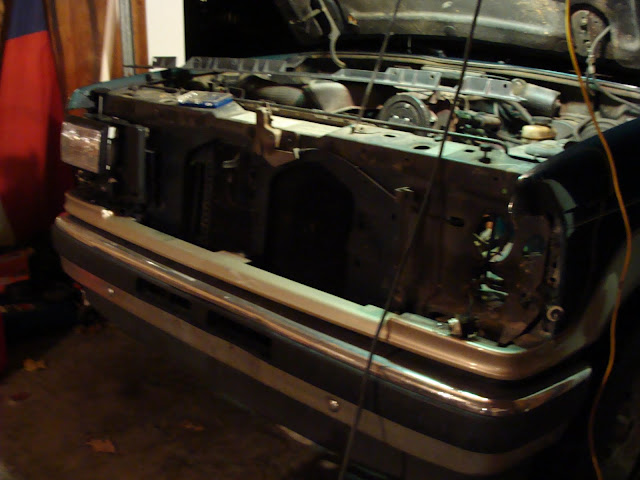

One new headlight in:

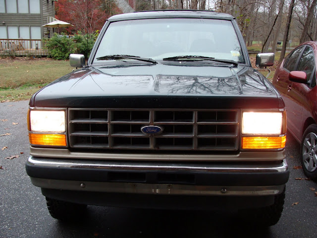

And finally, both installed, both sides re-wired (I simply re-pinned the plug) and my new Sylvania Siver Star headlight bulbs installed!
In the picture, its a somewhat purpleish light, however in real life, its just a very white, very bright looking light. There's really no purple look to it at all, and you do not get any of the terrible HID glare that you would get from putting HID bulbs in a non HID housing.

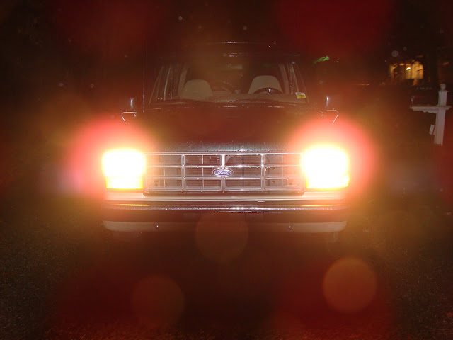

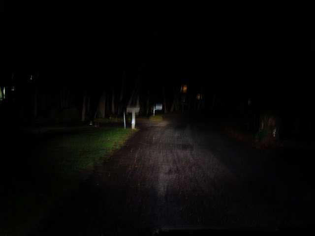

And finally; a Beam shot after:
This was before I aimed my headlights, they were pointing low in the picture, even with the high beams on. Bear in mind again, there is a LOT more light in real life than what shows up in the picture. The road in front of my truck was now flooded with light! But between the before and after picture, with the same camera on the same setting, you ought to be able to get a sense of the improvement I saw!
Not only were my headlights now much brighter, but the Silverstars help to illuminate the sides of the road a lot better. You can see much further into the distance, and much more off to the side than you could before. The whiter light also brings out the detail in things much better.

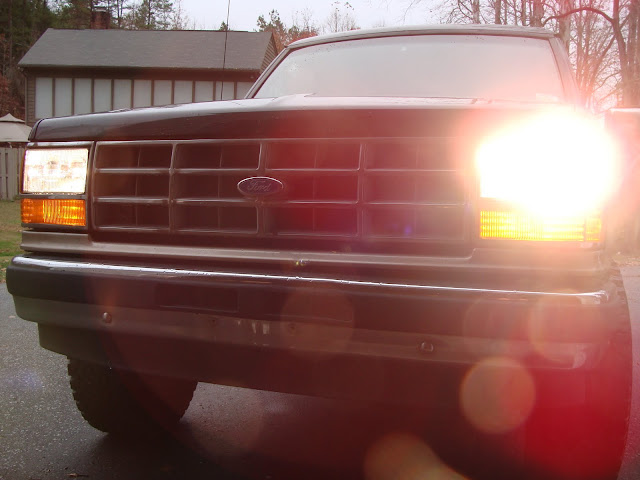

I took a few more pictures today, and figured I'd post them up here for your viewing pleasure! :D
New headlights installed with the old ones sitting above.
From an angle...
Left Side
Right Side
Lights on.
And again with some glare! :)
