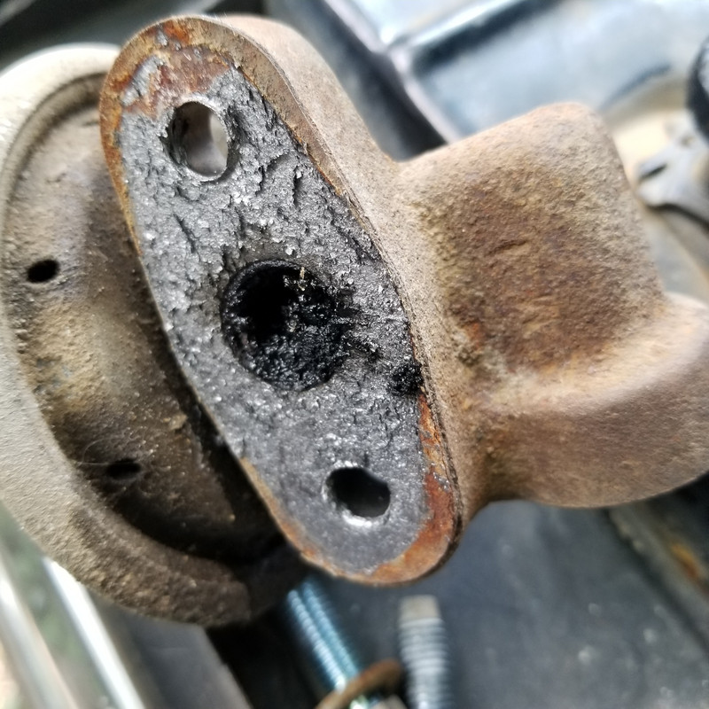

Yes. That is the plenium and valve. Totally carbon packed. Cleaned it all up, fixed the broken pipe with a galvenized coupler, and guess what? No more EGR codes ....
But still down on power...
