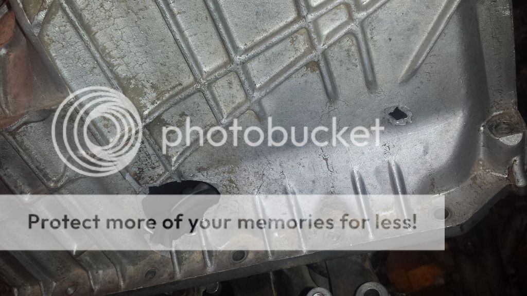

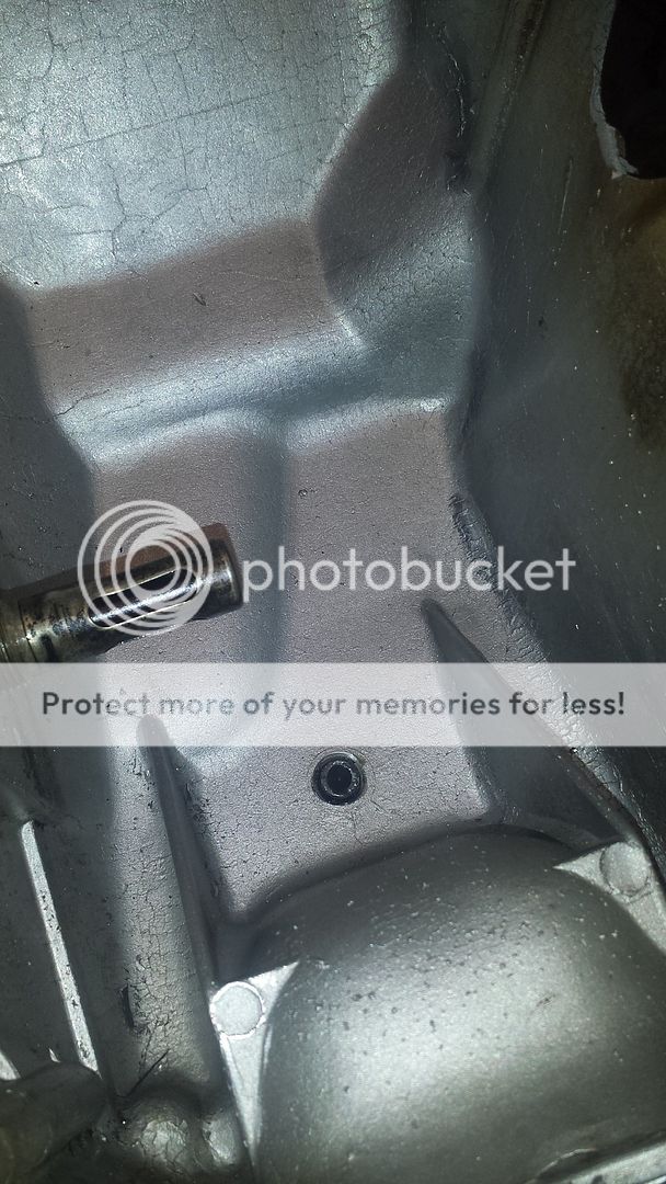

Yeah, it happened, #4 rod let go I believe as there's a hole in the block behind the starter... Don't know what happened, probably lost a rod bolt since I cheaped out and didn't get ARP or anything...

I'm sure you're curious on what happened... took a drive on Saturday to the beach with my 3 wheeler in the bed of the ol Ranger to drive in the sand at Sand Lake, the sand wasn't pleasant with the trike in the bed so I parked the truck and took the 3 wheeler out... had fun for a while then headed home. My drive was over 150 miles long, the engine decided to go within 1/2 mile from my moms house while I was crossing an intersection, heard a ticking and lost all oil pressure so I coasted to a stop in a good spot and found a bunch of oil leaking. Towed it to my moms house on Saturday, then to my house on Sunday, while attempting to drive it on the trailer it locked up and a piece of engine block fell off so I found out the bad news, I thought I had just lost oil pressure somehow and it wouldn't be a big deal...
