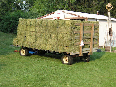

Is this like the wagons you are using?
There shouldn't be much if any of the load transferred to the tounge. That's the purpose of the spread axles like that.

He said It was a 16 ft tandem axle I believe and that puts alot of weight directly on the hitch, Now if you made the frame out of 2x6 solid stock I dont think you would have an issue anymore LOL
Who puts hay on a tandem axle car-style trailer? :icon_confused: He called it a wagon, and every hay wagon I've seen around here (remember, we have a few farms here in IL) has been the dual spread axle wagons.
I think Will might be right, bouncing around through fields is more than likely the root cause of the problem. If you insist on using a 1/4T truck for this job, I'd be tempted to back-half it with some rectangular tubing. While I was back there, I'd fashion a DMI-style spring hitch under there too. Forget the rigid hitches, they're not meant for this application.
