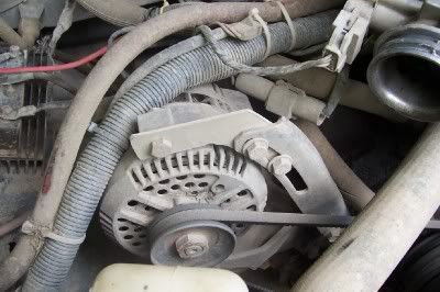

ill take a picture of one of mine for you later so you can see.

here is the alternator
this is what you do with the wire.
vwa-la, you have power.
Hope this helps you!
