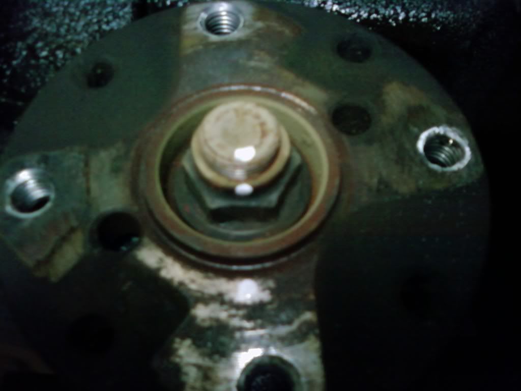

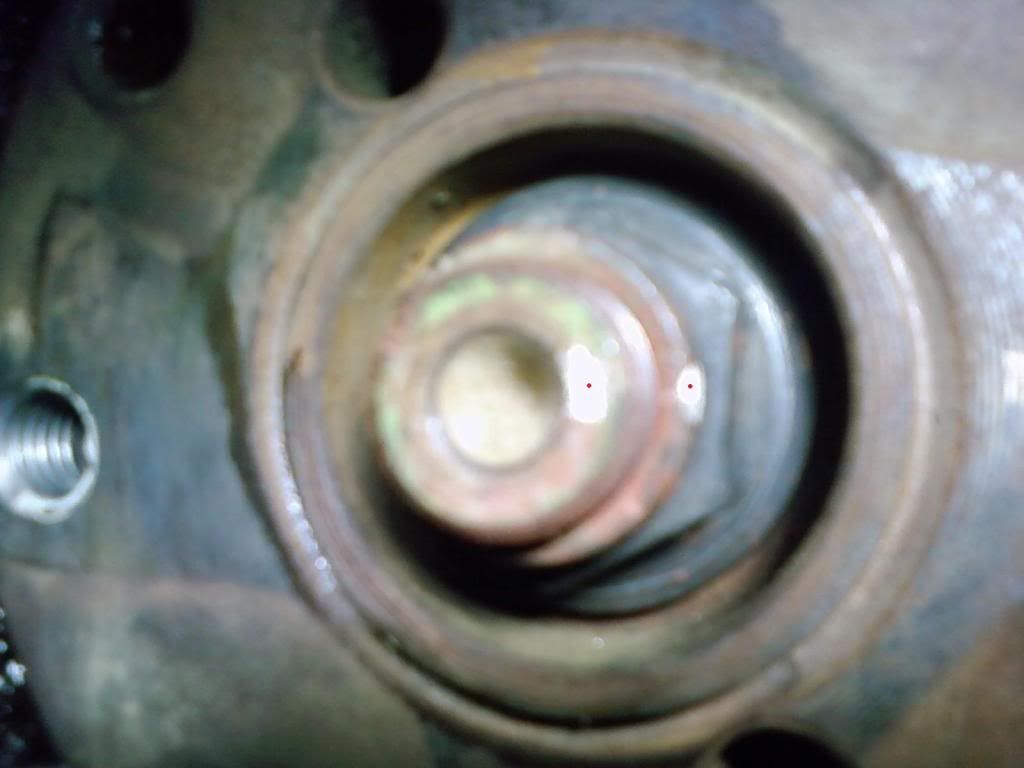

Step 2: Mark the pinion shaft, nut, and flange in relation to each other to reinstall in the same position. Then remove the pinion nut

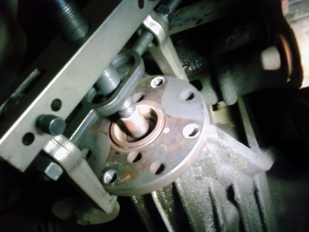

Step 3: Use the puller to remove the flange from the pinion shaft, its very important to have a tapered end when pushing on the pinion shaft or the threads will be mushroomed.

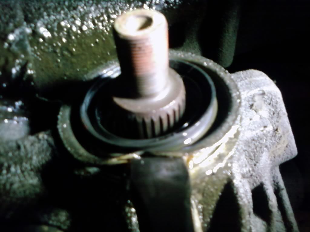

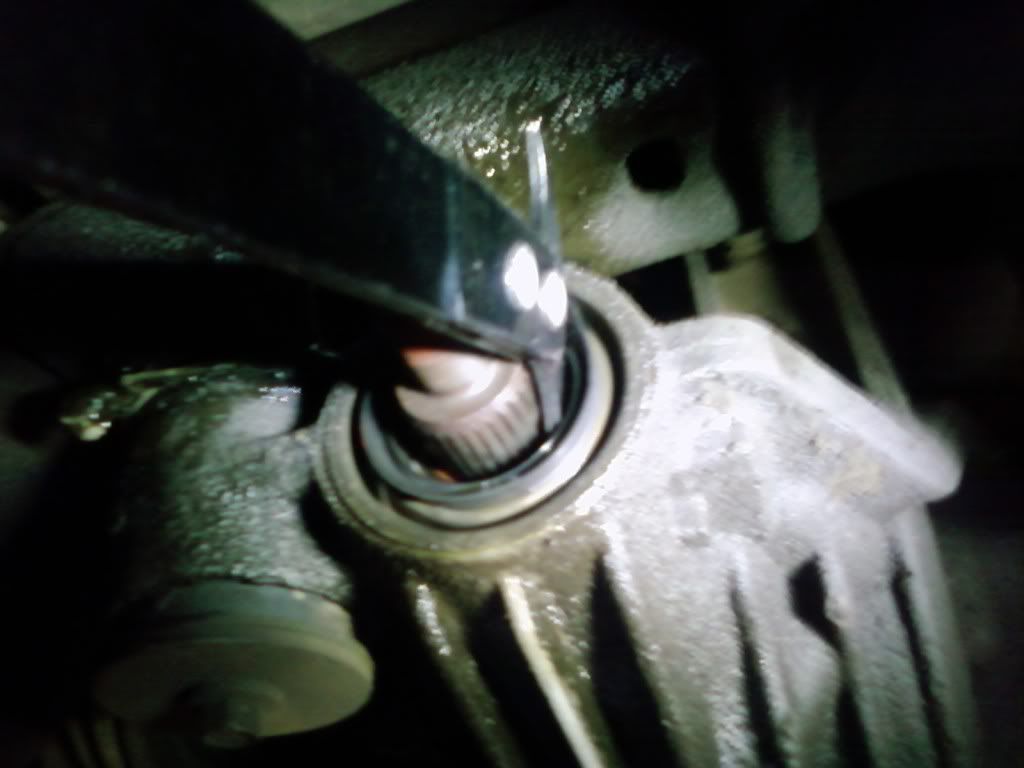

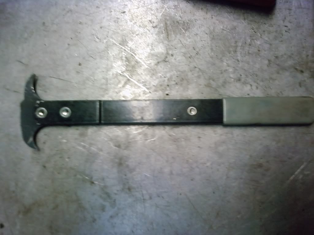

Step 4: Set the flange aside and gently use the seal puller to remove the pinion seal. Its a good idea to have a pan underneath to catch any oil that spills out
Step 4.5: Seal puller not working? Thats ok, you can use a chisel and hammer to collapse the seal inward. Catch the outer edge of the seal with the chisel and work your way around the seal until the seal puller can remove the seal or it simply falls out. Try your best not to damage the housing doing this.

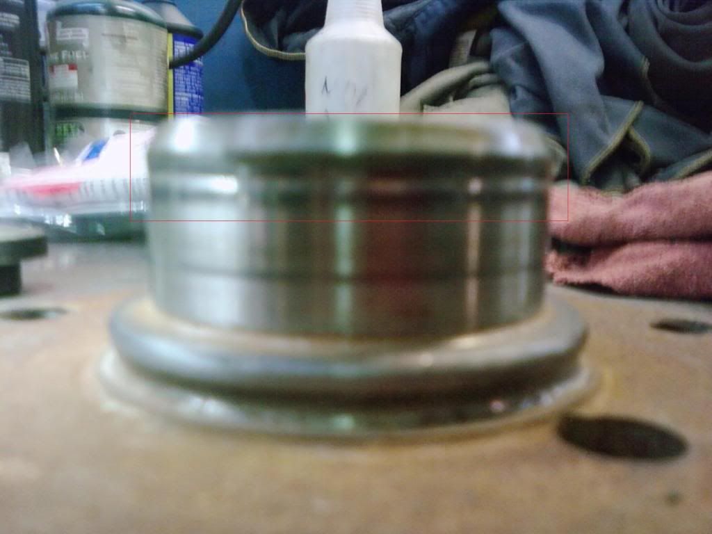

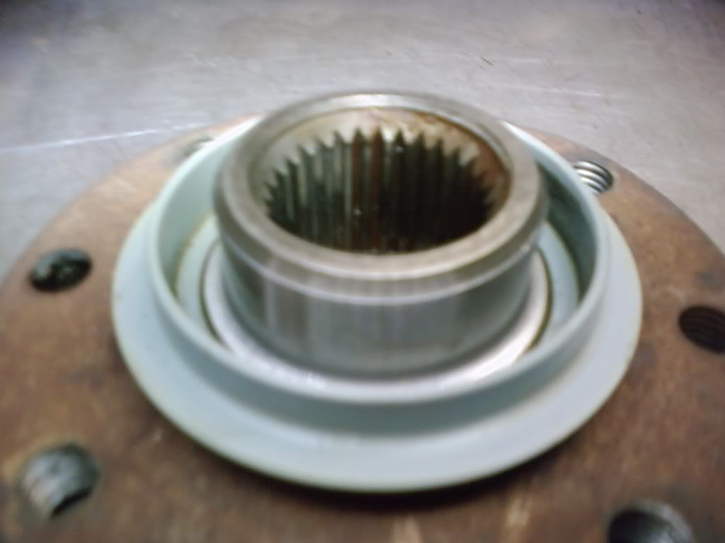

Step 6: You're not done yet, you need to inspect the pinion flange. Wipe the flange clean and visually take a look at the sealing surface to check for a groove, if you see a deep grove gently pry off the dust seal and set it aside to be reused
If the sealing surface is ok skip to Step 8

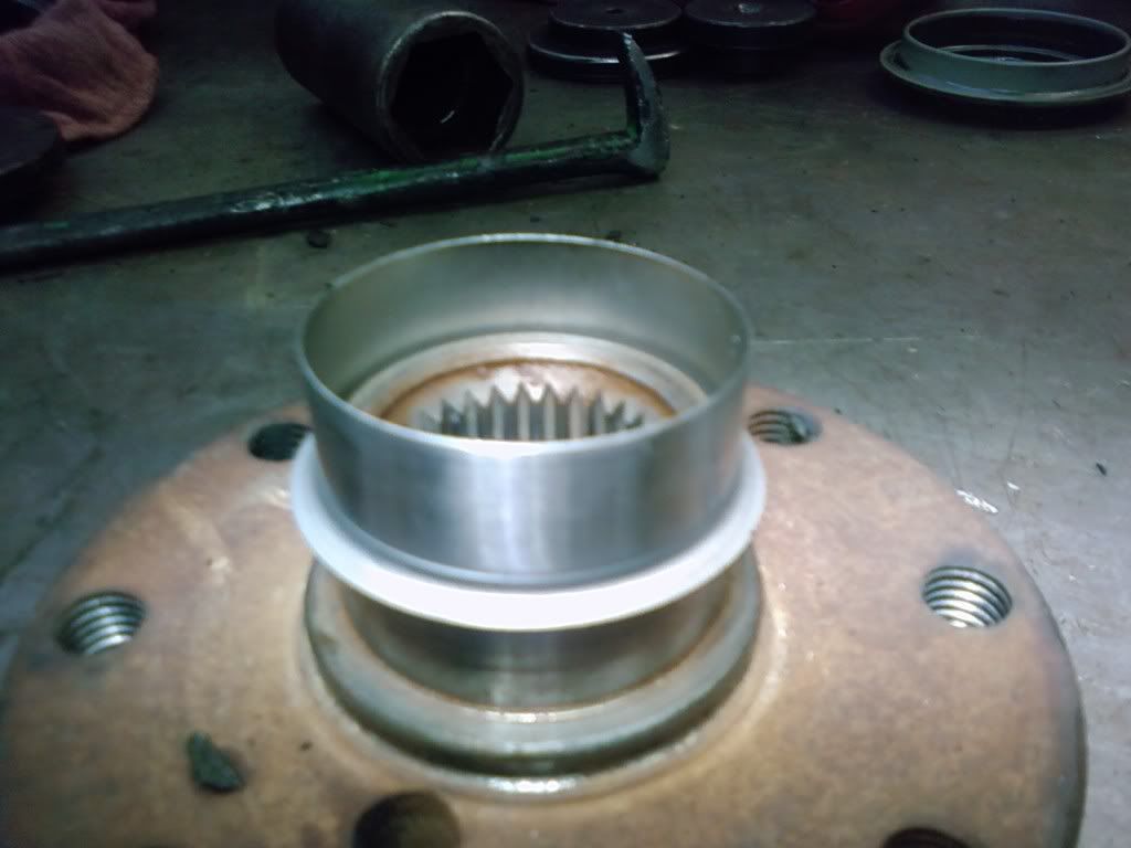

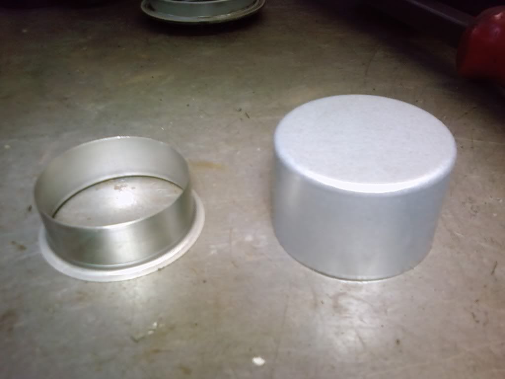

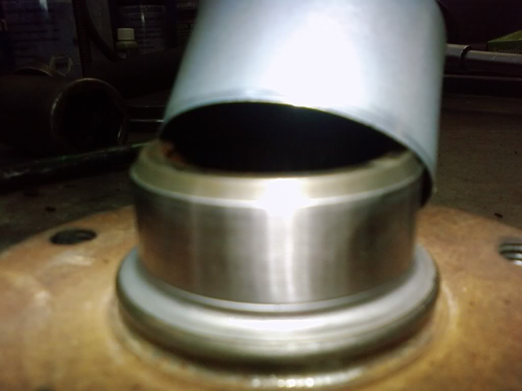

Step 7: I had a deep groove in the sealing surface so I used the speedy sleeve to fix it. Speedy sleeves come with their own driver and are installed in a similar manner to installing seals.
After you install the speedy sleeve re-install the dust seal, you can tap this back on
Step 8: Time to reinstall the pinion flange, again do not forget to put the dust seal back on if you removed it. Line up the marks you made earlier and slip the flange onto the splines, install the nut and GENTLY tighten until the flange bottoms out(if using an impact gun, tighten only until the flange bottoms out and then stop)
After the flange bottoms out check the position of the nut, tighten the nut until the orignal marks line up. Now tighten the nut no more than 1/8th turn further
