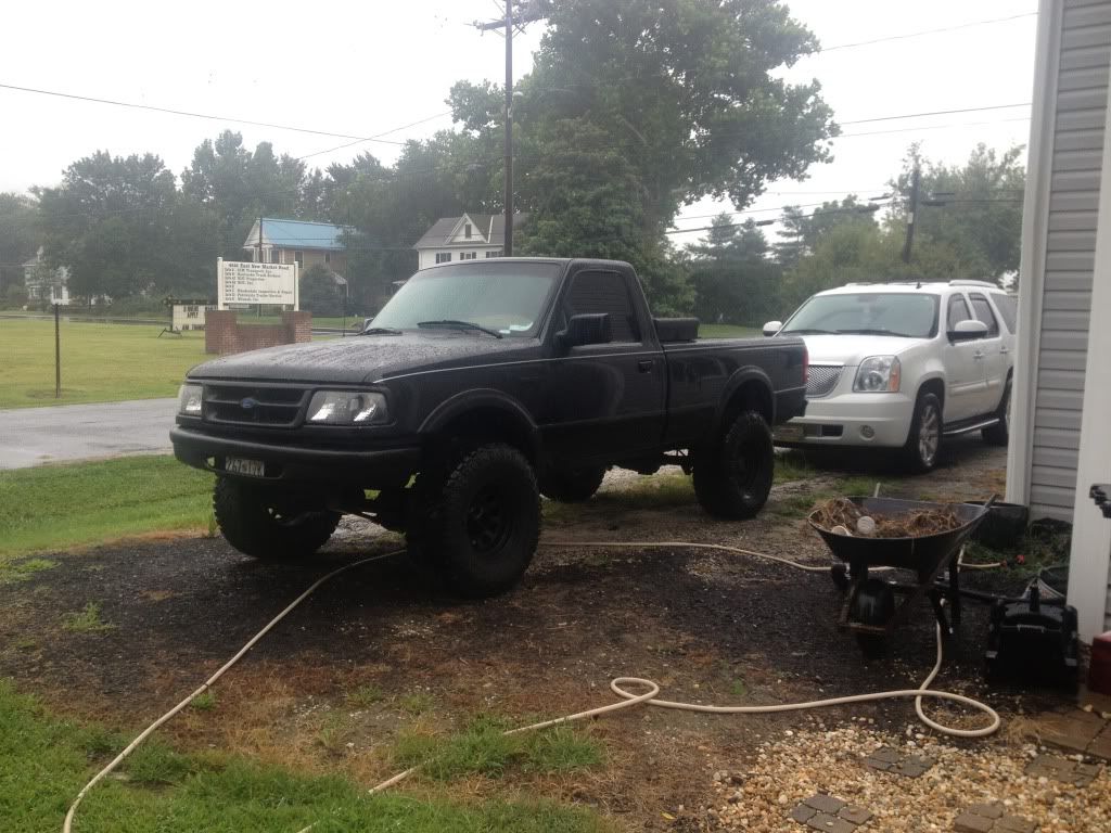

Here's how mine sits with 33s

Ranger is on 35's and even with my runner that is stock
Flex
Ride height with spring over axle(to tall for my liking)
