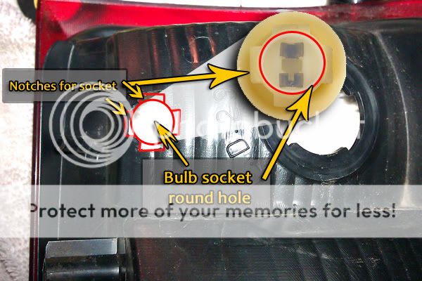

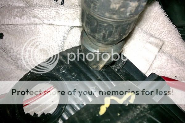

Gather all tools and materials and mark where you want to drill your hole for the new socket. I put my socket closer to the edge of the UPPER (clear) chamber, level / horizontally centered with the factory hole, but you can move it closer to the factory socket hole if you choose, as long as there is room for both. Once you are sure you have your hole marked and where you want it, use your drill and 1/8" or 1/4" bit to make your pilot hole.
Note: Try and use short bits; you don't want the drill bits going through the outer part of the tail lens. If you DON'T have short drill bits, Go easy...
Once you have the pilot hole drilled, use your step bit, or drill bit matching the socket diameter and drill your hole for the round part of the socket. With the step bit, you can start it by hand. Then slowly drill a little at a time, checking the diameter to make sure you don't drill it too big. Better to be a little on the small side, than too big. I drilled mine just a little smaller than the socket, then cleaned it up with a razor knife because the step bit left a beveled hole.
Step 2:

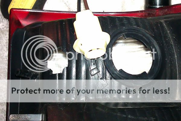

Once you are sure you have the round hole the right diameter, grab your razor knife and start slowly cutting out your notches. I started mine a little smaller and kept checking how well the socket fit as I was cutting the notches out bigger. The notches do not have to be absolutely perfect, but TAKE YOUR TIME!
Once you are done drilling and notching the holes in both tail lenses, make sure you turn the tail lenses (holes down) and shake all of the pieces of plastic out of them.
Step 3:
Install the 921 LL Bulbs in the new smaller sockets. Then insert and twist the sockets into tail lenses. It was cold outside when I done my tail lenses, so I used a heat gun to warm up the sockets (BEFORE PUTTING BULBS IN) just a little so they would go in the tail lenses easier. You may or may not have to heat them up. If you do, be careful with the heat gun, YOU CAN MELT THE SOCKET!

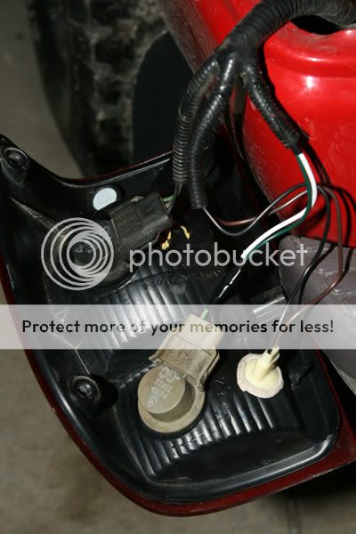

Remove the old tail lenses from your truck. Make note which sockets were installed in which opening of the 93-97 factory lenses. You should only have the sockets w/bulbs dangling out of the tail lens openings of the bed.
Step 5:

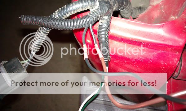

Tie into the reverse wires. You can either cut the factory reverse bulb socket out and solder the wires to the new socket, or you can use crimp connectors and tie into the reverse wires and leave the factory socket. If you decide to leave the factory socket, make sure you take the bulb out, and tape or zip tie it out of the way.
I cut my factory socket out, and soldered the new socket to the wires. Striped to Brown, Solid to Black. If you decide to solder them and you opt to use heat shrink tubing, put your tubing on before you solder them. Once soldered, use a cigarette lighter to shrink the tubing. Once your done it should look like this:
Repeat this step on both tail lenses.
Step 6:
Remove the clear turn signal bulbs and replace them with the yellow turn signal bulbs you bought. Then install the turn signal sockets in the upper (clear) chambers of the new tail lenses next to the new smaller sockets you drilled and installed. Install the brake/tail light sockets in the lower (red) chambers.
