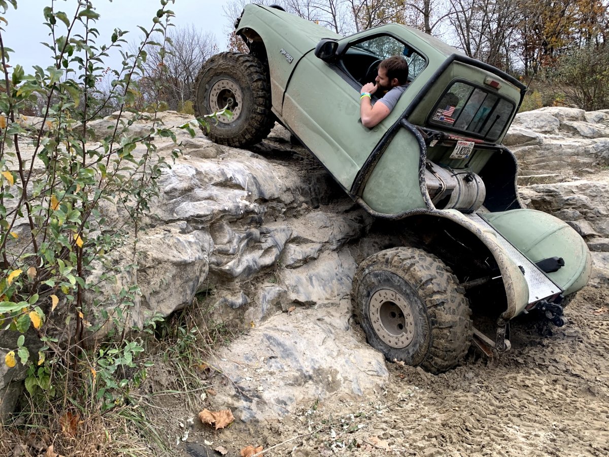

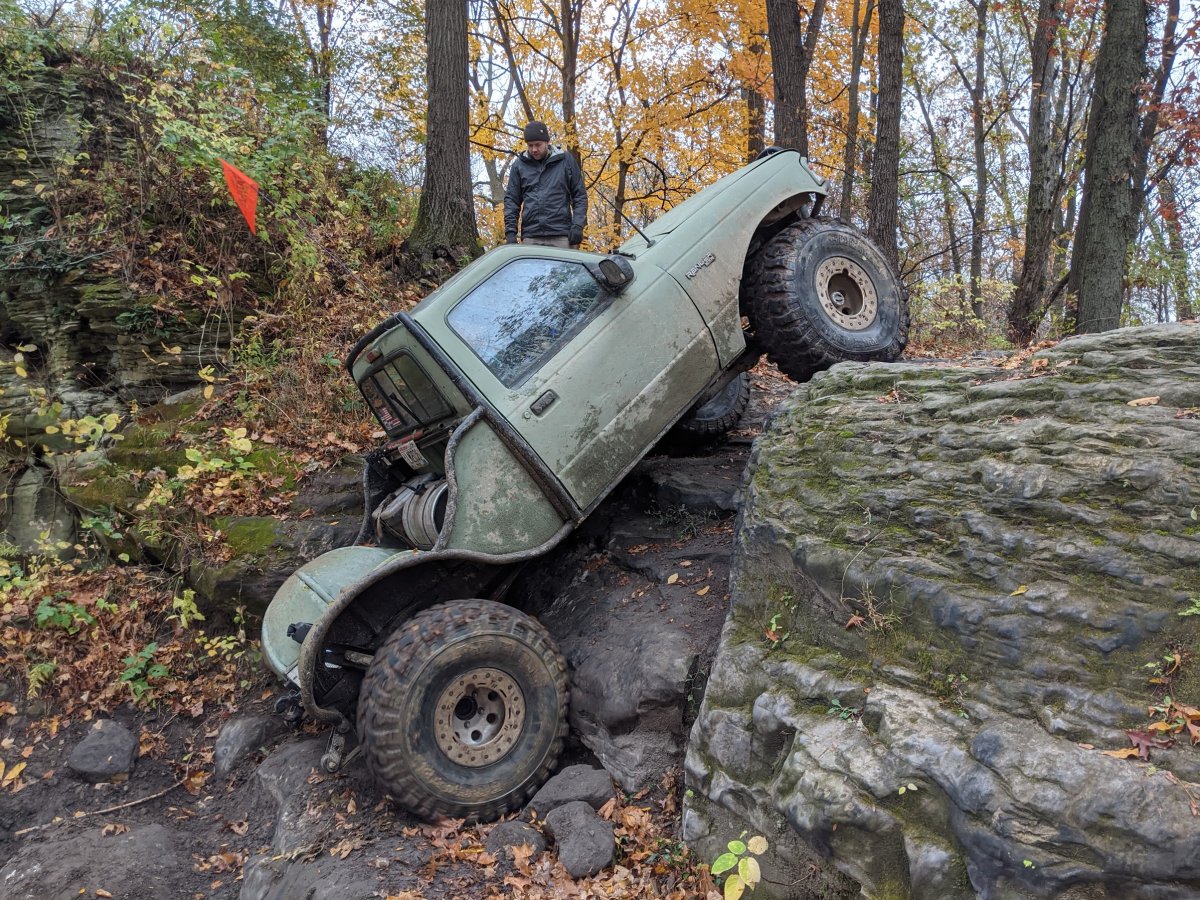

Heres some flex shots. My front end flexes for shit but the rear is pretty good.
