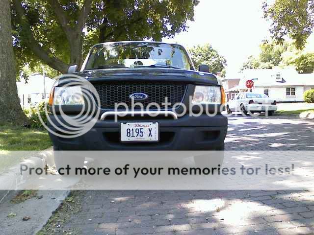

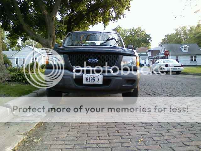

My bumper was an ugly grey/blue color and had some scratches so i cleaned it up a bit and threw some black on it. Figured i would post up some pictures for the heck of it. Wasnt anything drastic, just made it look a little more clean.
Before.

After.

Looks good. That homemade lightbar looks cheap in my opinion but if it works whatever.
when or if you get tired of the flat black I found that the Rustoleum BBQ grill paint is absolultely fantastic. Just the right satin finish. Goes on very nice and is stable. The trim on my ranger is done with it. Over a year now and no deterioration.
I lightly sanded the trim, sprayed on a coat, lightly sanded with 800 grit and resprayed and car polish doesn't stain it at all. Wipes right off.
yeah it is cheap, definitely. It was just a bored night in the garage kinda thing. workin on a custom bumper design i like now.

Paint it :icon_thumby:
It would fit in a lot better.
