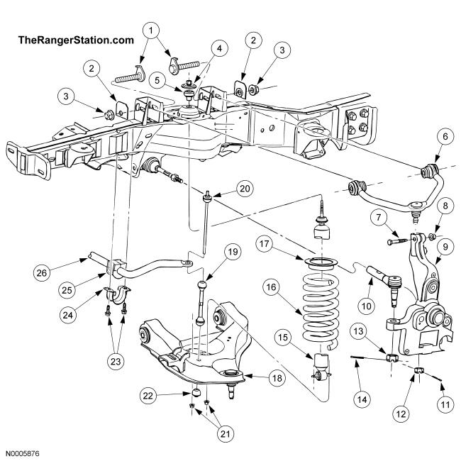

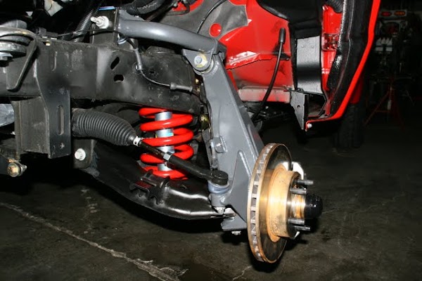

The 98+ 2wd Ranger has the A arm setup with coils.
And the coil buckets are built in in the frame. the inside wall of the frame works as part of the crossmember.
I was thinking about cutting the buckets, cutting the crossmember along, re-boxing the frame with 1/4" steel, make it a "straight" frame basically, and then work my way into making a crossmember thats strong enough(actually thinking about making 2 cossmembers) and that will let me have a fairly low height. Then ill mount some older Ranger coil buckets.

the crossmember holds the steering rack, right where the steering rack tie rod comes out in the pic, u can notice that the inner frame wall works as part of the crossmember

If i go with coils i would use the buckets from an older Ranger.
Steering box will come from an older Ranger too.
Shame i cant use the steering bars from a Ranger, or can i cut and sleeve them to make it work?

Seems like leafs could be a good option, but still i would need to hack the frame a lot.
call me crazy, but why can't you use the stock in-frame coil buckets and then just put new coil perches on the axle?
That was my original idea, but then the crossmember sits too low, and i would require too much lift to clear the diferential.

Anyway here are some pics of my frame.
you can see how the frame seems to be part of the crossmember.
I was thinking, since i have a 2" bodylift, and ill be making new crossmembers, could i lift the whole drivetrain 2" too?
