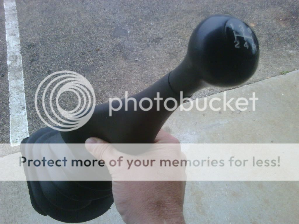

When you lift it off, you will notice a bunch of little metal clips falling off. These are from the shift boot, they hold it to the plastic. You really don't need them and I'm not sure they could be reused anyway. Once you get that off, you'll see how the shifter is attached. I forgot to take a picture of this, but there is a cam bolt that goes through the shifter. Using the 11/16" socket (or metric equivalent), remove the nut holding it all together. Now, thread the nut onto the other side of the bolt. You'll see what I mean when you do it. This will extract the bolt from the shifter. You may have to tap it with something to help get it out, but be careful not to damage the threads.
Once you get the shifter off you will have this-

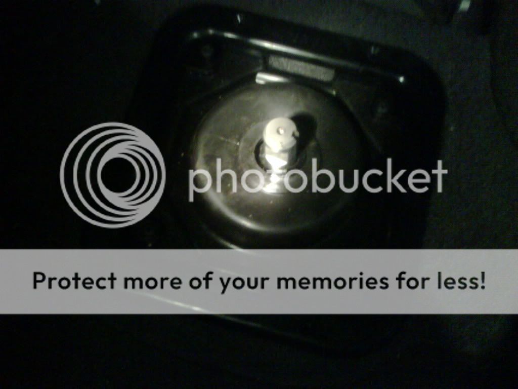

Ok, we're almost done with this part. Now, using the T30 Torx bit, remove the 3 bolts holding the actual shift mechanism that goes down into the transmission.
Good we're all done inside the truck for now. Be sure not to drop anything, or get any dirt, etc. down into the hole in the top of the transmission. I covered mine with a rag just in case.

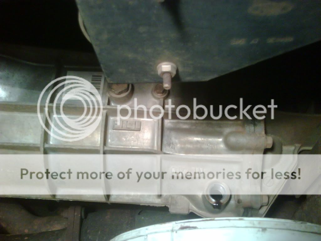

Now its time to crawl under the truck and get to the best part. In the following pic you will see the location of the drain plug on the drivers side of the transmission. Get a bucket or your drain pan ready and remove the drain plug. This is where I carefully used the adjustable wrench, but if you have the proper size it might be better.
Now that you've gotten the plug out and the old fluid is draining, take the time to clean the magnet that is part of the drain plug. Here you can see the crap on mine after 135k miles.
After a good cleaning-
Here is my old fluid, ugh. -
Now that the old fluid is drained, and you've cleaned the magnet, put your drain plug back in. It does not have to be super tight. Just snug it up and maybe give it a half a turn or so. Now remove the fill plug that is above and to the left of the drain plug. Again I used the adjustable wrench for this.
Alright, now find a funnel and insert it into the shifter hole from inside the truck. Remember to do this with the fill plug removed. Pour in the first couple quarts. Now when you are pouring in the 3rd, you can either get somebody to watch, or do it slowly. You want to pour the fluid in until it starts to run out of the fill plug. When it does, you can put the fill plug back in and tighten it up. Again not super tight. You're done with the messy part.
