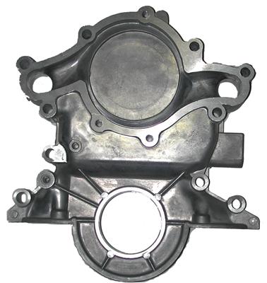

While you are there I do recommend running a shorter front dress, Explorers are really common in JY's around me, although the pesky timing covers give fits as far as removing, it is hard to find one without at least one bolt broken off and you have to rip half the car off to get to discover this. I have done two and have resigned myself to paying the $100 and not have to do it again.
One thing I like about the Explorer is that the alternator bolts on from above, so if you are out of town and/or in the middle of nowhere it is three bolts and two connectors to replace the alternator. With the long pivot bolt that is mounted even closer to the radiator you have to pull the radiator to remove it (depending on set up of course) and then for my truck it is a domino effect, you have to remove the fan from the radiator, then remove the tranny coolers to remove the fan and remove the grille and offroad lights to get the tranny coolers... all for a stinkin alternator. :annoyed: Basically with the Explorer setup, you only have to pull the radiator for the water pump or dampener pulley/timing cover... which is fairly normal IMO. The alternator and power steering pump are mounted nice and high and are easy to remove from their brackets. The Explorer also has something like a 130A alternator...
Funny you should mention the broken waterpump bolts. I picked up a 97 Exploder short block last weekend and it too has one broken pump bolt....the upper driver's side long bolt. Looks like whoever was responsible for assembling these engines thought it was funny to not use thread sealer on these bolts. The threads seep coolant, the coolant pools in the bolt hole in the timing cover and the bolt rust's itself to the aluminum cover.

I am buying a new timing cover ($100) rather than tear down yet another car to see if it had a broken bolt. You might get lucky and get the one off of your donar (gotta try, you are right there), I have tried twice with no luck. Both of mine were old injuries from water pump changes from years ago.
http://www.oreillyauto.com/site/c/d...5_298&keyword=timing+cover&pt=02383&ppt=C0141
Rockauto has a rather crude looking one for $75, sans gasket and seal and I would have to pay freight. Summit has them $100+freight for just the cover.

So what is the advantage of using a 5.0 exploder timing cover vs the one that is made for the year of the engine? I know that water pump dirrection flow change sometime along the way.
They are still reverse flow, the difference is in the way the water pump works with the timing cover.
85-93 Mustang reverse rotation (uses a backing plate on back of pump)
97-01 Explorer and 94-95 Mustang, water pump uses the timing cover as the backing plate.
94-95 Mustang uses the same cover. Autozone part numbers 500302T or 635-106, they will probably have to order them in. You might get lucky and get the one off the donar too. Rockauto has the 635-106 number with the gasket and seal for $100.

The 91 Marquis used a std rotation pump on a std rotation timing cover. The Mustang/pickup/vans used a different timing cover that matched the reverse pumps on them. The 79-85 Stangs used a reverse pump on the std rot. timing cover.
