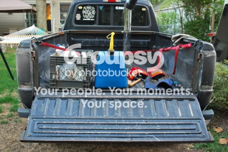

looks like i havent posted a thread on here, sooo here you go. this isn't everything but ill post most of the pics i can from start to current

ok, this is where i left off tonight. running a 4bt with a m5r2 trans, that as you can see has a different bellhousing as it is supposed to... i must of gotten a 6 cyl n not 8 cyl trans.
so ask questions lol easier then going back and putting in all the writing for the pics
questions???
if that gaggle of pictures wasn't self explanatory, i need a different dictionary with the proper definition of self expanatory.

never ran it on atf, i have thought about doing a diesel and other oil blend, but just dont have room to set it all up. one day i might be able to
You didnt tell me you got chromo axles and a locker for the D44.
And as far as your bell housing, you prob got a mod motor M5OD. The top 2 bolts lined up, but the rest didnt right?
top 2 and the bottom 2, the 2 side bolts i had to.. make my own wholes for lol.
old axles were covered in rust, so i figured for 100 bucks more mines well upgrade...and locker was a must :icon_thumby:

Front axle wedges cut off and grinded down
4BT '94 Ranger & EB D44 SAS (no56k)
New front leaf springs
going to start tearing out the front end next weekend.
well got the spring hangers all welded up and ground down ready for paint;
and it will be sitting taller than it sits here once the SAS is done. its 28" to bottom of the door in current position. so figureing it will be probably close to 40"
