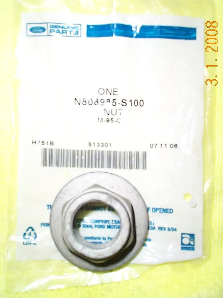

· Remove the axle nut (the manual says DO NOT reuse this ‘torque prevailing nut’) Buy a new one. The part number is shown above.
Ford didn't charge for this nut the last time they repaired the seals, so who knows if they replaced them or not. I did this time just to be sure.

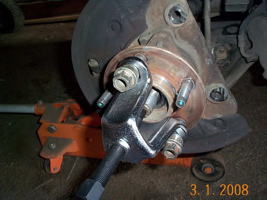

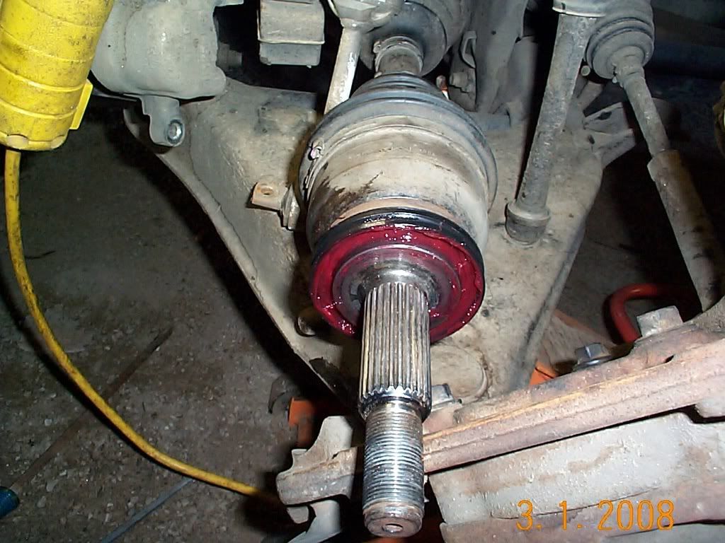

Now it’s time to separate the axle from the hub using the hub puller. It won’t take much effort to separate the axle using the tool.

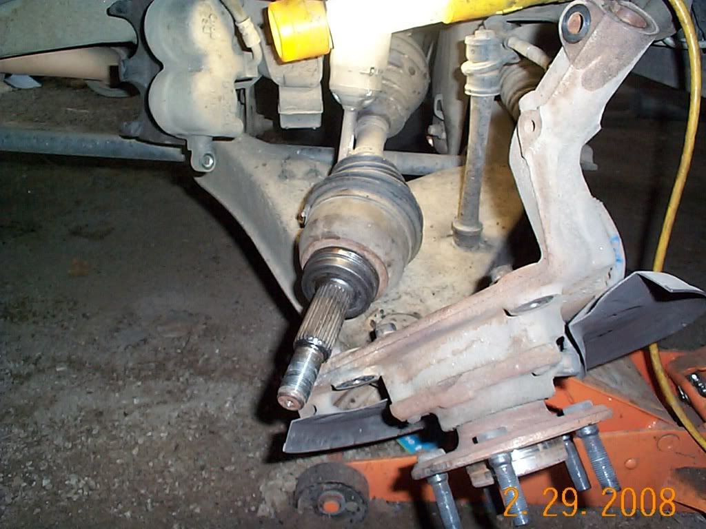

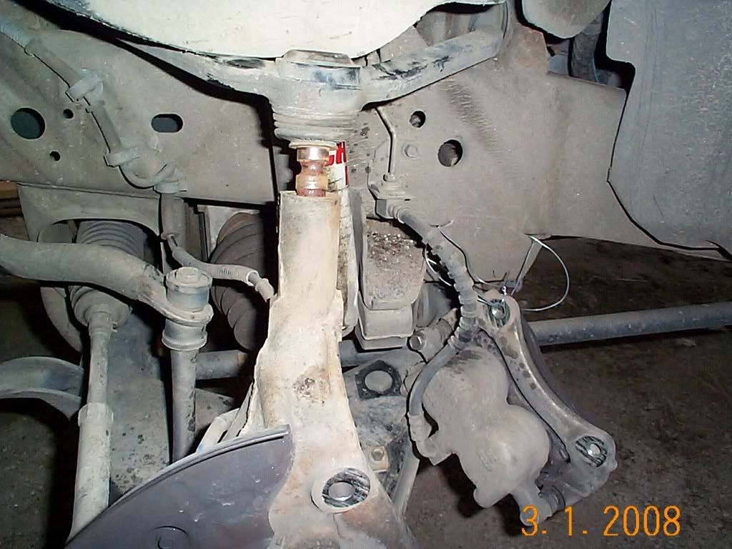

Once the axle is loose from the hub, remove the bolt that holds the upper ball joint to the wheel knuckle and separate it.
It's going to be a bit tight, so you might want a mallet to help free it from the control arm.
This is where the jack under the A-arm came in handy. I noticed if the A-arm was hanging free, it was hard to get the ball joint to come out. I found that if I jacked the A-arm up a bit and tap the upper control arm with a mallet, the ball joint popped loose.
Now comes a little bit of a fight:
You have to compress the CV joint so you can remove it from the hub and swing it out. I found this step to me a bit of a struggle, as it seems there isn’t enough room to clear the end of the CV joint. The manual doesn’t say anything about separating the tie rod; however after fighting the first side, I removed the tie rod on the second side.
It may even be easier if you separate the lower ball joint instead of the upper one. Maybe someone can comment on this if they’ve done it that way?
EDIT: Thanks to Sasquatch's advice below, it is apparently easier to separate the lower ball joint. I'll do this the next time and get some pictures.

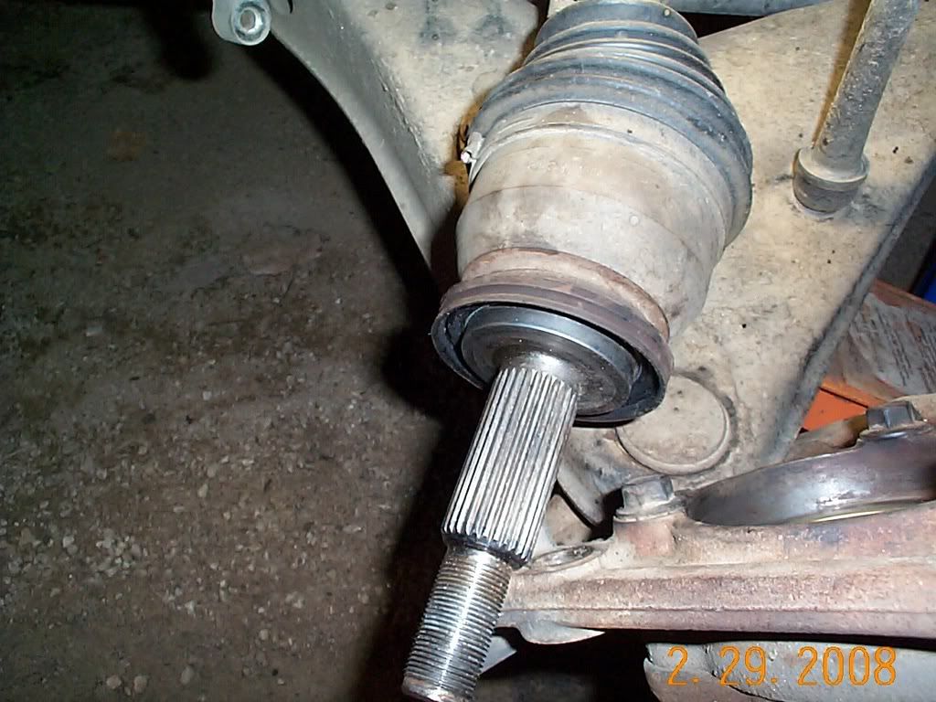

Ok, now with the axle out of the hub, it’s time to remove the CV joint.
The manual says to remove it with a special CV joint fork and slide hammer, but I didn't have one. I used a large screwdriver. Whatever you use, be careful not to damage the CV housing or your axle seal.
The manual also fails to mention that you need to move your shock out of the way. I couldn't get the CV boot past the shock. Now maybe that's because I'm using after-market Rancho shocks... I don't know. I didn't want to chance tearing up my CV boot, so I took the two lower screws off the shock and moved it over.
Once the CV shaft is popped loose, use BOTH hands when removing it from the axle housing. You don't want to damage that axle seal! I can only imagine what a pain in the *ss that would be to replace!

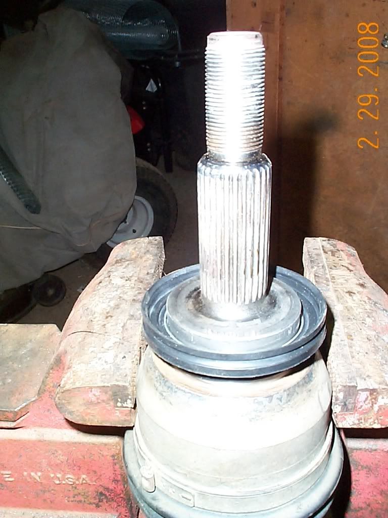

Now in case you’re wondering why you can’t simply install the new excluder seal without removing the CV shaft? Well… I suppose you could, but good luck getting it on correctly.
The seal is very thin and you could easily damage it if you don’t do it right. It’s A LOT easier taking the CV shaft out and putting it in a vice.

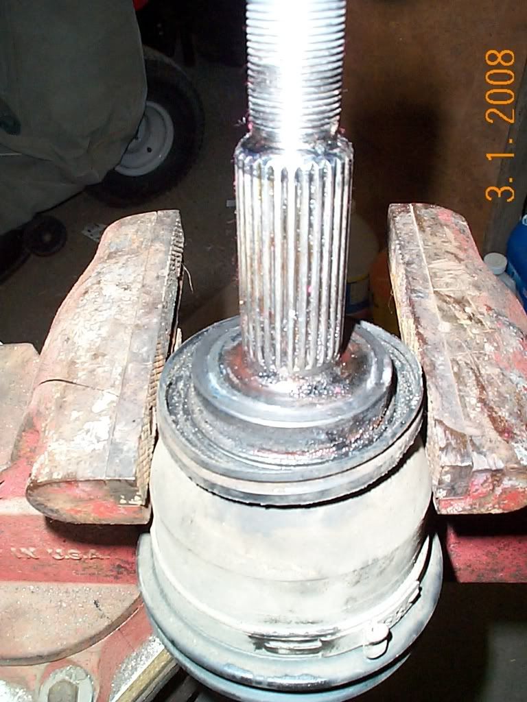

Pry off your old seal if it’s still on the CV shaft. One of mine was on the shaft, and the other wasn’t. Both were a nasty -gritty filthy mess.
Clean all the old grease and dirt from the CV shaft. I also used some emery cloth to clean up the seal surfaces and wash it off with brake cleaner.
Clean the back of the hub where the seal rides. Dig out all the old grease, dirt and grime. I even used Q-tips to get down inside the ring where the seal rides. It was also packed with old nasty grease and road grime. You don't want that to come back out and get into your new seals. Take your time and clean it thoroughly.
From what I’ve read… CLEANLINESS is vital in reinstalling these seals.
Make sure everything is spotless. Again, I used brake cleaner as it keeps the grease away and dries without any residue.

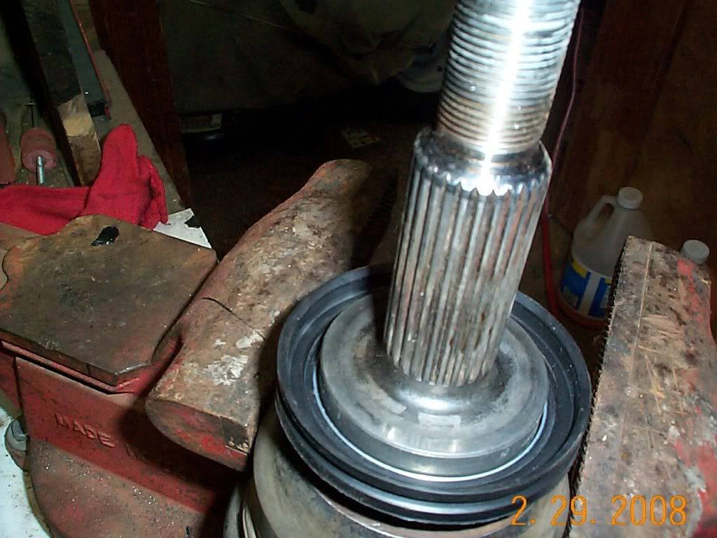

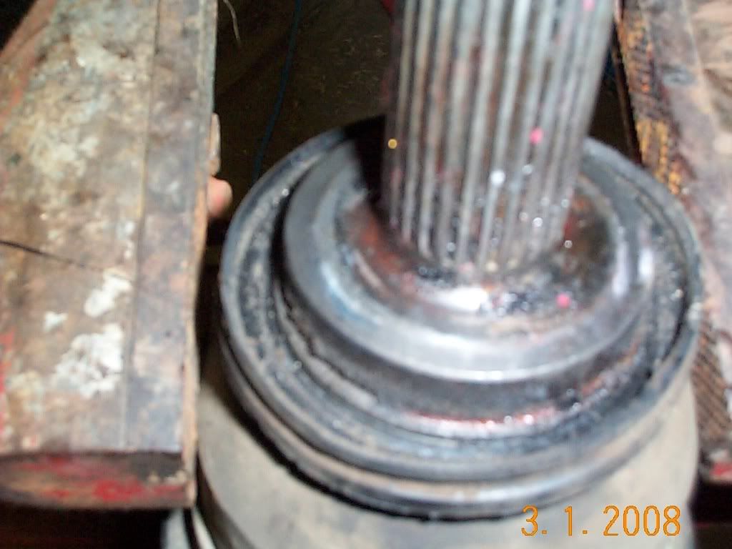

Once you have everything spick-n-span, it’s time to install that pesky seal on the CV shaft. You might want to skip that next beer until this part is done...
If you look close, you can see a metal ring in the seal (green arrow).
BE CAREFUL AND ONLY PRESS ON THAT STEEL AREA OF THE SEAL!
Otherwise you’ll damage it, then you’re out $20 plus the cost to go get a new one.

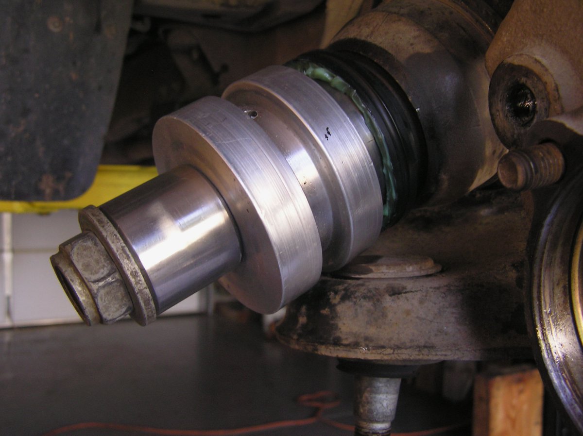

Start the seal by hand and then press on the steel part of the seal in equal amounts around the CV shaft. Take your time and be careful.
Ford has a special tool to install this seal, but since I didn’t have one, I used a couple of different things. I found that a 2” PVC coupler fit almost perfectly and only contacted the metal ring. I used that to get the seal most of the way down and then finished it off with small pin-punch. The seal will seat right up against that metal ring and be parallel to the CV joint face.
![](http://i244.photobucket.com/albums/gg18/davagrant/Ranger%20Excluder%20Seals/DCP14703.jpg)
![](http://i244.photobucket.com/albums/gg18/davagrant/Ranger%20Excluder%20Seals/DCP14702.jpg)
![](http://i244.photobucket.com/albums/gg18/davagrant/Ranger%20Excluder%20Seals/DCP14707.jpg)
![](http://i244.photobucket.com/albums/gg18/davagrant/Ranger%20Excluder%20Seals/DCP14706.jpg)
![](http://i244.photobucket.com/albums/gg18/davagrant/Ranger%20Excluder%20Seals/DCP14697.jpg)
![](http://i244.photobucket.com/albums/gg18/davagrant/Ranger%20Excluder%20Seals/sealring1.jpg)
![](http://i244.photobucket.com/albums/gg18/davagrant/Ranger%20Excluder%20Seals/DCP14692.jpg)
![](http://i244.photobucket.com/albums/gg18/davagrant/Ranger%20Excluder%20Seals/DCP14691.jpg)

Reinstall your upper ball joint, brake rotor, brake caliper, shock (if removed) and tie rod if removed).
Torque everything according to your manual.
