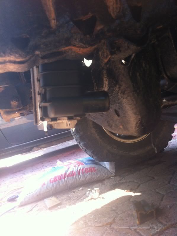

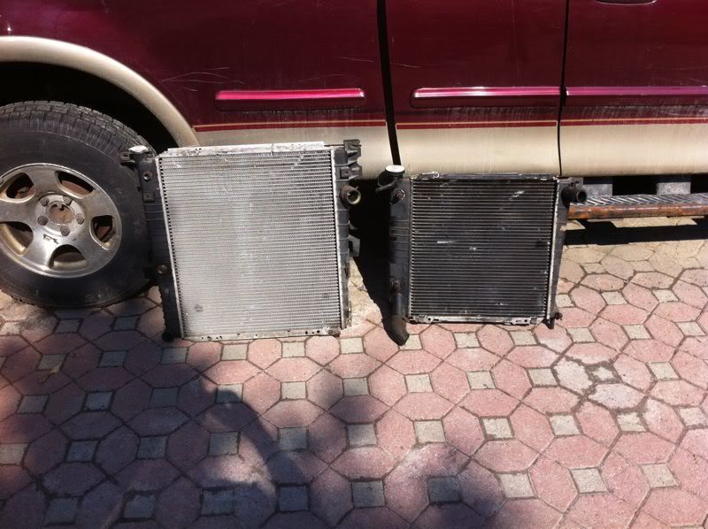

Hey, I went out to the scrap yard and bought a rad for a 97 explorer. I have heard of people using this rad and thought it would be a good idea however, I ran into some problems with this rad being so big. I got fed up of trying to fit the larger rad that I did more research......and the answer is the 91-94 rad from the explorer...... The scrap yard didn't want to exchange the rad so they gave me a discount on the smaller rad. Thought I'd post some pics of the problems I encountered using the 97 explorer rad.
Rad is way too tall....unless you want a broken rad within a couple minutes of off-roading, this was even with an angle towards the rear of the truck.
Even with the rad installed, the rad out let is being blocked. I'm sure there's a way around it, but don't really have the time since the truck was my DD.
Thought I'd include a photo of the size difference.

What is that lump of something that is blocking the outlet? Mine has nothing like that under there.
They are a bugger to pull in JY's, they sure feel shoehorned in there. I wondered how they would fit in an older truck, after seeing the pics I wonder how a 3" bodylift would play into it...
FWIW they changed the core supports somewhere around '96, they bolt in those trucks like the 91-94 Explorer radiators bolt in the 83-95ish trucks.

The lump thing goes across from one side of the frame to the other. I think is to brace the frame rails, it's infront of the crossmember.
Yeah the truck has no body or suspension lift. It would definitely make it easier with a body lift for sure, but I wanted to keep the ranger stock-looking.

The 91-94 Explorer (A/C, Automatic, 4dr) is a two row radiatior, basically it is twice the thickness of the stock radiator. It bolts right in the older trucks. '95+ Explorers use the bigger style radiator.

The problem you guys are having is the 97 explorer rad's only work in 99 up rangers!!!
That metal piece blocking the rad outlet in the pic is part of the TTB suspension bracing, the 99 up rangers have a exploder front end so to speak and a explorer rad bolts right in.........
They changed the core support before that, I think around '96.
Mine does not have that bracket.
