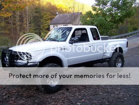

Finally getting around to posting my build.
The day I brought it home. $400 truck. Nice body and came with a 3 inch body lift but both heads were cracked, no exhaust, missing front driveshaft, snapped front axle, no oil in the rear axle, bad brakes all the way around, mismatched wheels, etc...
1993 Splash build
Got a set of heads (aftermarket supposedly stronger). Port/polish job and a set of Hedman headers.
1993 Splash build
After that, I painted it and slapped a set of 32s on it with some steel chromies.
1993 Splash build
Fixed the 4x4. New transfer case motor, milemarker hubs, and replaced 3rd member (3.27s)
1993 Splash build
Got a brush gaurd off of a Cherokee to fit on the truck, UWS steppie toolbox, built a spare tire carrier, and added a set of American Racing AR23's
1993 Splash build
Added Rough Country leveling coils which netted 2.5" lift :icon_confused: . Used 3 degree camber bushings to correct it.
1993 Splash build
Built front hitch reciever. Here you can see how far off the camber was :D
1993 Splash build
Added single 3" in, dual 2.5 out exhaust with Flowmaster Super 44 and 3.5" Silverline tips striaght out the back :icon_bounceblue:
1993 Splash build
Got a set of 33" Swampers and Mickey Thompson Classic IIs
1993 Splash build
More to come...
Start of the 4.56 gear/disc 8.8 swap. Bought complete 4.56 fron Dana35 axle from member TeamExplorer for $150. I opted for the open carrier as Im putting in an Aussie in the near future.
1993 Splash build
1993 Splash build
1993 Splash build
1993 Splash build
1993 Splash build
After the gear swap I dropped some coin on some brand new 35" BFG KM2s and found a Yakima roof rack on CL for $200 ( I do a lot of camping ). Snapped my newish lockouts and swapped out to the Warn 37780s...havent had a problem since.
1993 Splash build
No photos, but the exterior lights are all LED. Used flasher EL12L2 from napa. You need to revers the wiring for it to work properly.
And here's how she sets now. Just recently finished my front bumper.
1993 Splash build
Still yet to come is Aussie locker for the rear, F250 shock towers/longer shocks, extended radius arms (fabricated by me of course), and some EB coils for more flex because everyone know the TTB coils dont flex for shit :)
I'll update this thread from now on when the money burns a hole through my pocket or I get creative.
Just finished up the order on my Aussie Locker. $303.00 with 3 day shipping.
Oh and gear oil's gone through the freakin roof. Minimum of 19/qt. for full synthetic

any better pics of the bumper? dam close to what i want to build
It's almost like Christmas, I tell you!
1993 Splash build
Got the locker installed today. Very easy. I think I'd rather do these than drum brakes. Im also amazed that the traction I have and how quiet the operation is.
1993 Splash build
1993 Splash build
i really like the roof rack. i was thinking about doing one on mine but idk if i could pull into the garage with it, could you tell me how high it sits off the roof?
^ Too high IMHO. The crossbars sit up about 3" PLUS the 6 or seven inches of the basket itself.
Absolutely KILLS your gas mileage too. I leave it off until I go on a camping trip when I need it.
