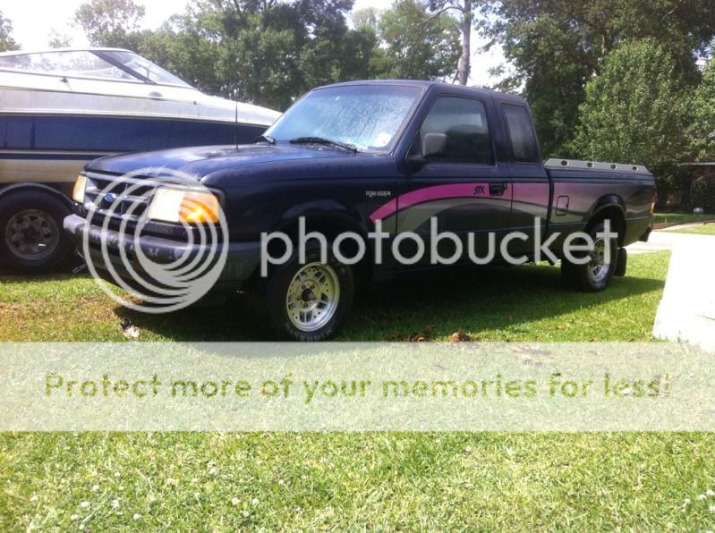

Here's the truck, at my house. That's Papa J's boat in the background. I just finished some engine work on it and as soon as I finish the wiring it'll be back in the water...
