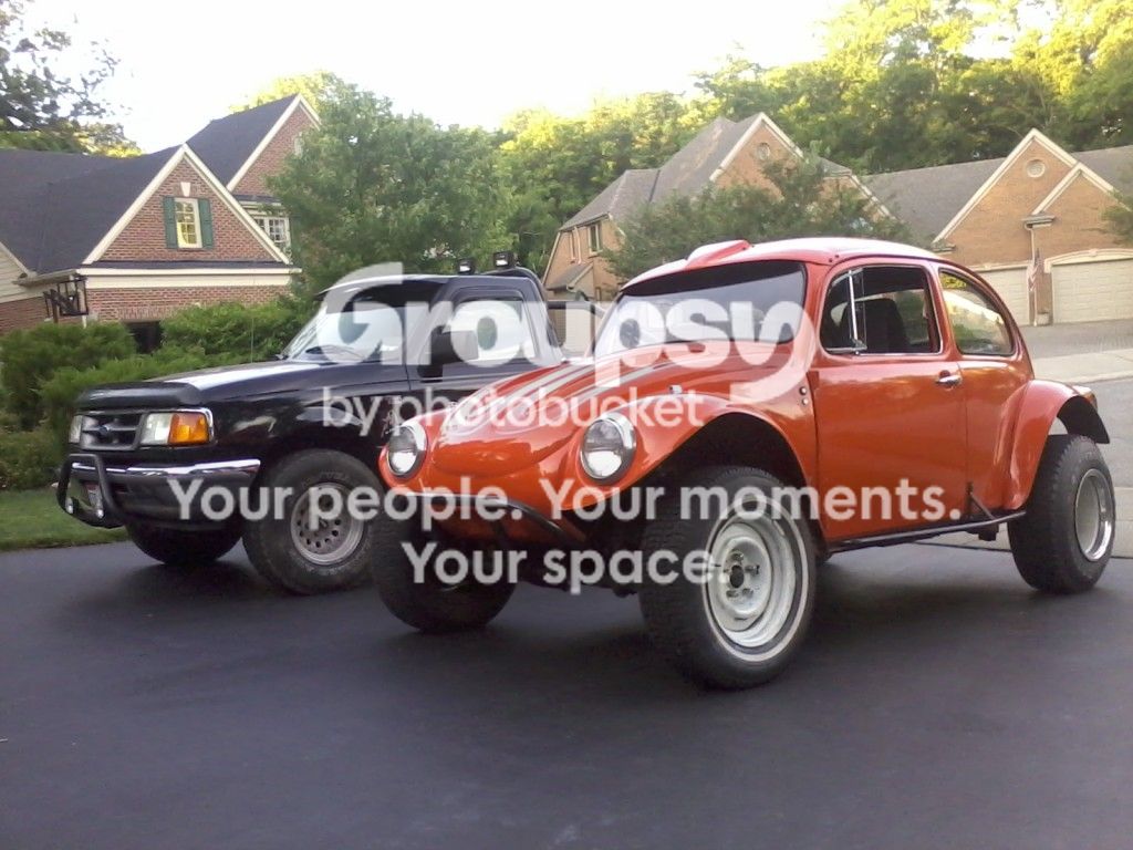

Hey all, here is my 1976 Baja Bug with a 68 motor. I'm restoring it mechanically. I picked it up for only $1200! :yahoo: Its frame and body are solid with only minor rust on the floor and body (considering its age and the fact that its been in Michigan and Ohio its whole life). I need to clean up and fix up the motor, fix the brakes, the interior, speedo, and that's about all that's left. I need to patch the floors a bit, and depending on funding, bodywork and paint. I might also build a speaker box behind the back seat considering it has no speakers.

Just a quick update. My dad has convinced me to do a frame off restoration. So I will be starting the process at the end of August. I'm gonna miss driving it for a while, but it will be worth it. The build will have plenty of pics.
Just an update, Got the bug moved to my house and its ready to be torn down.
