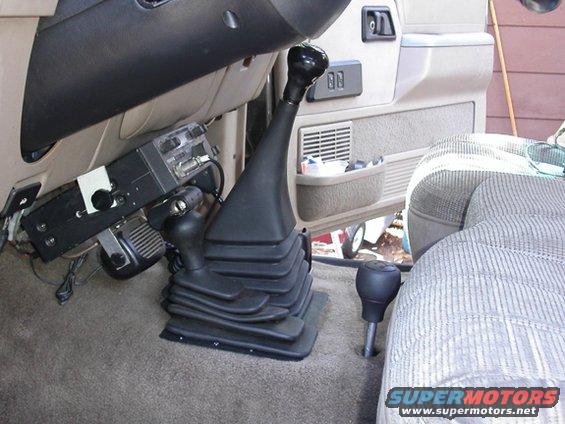

FWIW, I built a bezel for mine out of strip steel, reusing the rubber boots. I attached the boots with tiny pieces of angle steel and 2-56 screws on the inside (sorry I don't have any pics of the inside, though you can see some of the screws along the edge).
I think that pic was taken before I re-worked it for a M5OD swap, however it still looks the same other than there's a bit more of the steel plate showing in front of the transmission shifter.

I just did this to my Bronco II--had to take the old bezel and the new one and match them up to make the cut out required for the manual TC shifter. Used an air cutoff tool to make the cuts on the M50D bezel. I used the rubber seal from the M50D and an extra rear floor mat to make the cover and keep the noise underneath. You can see how much farther forward the M50D shifter sits in relation to the TC handle.
That doesn't look half bad. Maybe make some nice wood trim pieces out of base-board mouldings and that would look pretty slick.
