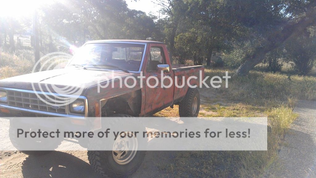

so im 16 and this is my first truck, its an '84 single cab long bed v6 with an auto tranny and this is it on day one on the trailer at the tow yard where i got it for free, it had a 3 inch body lift and a 3 inch suspension lift on 35 inch tires

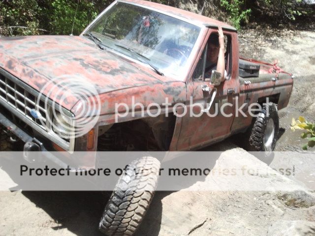

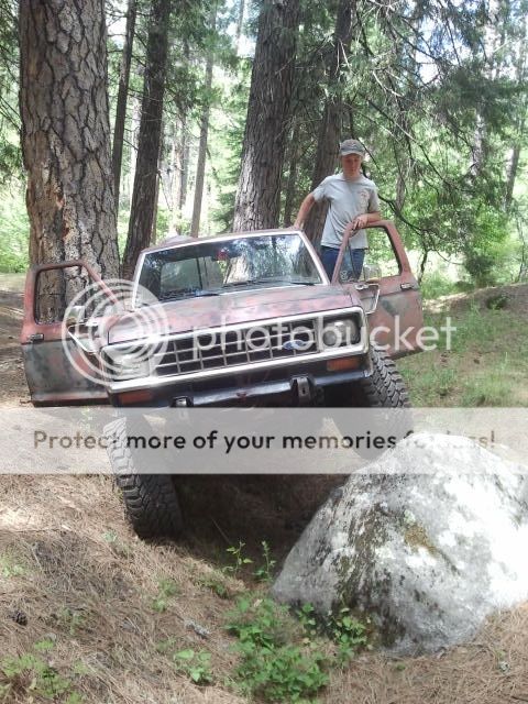

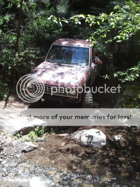

so after i got all of that running clean and working the way i want (except for my front coil springs are too stiff) i took it out to blue canyon for a little two day 4x4 run with my friend
see i barely get flex out of those front coils
this was much steeper than it looks, it sucks that cameras make every steep hill look flat haha
that was all from my blue canyon trip, and this is it just sitting at my house
as you can see im doing some fender modification at the moment, actually as of now the rear fenders are cut out like the front drivers side is, the front passenger is almost done in that picture, i made it 3 inches taller and 3 inches longer to fit the tires because i took the body lift off:icon_welder:

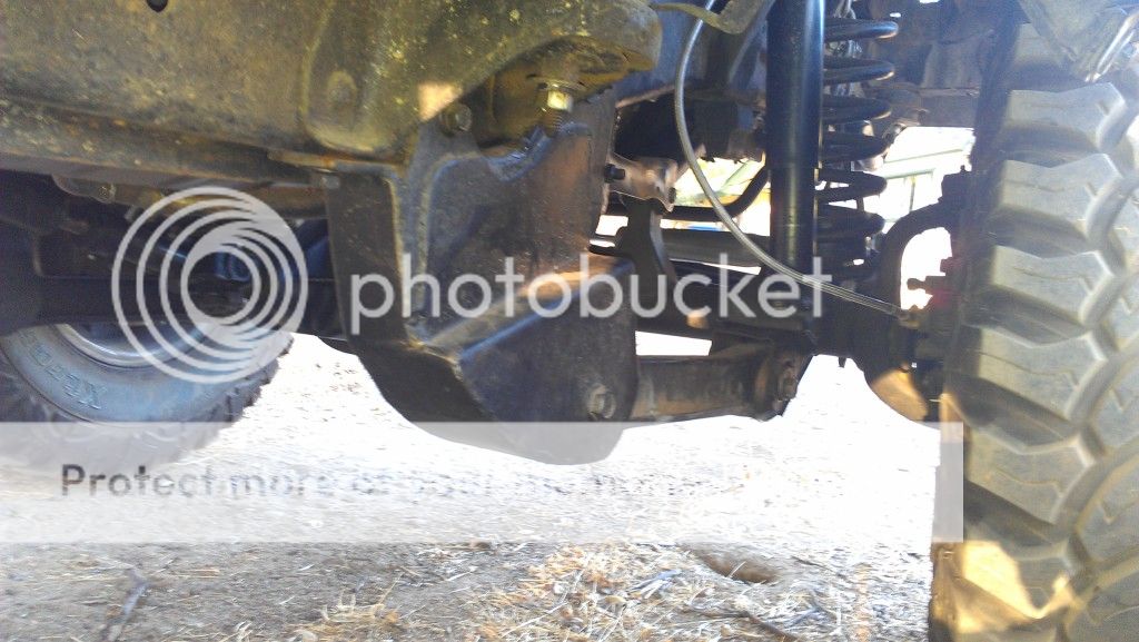

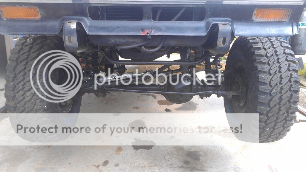

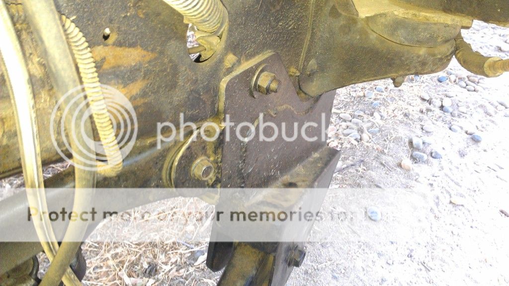

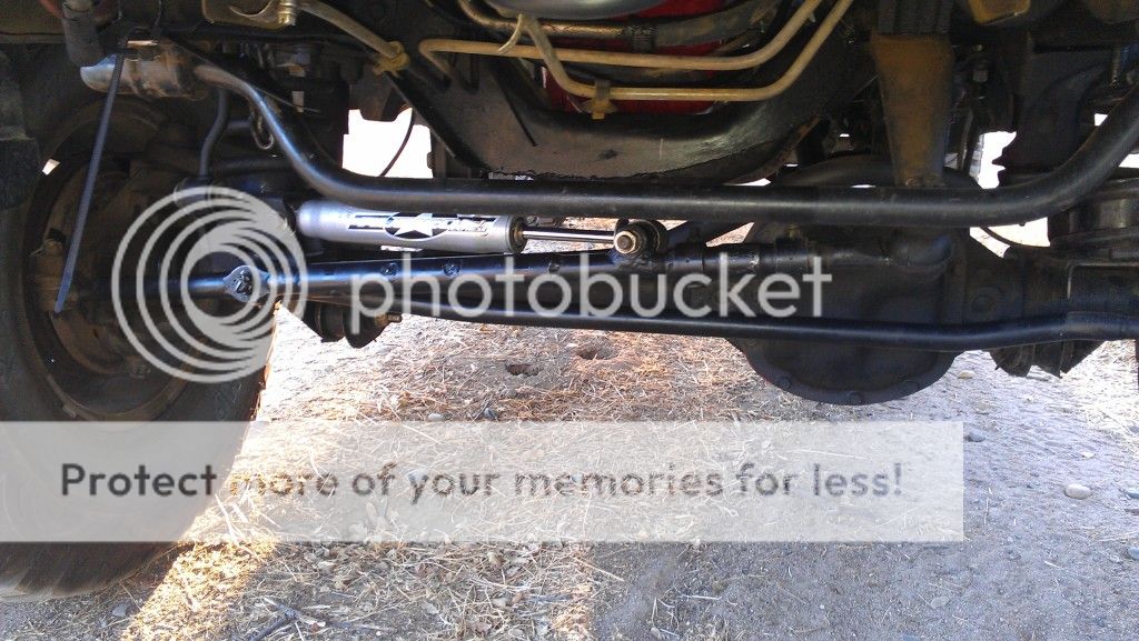

it was very easy as long as you have access to a torch, welder, metal break ect... on mine the coil mounts lined up perfectly, all i had to do was make a bracket on each side to hold the trailing arms with the right dementions and i had to combine the jeep steering arm with a ford end to fit into the steering box, ill post some pictures of that in a little bit

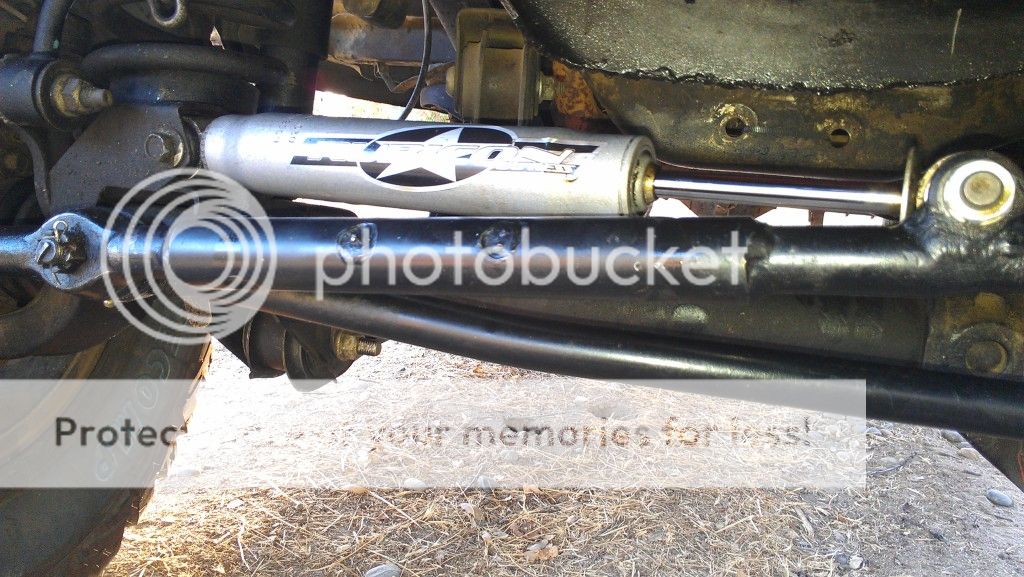

ok so heres a couple pictures of the steering arm i mated together
and heres a bunch of pics of the trailing arm brackets i made, you can see i sacrificed some clearance to keep the arms level, but im glad i did it cause it drives very smooth with it like that
this is just a better picture of the whole axle, its on a highlift so its fully extended with the sway bar on, if i disconnect that i get quite a bit more travel

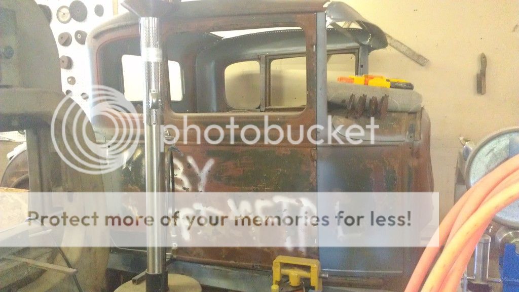

and also i couldnt resist... heres my REAL baby, its a 1931 ford model-A coupe:D ive been working on it since i was like 8 years old, the ranger has sorta put it off for a while tho
