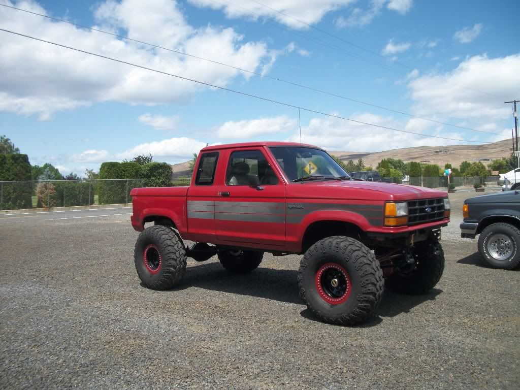

We've been building this for about 9 months now, and it's pretty close to being completed.
If you would like to see more, you can see the build thread here: http://www.therangerstation.com/forums/showthread.php?t=120009
Specs:
Truck itself.
-1989 Ford Ranger STX extra cab.
-2.9L V6
-5 Speed stock transmission
Tires
-37/14.5/15 Bias Iroks
-15" D-Window Steel wheels
-DIY Ruffstuff Beadlocks
Front Axle
-High Pinion Dana 44 3/4 ton.
-Spartan Locker.
-5.13 gear ratio.
-62.75" wide.
-High Steer.
-Waggoneer 6 lug outers.
Rear Axle
-Ford 9 inch.
-Full floater. (14 bolt axle shafts).
-5.13 gear ratio.
-Detroit Locker.
-14 bolt outers, modified to 6 lug.
-Disc brakes.
Transfercase
-1350 Transfercase
-D&D Machine Doubler adapter
-Equals dual transfercases
Suspension
-Leaf springs
Misc. Mods.
-Double Bobbed bed 2 feet.
-Fender Flares.
-Custom front bumper
-Ramsey 8000lb Winch
-Custom transfer case knobs
-Rock sliders
-Wheelbase: 115"
-More I forgot but will add later. :icon_thumby:

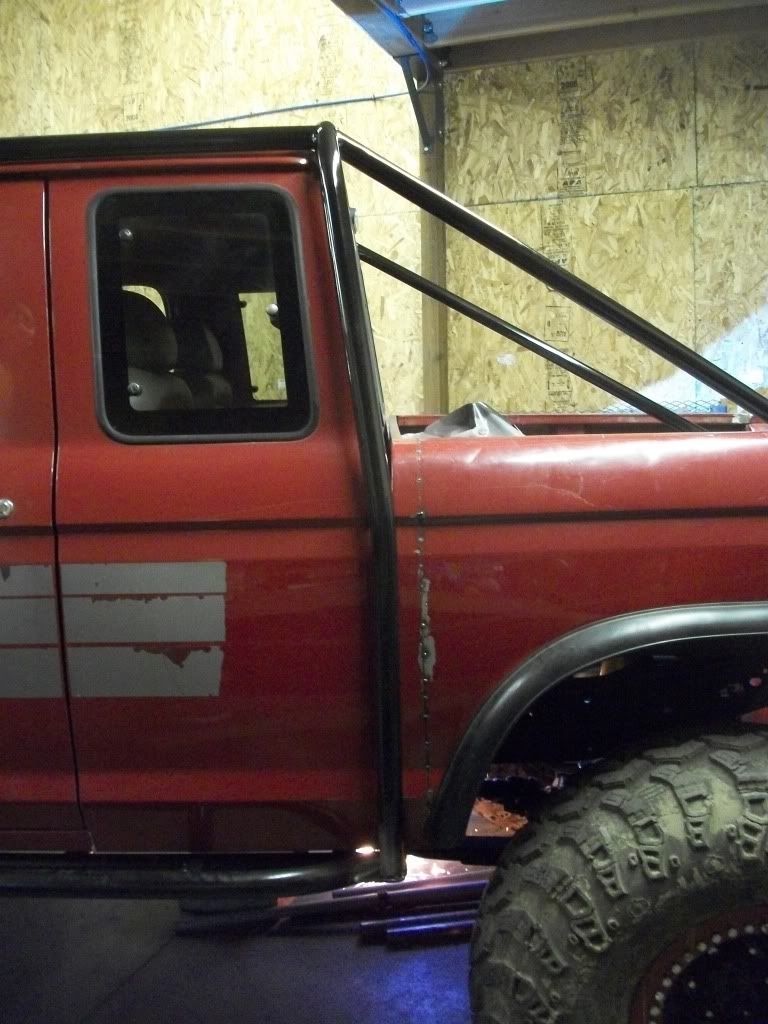

New cage:

Looks like a solid truck. I usually prefer the look of tube bumpers over the plate style bumpers but I like how you kinda integrated both styles in your front bumper.

Looks good! Why are your mirrors half way down the door though?

Do you mean halfway down the length of the door? That's where they were when we bought it.. That's where the hole is. Are they in a different spot on other trucks?
Ha! Just noticed that. On my 93 they're right where the A Pillar meets. No clue about the older model; I guess I never noticed if that's normal or not.

Your mirrors are in the right spot, that is just how the first and second gen ranger's mirrors are.

Thought so. Are they the stock mirrors for an STX truck? There's small holes and a not-so-faded spot lower down on the door like it might have had the swing-out aluminum mirrors at some point in it's life..:dunno:

They are that far back to accommodate the trucks that came with vent windows
