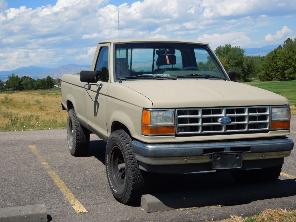

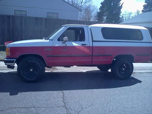

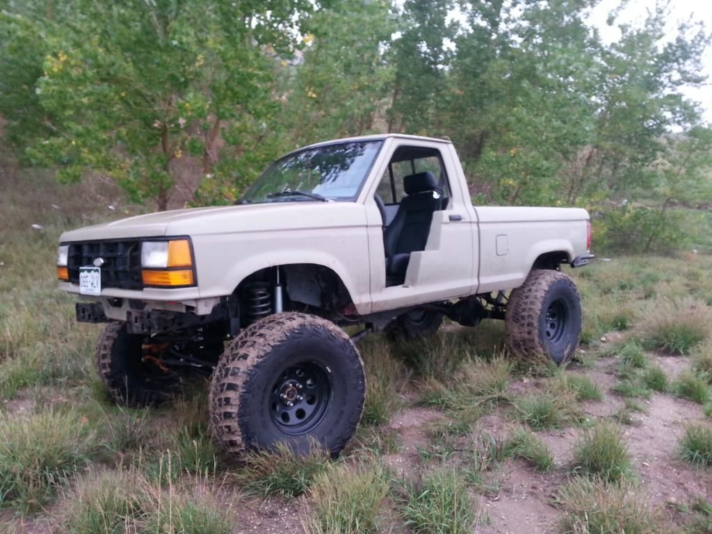

Current picture of rig:
Rocky Mountain Ranger '92 SAS

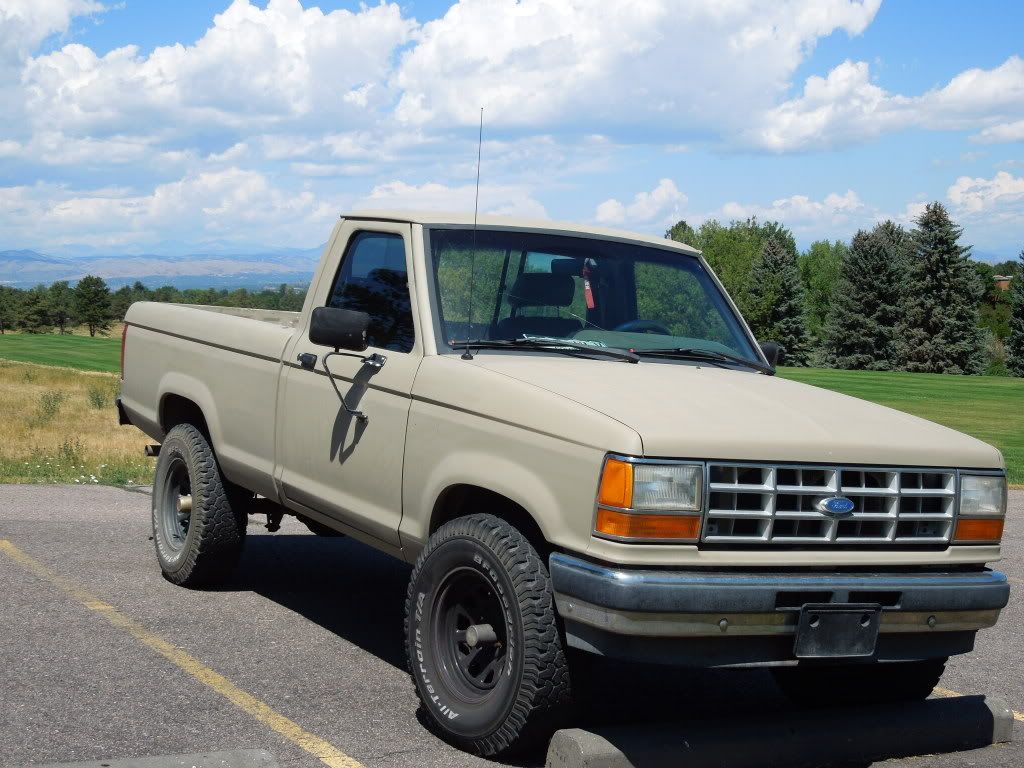

It had suffered some hail damage before I picked it up. I will live with the dents, but the windshield needs replaced sometime in the near future. Then I got rid of the faded red and white two-tone paint.
I ditched the topper, and trim, did a little prep work and painted it flat khaki.

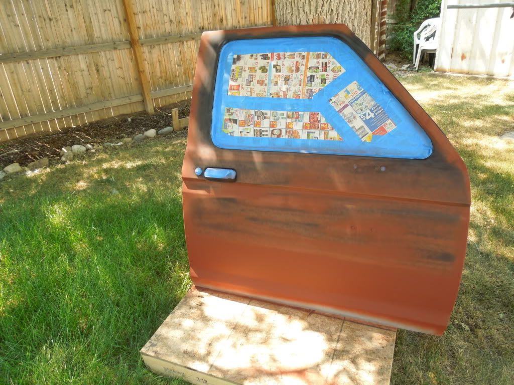

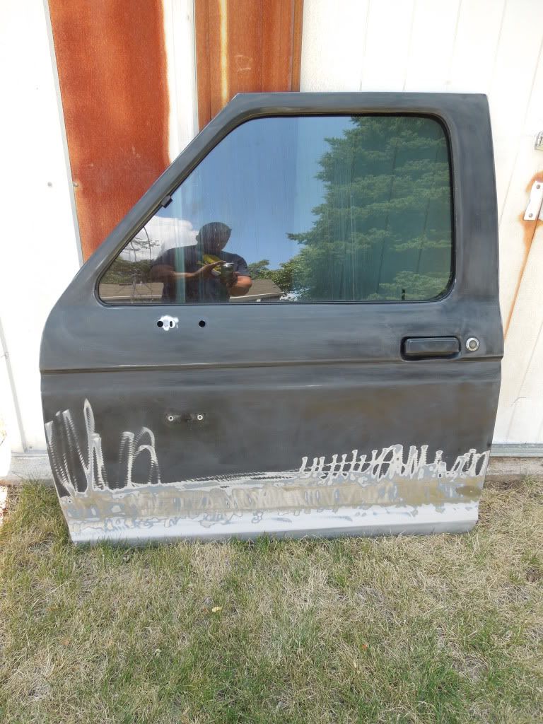

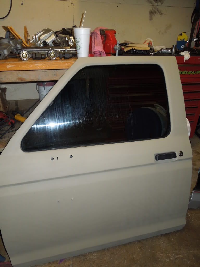

I repainted a set of doors with tinted windows, Got rid of the stock decal with the flapwheel and sanded the rest.

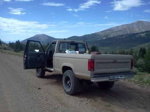

Took it camping up off Boreas Pass near Breckenridge this last weekend. Our campsite was tucked off the road near 10,500ft in White River National Forest. Found a lot of traces of Elk and blackbear. It rained off and on while we were there and the burn bans were finally lifted so we could have a campfire.

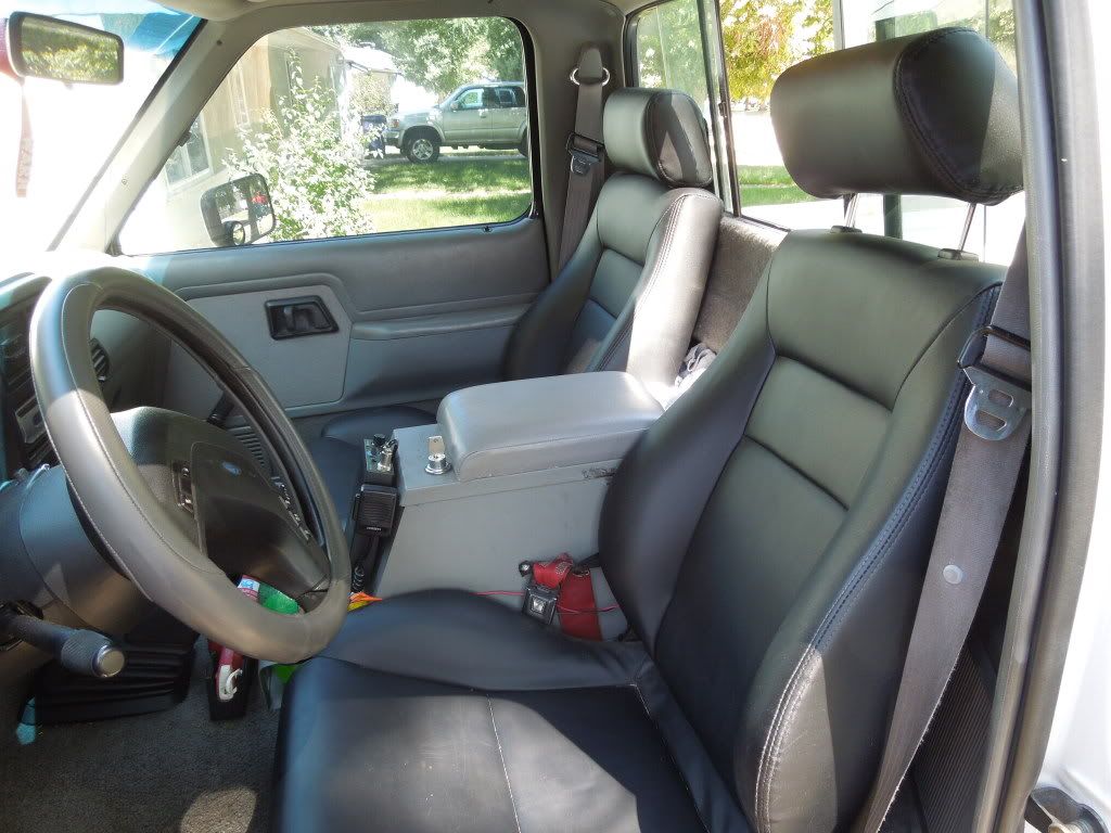

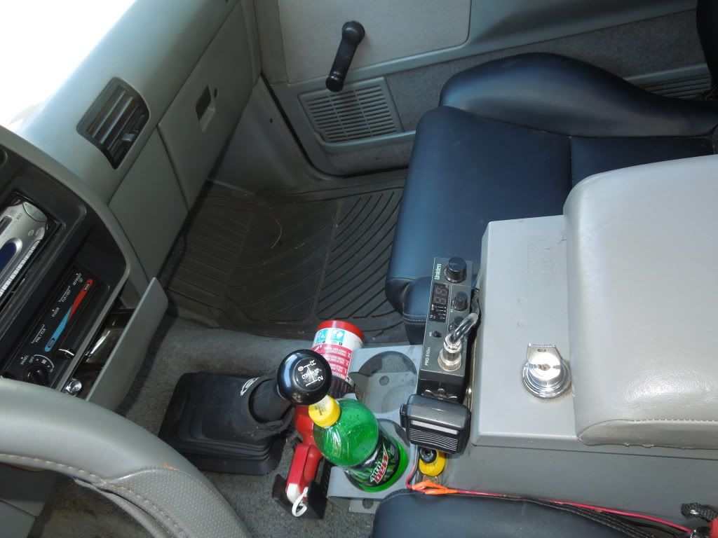

Installed a cheap cd player, cb, tuffy lockable console box.
I also swapped the rails out on some waterproof seats and bolted them in.

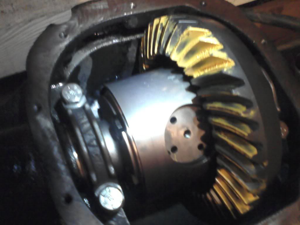

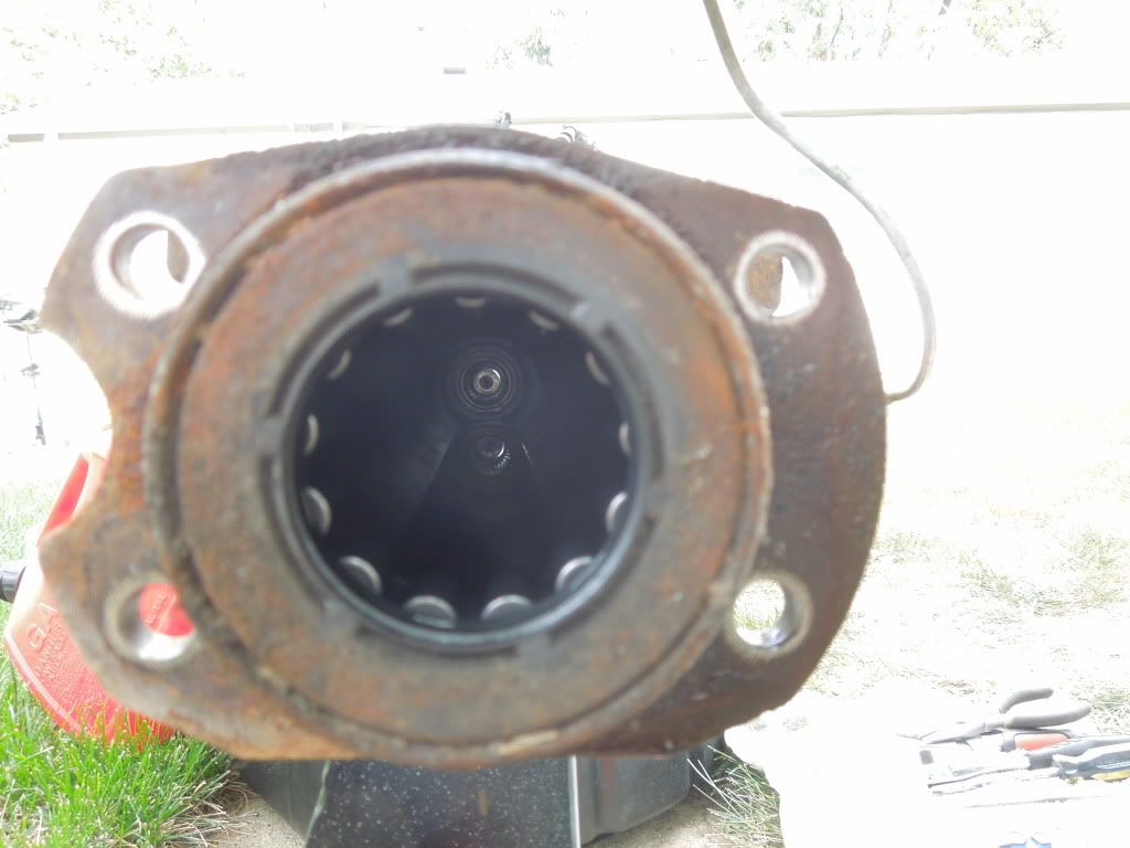

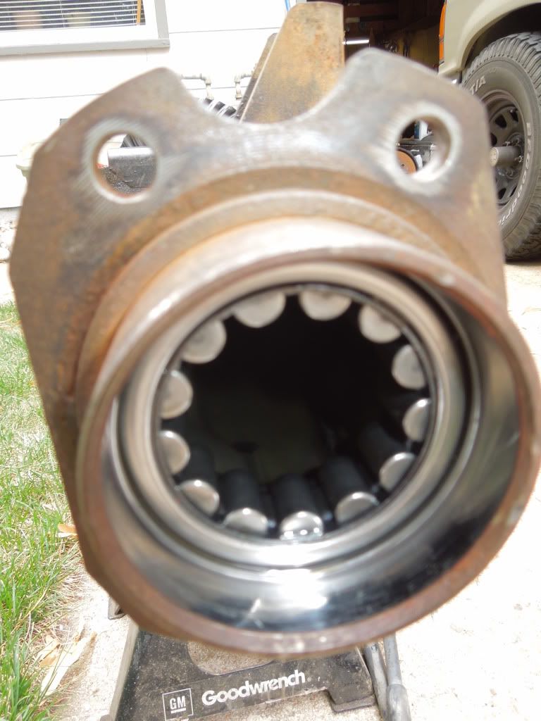

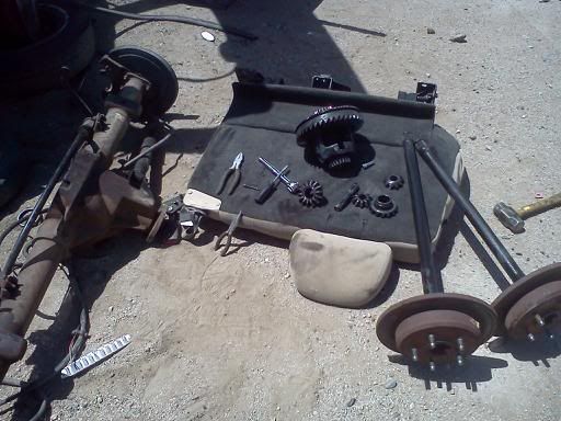

It is a '93 Explorer 31 spline drum brake 8.8 It has been regeared 4.56 with a new carrier (Detroit Truetrac) which is a solid body design with the helical gear limited slip internals hidden. This makes a small difference in how the shafts are removed/installed.
There is an access port on one side of the truetrac carrier held in by a snap-ring
remove the snap ring and access port cover I then the ~1" slug that holds the shafts in place. Push the axle shafts further into the differential and remove the c-clips. The drivers side shaft came out easily and I was able to remove the c-clip with needle nose, but I had to clamp the passenger side shaft from the flange to the backing plate to push it further into the diff so the c-clip would clear the carrier body, I used two strong magnets to pull the c-clip and finally removed the shaft.

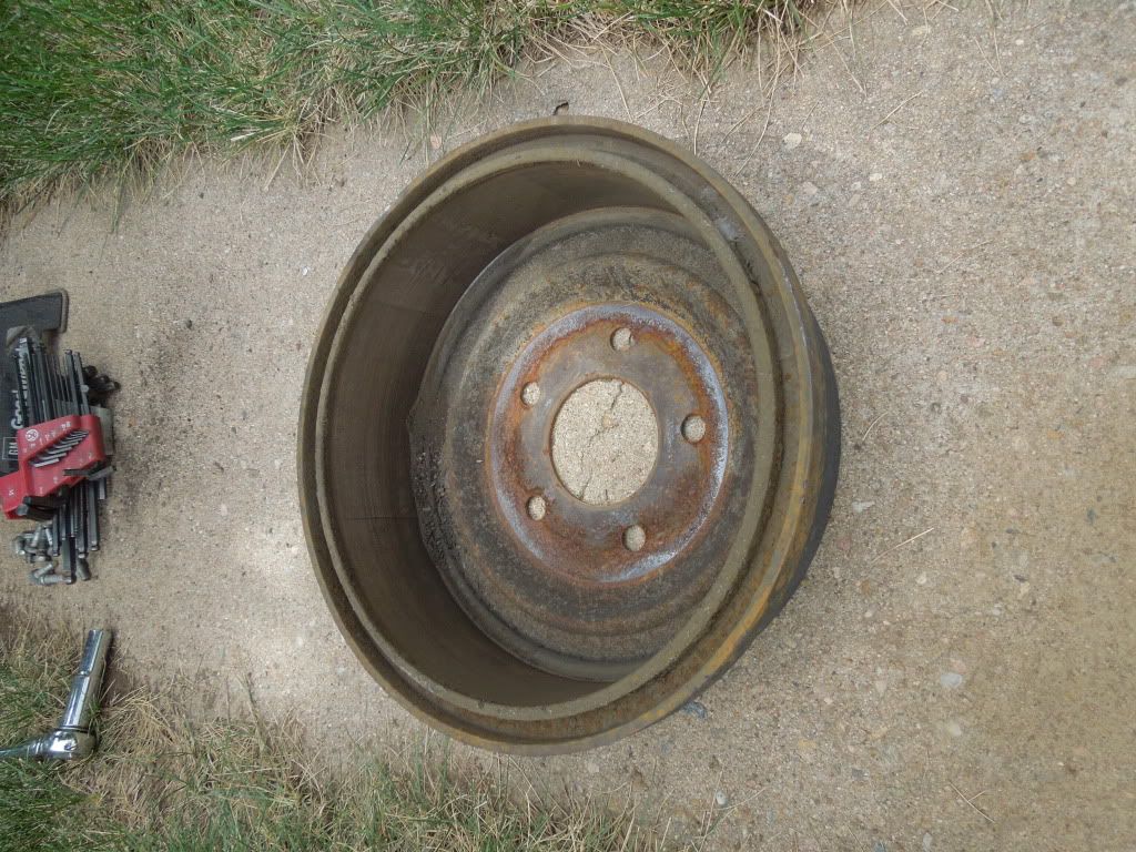

I wanted disk brakes, I had problems with my old drum setup locking up in wet conditions and the newer explorer disk brakes bolt right onto the '93 housing.

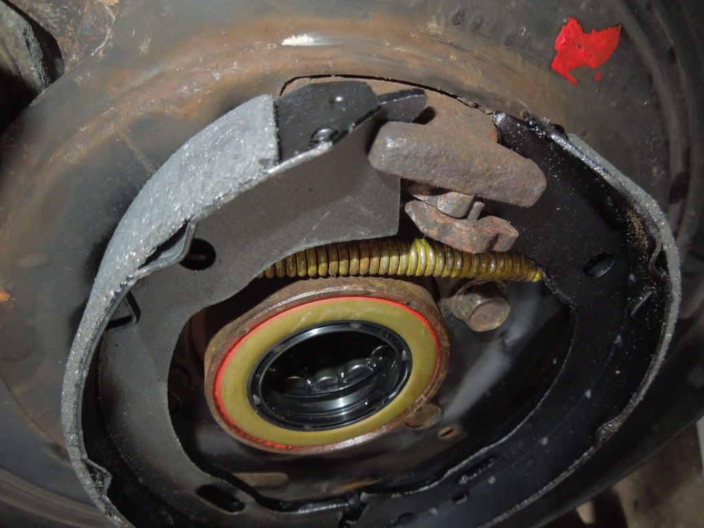

So with the drum off and the c-clips axle shafts out I pulled the old drum backing plates off.
Remove the brake hard line and four bolts at the end of the housing and the drum setup comes right off.

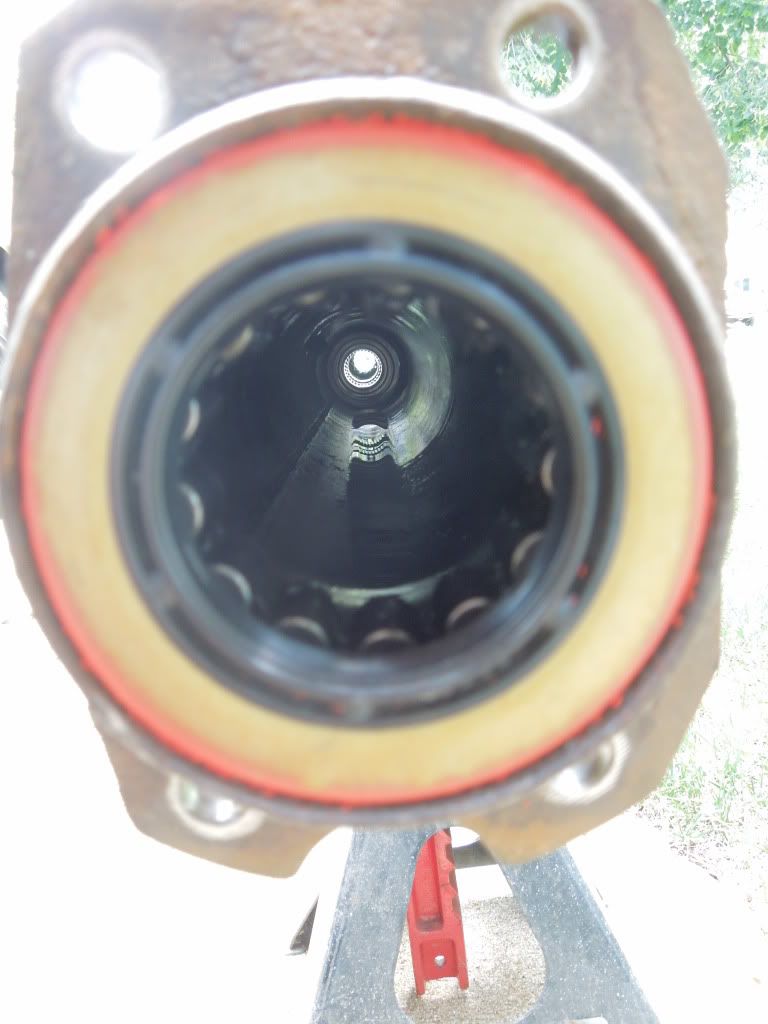

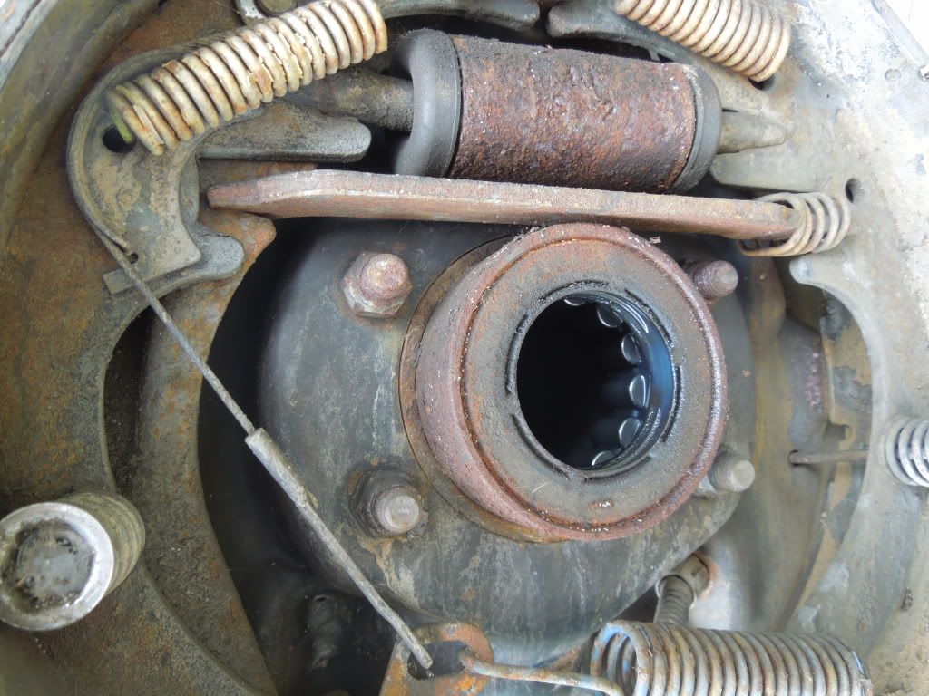

I pulled the old axle shaft/bearing seals and regreased the bearings.
Installed new seals.

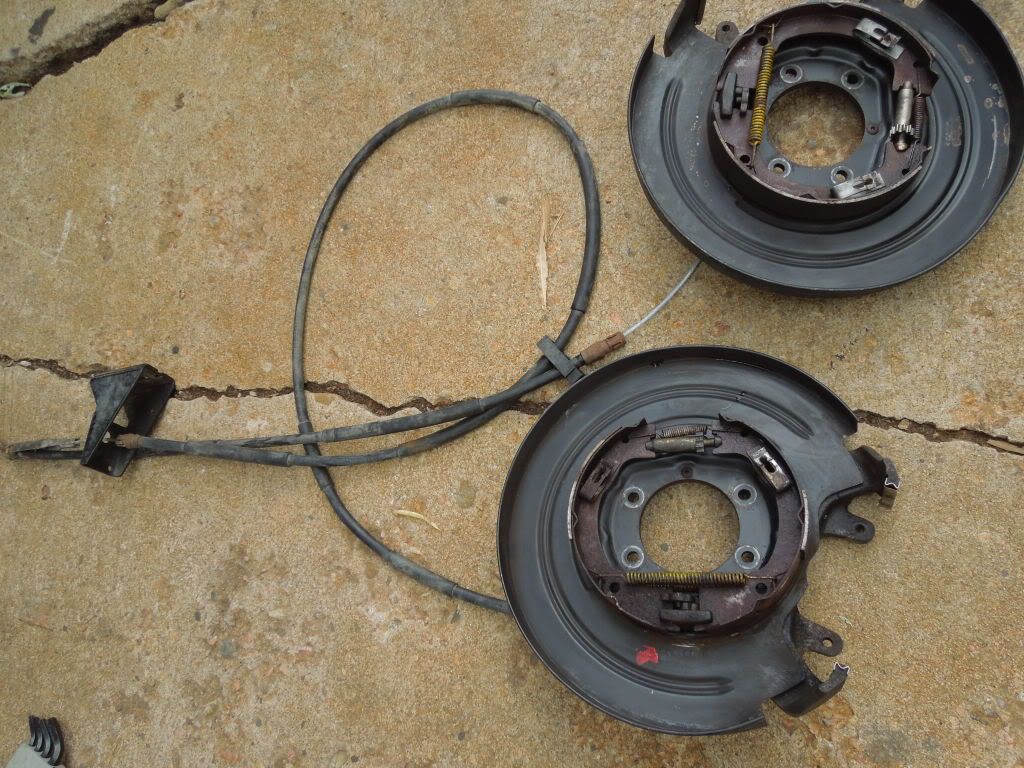

I made a trip to the pull and pay and picked up disk brake backing plates, caliper brackets, calipers, e-brake cables and a spare set of 8.8 shafts from a '98 Ford Explorer.

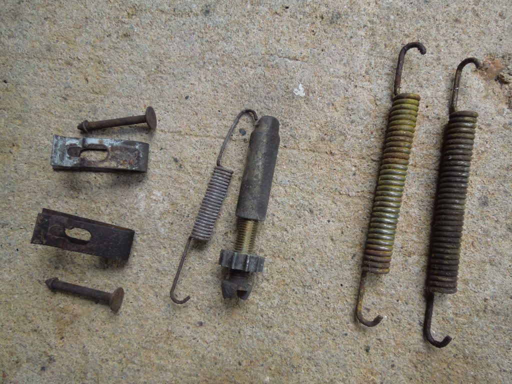

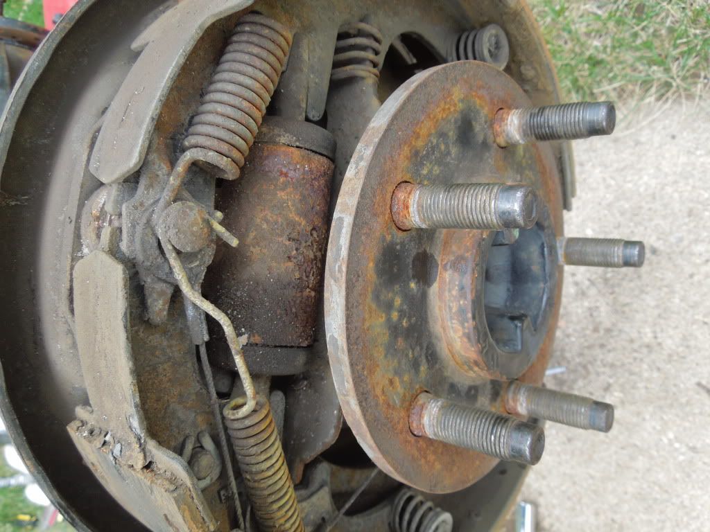

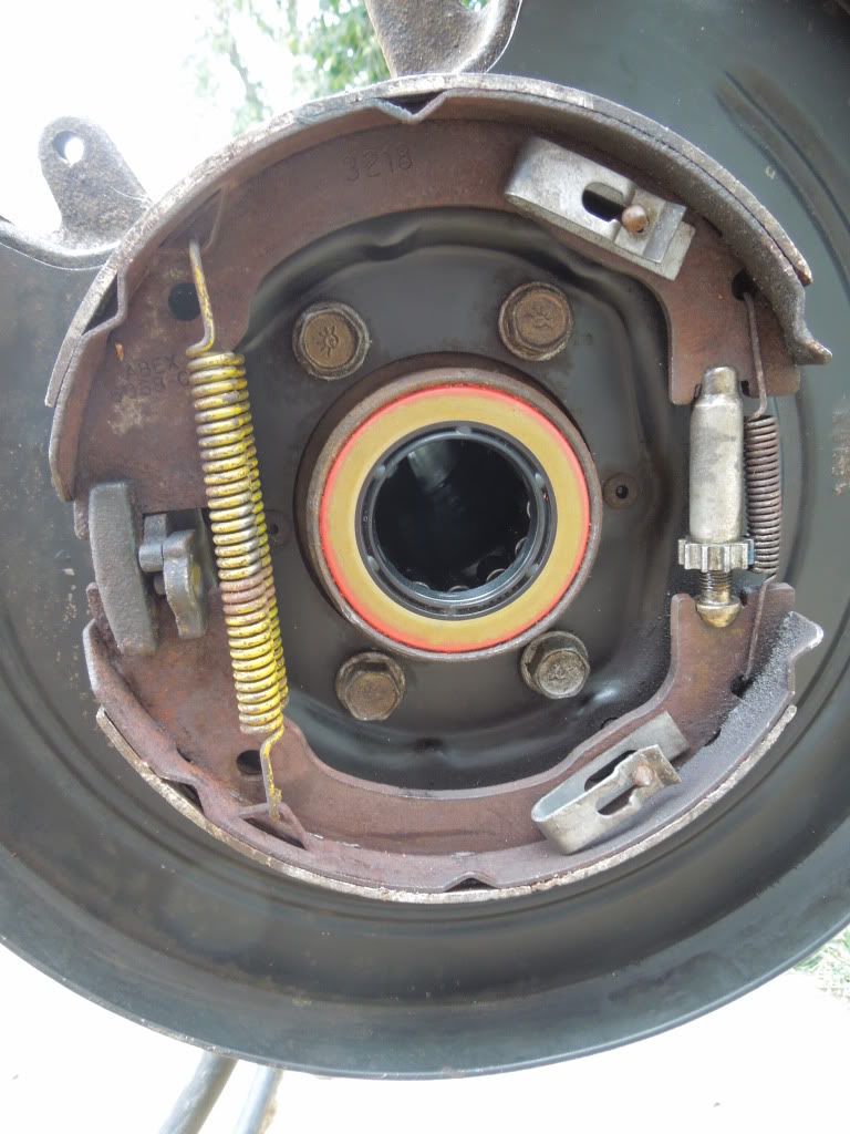

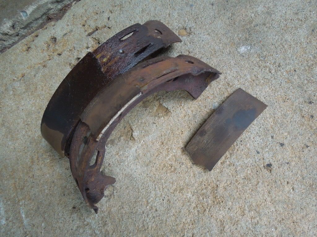

I pulled the old e-brake shoes off, since they came from a junkyard axle they were cracked and in real bad shape. First remove the retaining spring clips, then the adjuster spring and threaded adjuster(tensioner), then the large outside spring and I pulled the shoes and inside spring off as one unit.

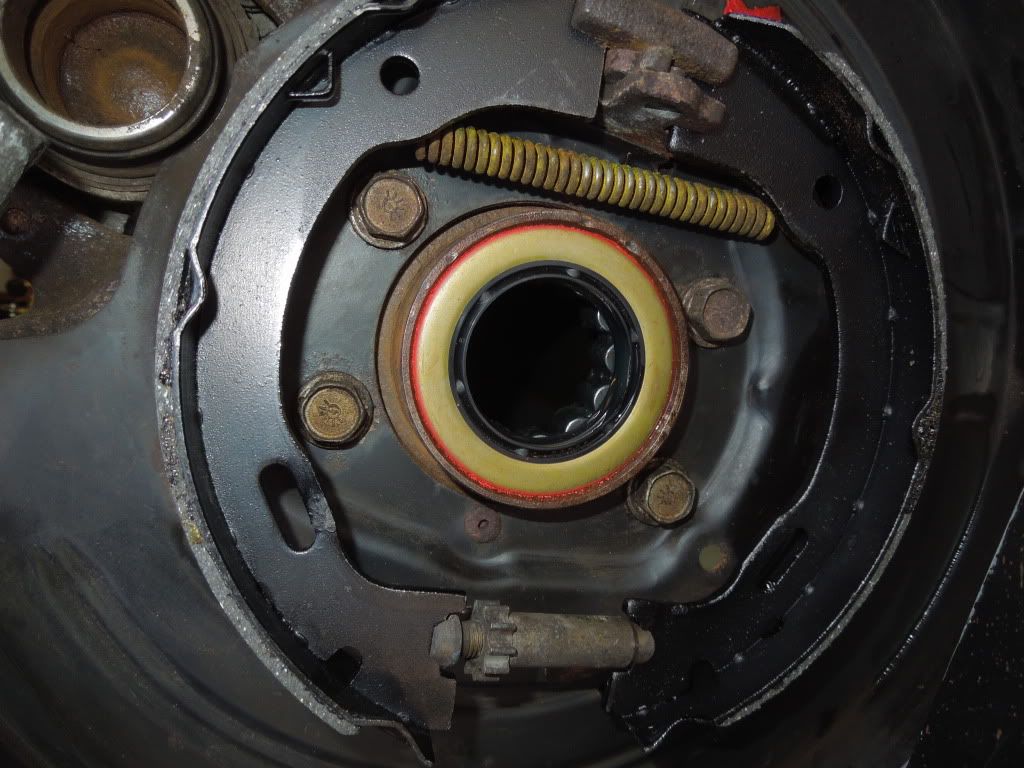

To assemble, attach large inside spring to shoes and seat the shoes onto the backing plate tab
put the threaded adjuster back in
and now re-attach adjuster spring, large outside spring and finally retaining spring clips
insert shafts and c clips

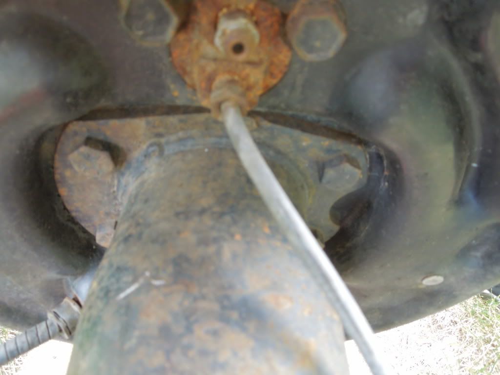

...and fit new disk rotor. If I had known this swap were so easy I would have done it a long time ago. Ill post up a pic of attaching the cables when the axle is under the truck.

Cool build. What size tires you plan on running? I like the color of the truck now. Did u use spray cans or an actual gun?
I will be running 35x12.5x15 MTR Kevlar tires.
I used spray paint, Krylon Camo Ultra-Flat Khaki, I like the Desert tan look and I will probably black out the grill and headlight bezels eventually. I used probably 10 or so cans which was about 2-3 even coats. It's not perfect but it blends fairly easily and was cheap. I did do a lot of prep work and block sanding prior to paint, and used primer in places that I went to bare metal. Should be easy to touch up as well.

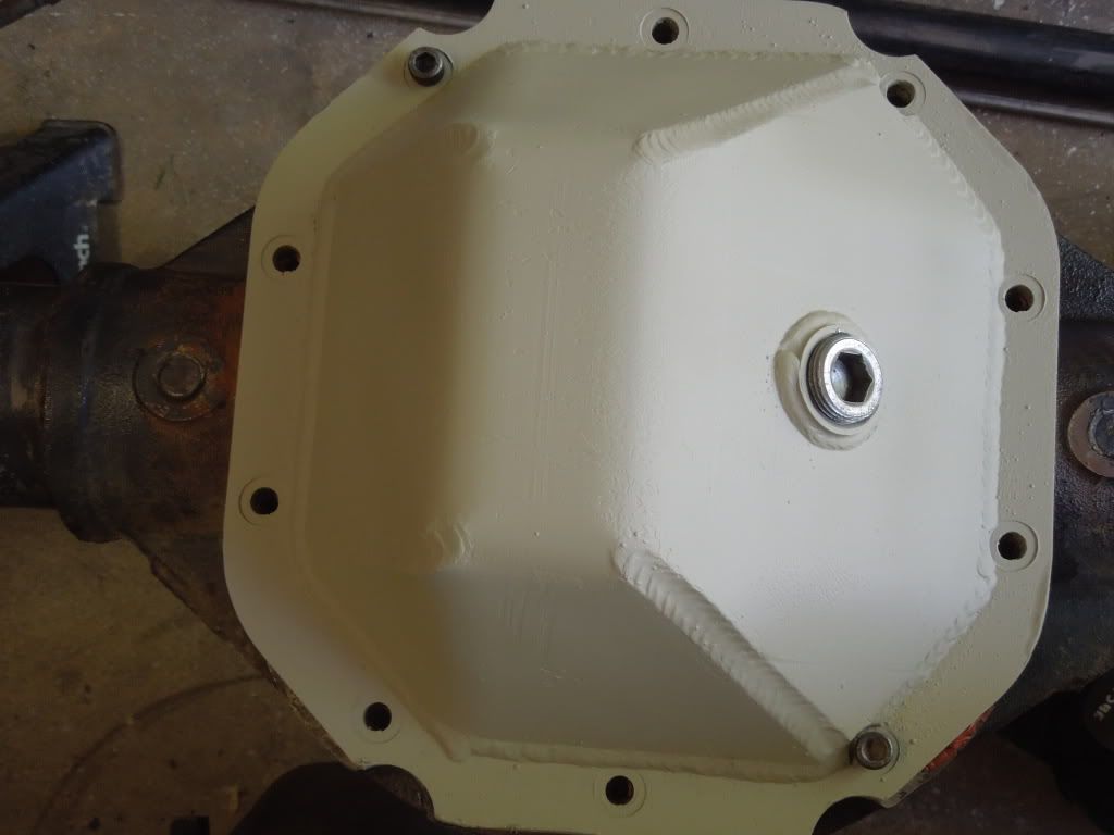

I painted my old 8.8 Ruffstuff cover to match

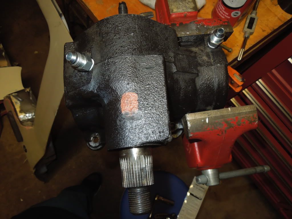

and tapped a Ranger gear box for Hydro assist.
Did you disassemble the box before drill/tapping, or did you drill/tap with grease?
SVT
I completely disassembled the box first then drilled the holes and set it in the vise for tapping. I just happened to have the sector shaft in to check clearances when I snapped the picture. I flushed the box several times to clear all of the metal shavings.
I need to do this a couple times. I also need to talk to PSC to see if my stock v8 explorer pump can handle hydro assist and hydroboost. I doubt it will, but I'm hoping a port job will give me enough flow...
