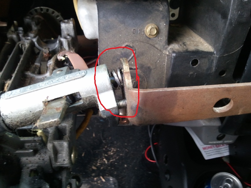

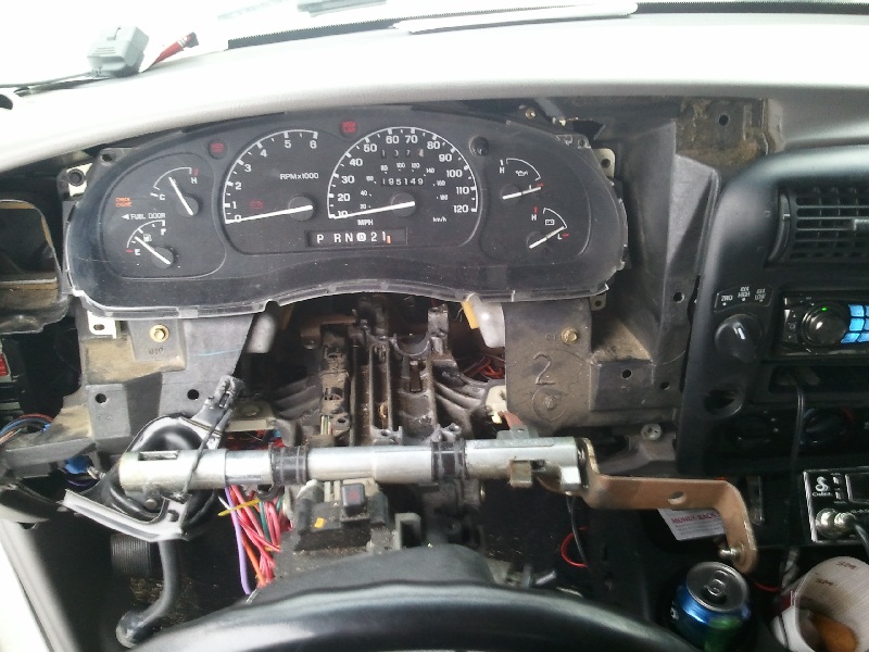

So I know its been a little bit since you posted your question Southern, but I had the same issue your having and was able to fix it this morning. I could put my truck in "park" and it would shift into reverse, and i had to put it in "1" in order to go into drive. What I ended up having to do was drop the steering column and pull out the transmission shift tube.
Once I had the shift tube off of the steering column I noticed this:
One bolt was loose, and one was completely gone. Replaced the missing bolt, added a lock washer to both bolts, put this bad boy back in, and 2 hours from start to finish (autozone run included) my shifter is now as tight as the day I bought the truck.
Let me know if you need any help pulling the steering column, its a pretty easy process if your mechanically inclined. Hope this helps!!!

Want to know something funny? I finally noticed the same thing when one of the bolts fell out and hit my foot. So I tightend both of them up and it solved my probelms.. except I didnt have to tear it all apart I crawled under and tightend it
