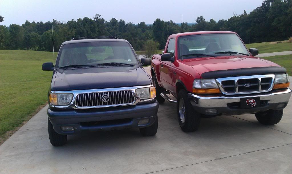

The Vehicles:
V8 Build Thread: 5.0 for 3.slow

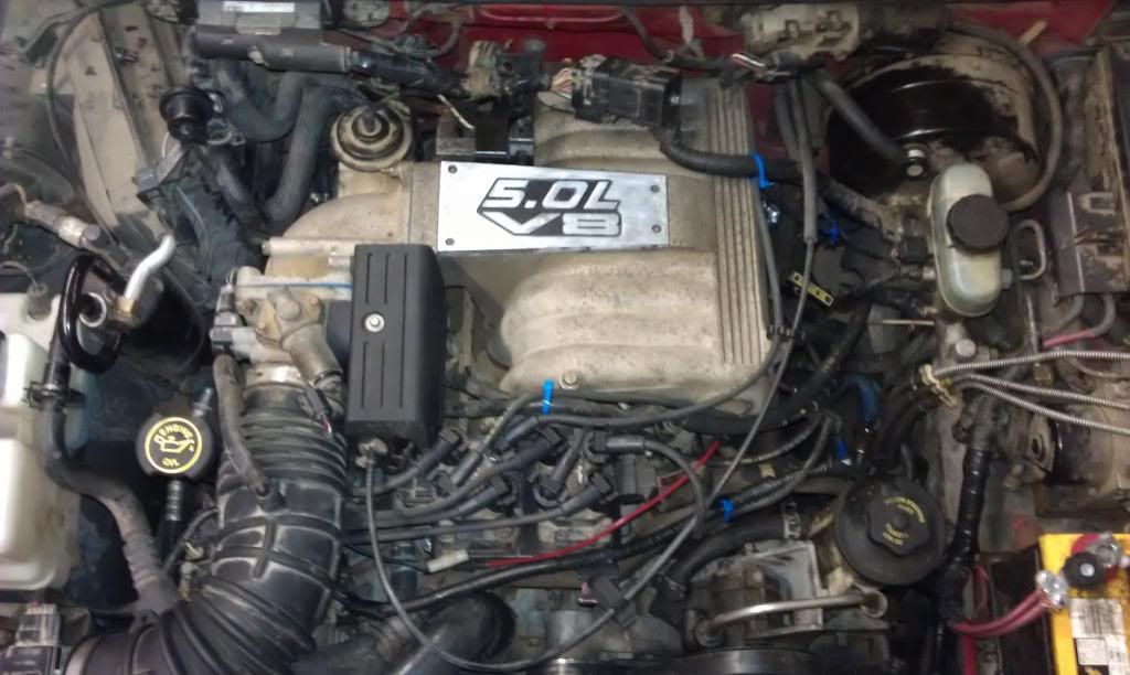

Under hood shot of Mountaineer:

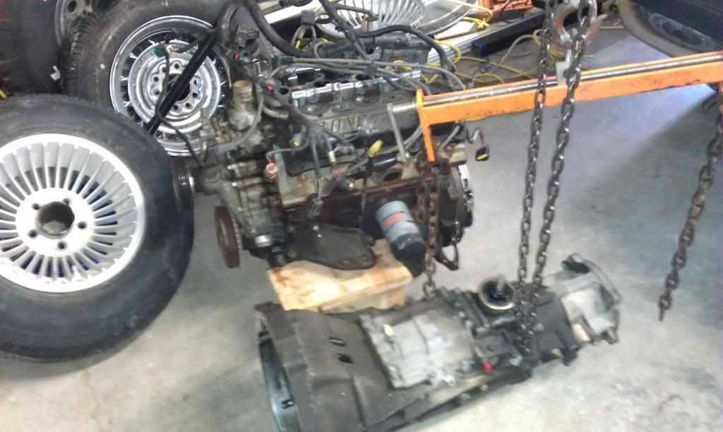

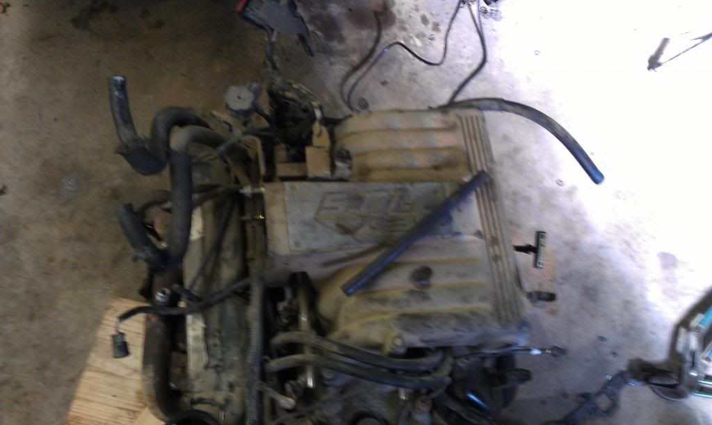

Didn't run into anything out of the blue while removing the engine. It was frustrating trying to get the exhaust out of the way, but no surprises there. Here's the engine sitting in the garage.

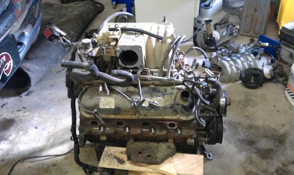

I know the engine is filthy. I'll get it cleaned up sometime in the near future. Probably after I get it running though.

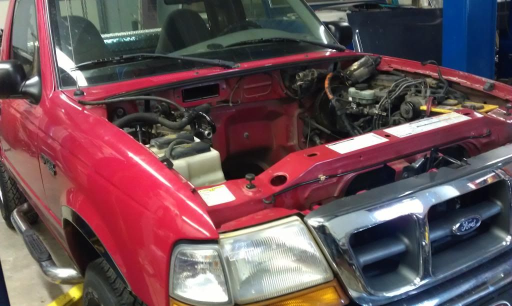

Next the ranger's drive train was removed. Again no surprises here. Just lots of rusty bolts and annoying exhaust issues.
3.0 and tranny removed:
I mentioned in my first post that I reused the 3.0L mounts. The passenger side mount is identical to the mountaineer's passenger side mount. But the driver side bolts are staggered differently.

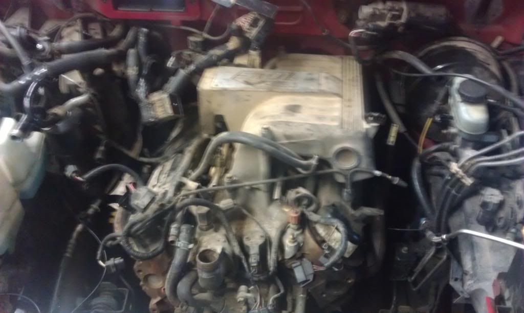

No engine:
No modifications to the firewall or anything have been necessary yet. So far the engine is sitting in the truck but nothing is hooked up. The motor mount nuts are only finger tightened. Tomorrow I'll get some more work done and keep you updated. I would be more descriptive, but I have yet to make any mods other than the driver side motor mount. Everything else has been plug and play and elbow grease.

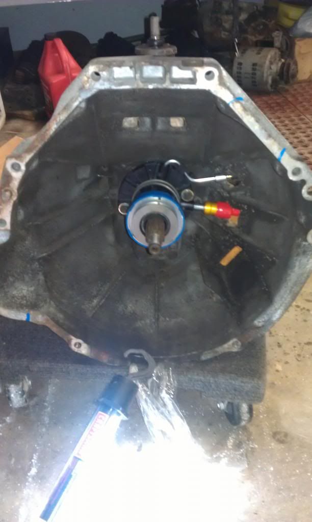

Here's the m5r2 with the new slave cylinder inserted. Turns out the m5r2 is an inch or two shorter than the m5r1:

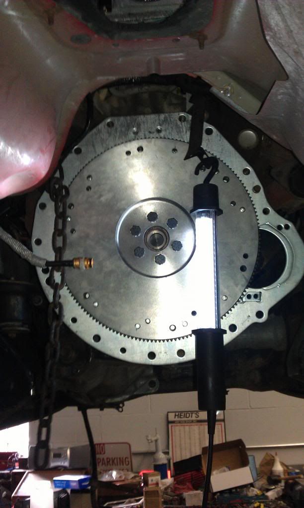

Flywheel and new block plate:

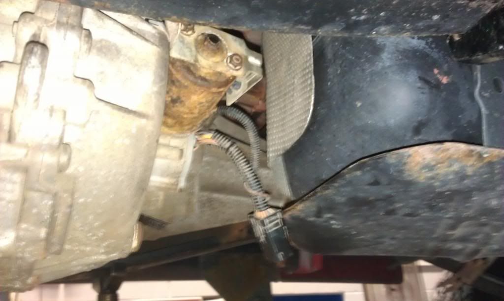

And yes, in case you didn't already know, the BW4406 will fit under a regular cab ranger with no clearance issues. Well, there is an electrical plug that comes up under the driver's seat that the case got in the way of, and we had quite a time trying to reattach it. But that was only a minor problem.

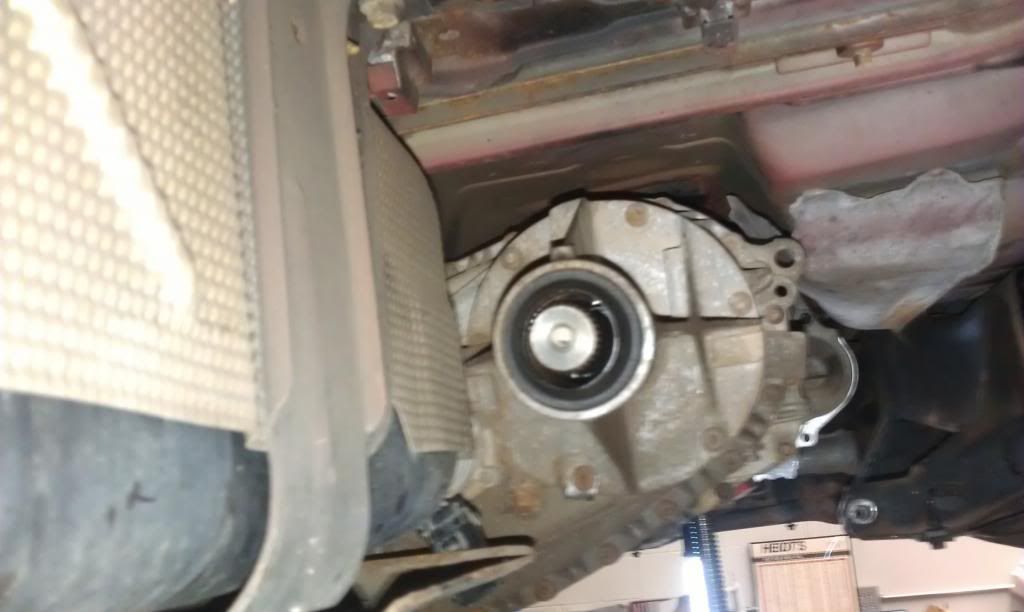

Clearance between t-case and gas tank:
Tight fit, but it's in there!

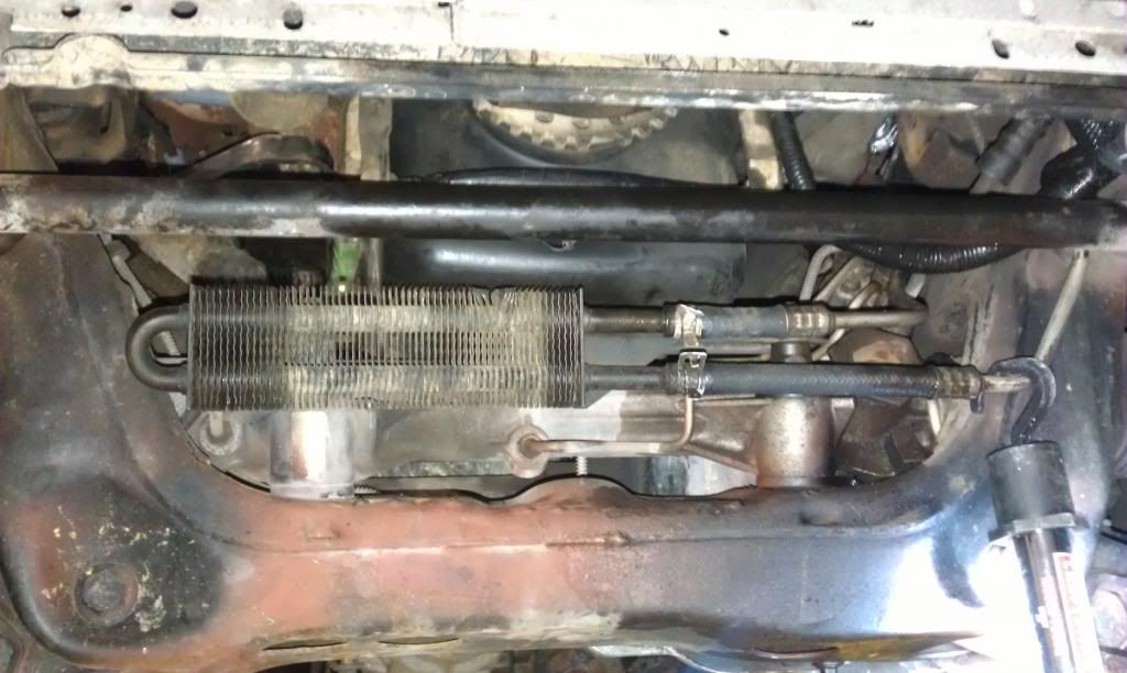

The power steering cooler will have to be moved forward slightly. No picture of this, but we almost crushed my original one while lowering the engine into the truck. It will have to be positioned so that it angles forward in order to clear the oil pan.

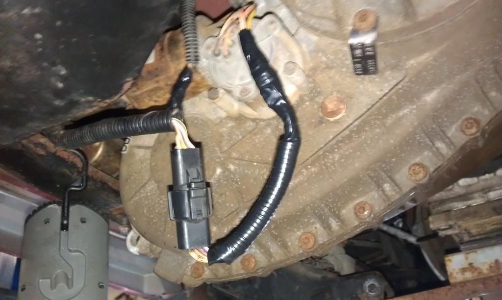

It turns out that the pinouts for my old bw1354 transfer case and the bw4406 (both electric shift. I'd like to reuse my dash switches) are the same, but the plugs don't mate. So I can just cut the old plug off my 1354 and solder it in place of the 4406's connecter, making sure to match the wire colors, and it should work just fine.

Also, the BW4406 electric shift sends the same signals to the GEM as my old BW1354, but the connector doesn't mate up. So I cut the connector off of my old t-case and soldered it where the 4406's was, making sure I matched the wire colors....and it works. It shifts into 4X4 just fine with no issues.

I swapped the entire PS cooler since it was a better fit, as well as the hoses.

Custom wiring harness for BW4406
