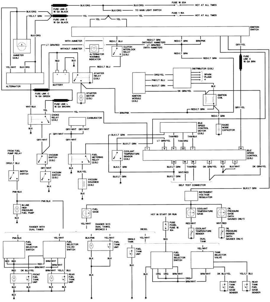

I have been working on a 302 swap in a ranger, and i'm in need of a diagram that tells me which wires are for the gauges....temp...oil pressure, I don't have the 4cyl. engine harness. the harness that comes out of the cab that plugs into the engine harness don't have the same wire colors the web diagram shows on the web, and I've googled a diagram but its for the 2.3 and mine was a carb 2.0. ![Bawling :bawling: :bawling:](http://www.therangerstation.com/forums/images/smilies/bawling.gif)
All I want is to know which wires are for the oil pressure, Alt, Temp.![Icon Confused :icon_confused: :icon_confused:](http://www.therangerstation.com/forums/images/smilies/icon_confused.gif)
