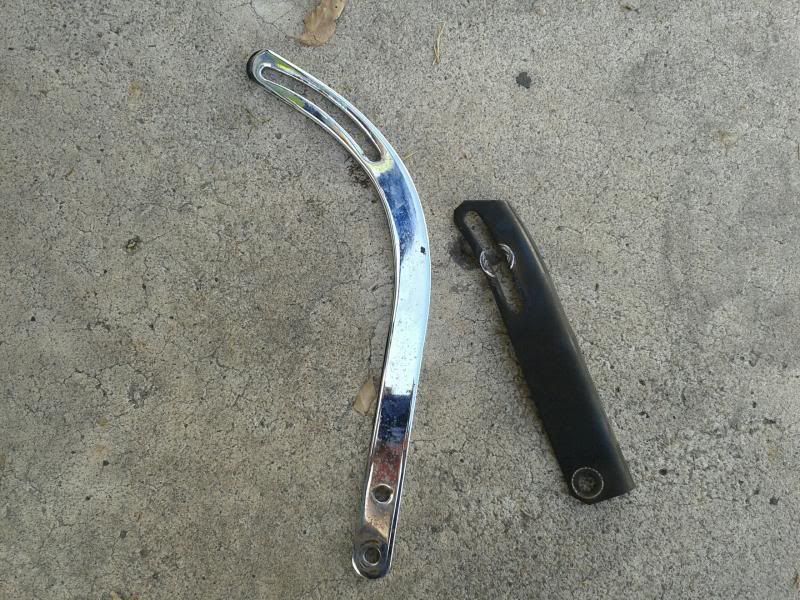

3. Remove the bolt holding the alternator bracket and remove the bracket
new bracket on the left, old bracket on the right

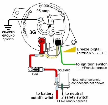

4. Take the white wire from the rectangle plug and cut it near the plug. Solder the female spade terminal to this wire.
This picture was found on Google by Twister (thanks for the help). I did not move the yellow wire from the regulator plug shown in this pic because it runs to the power distribution box already anyway.

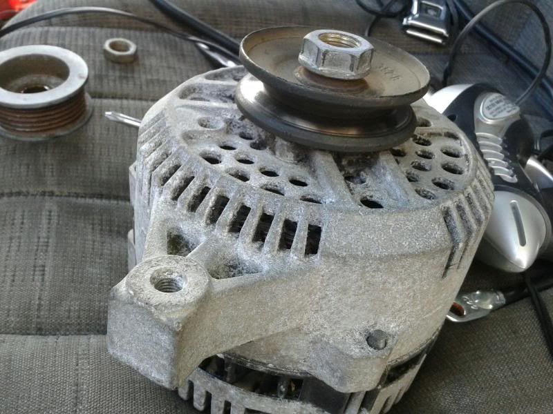

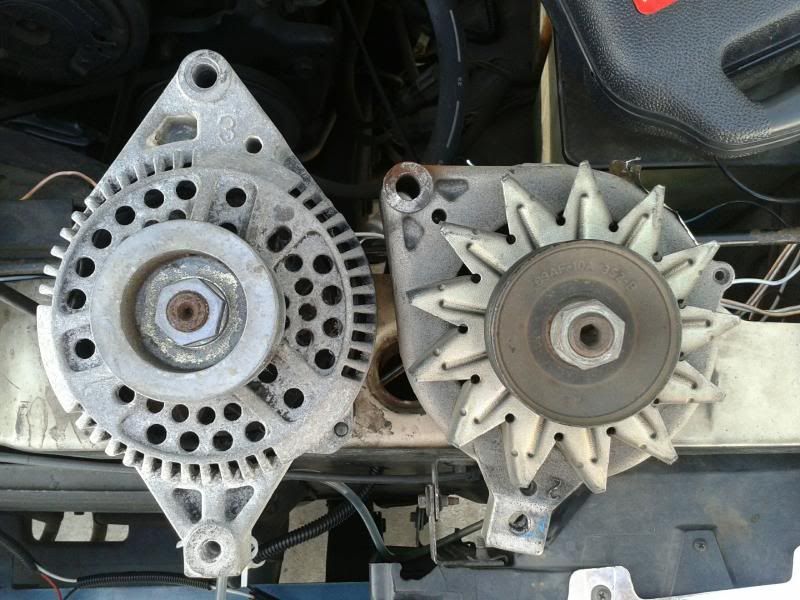

5. Take the 24mm socket and use an impact wrench to remove the nut holding the pulleys to the alternators.
junkyard 130a alternator on the left, old 60 amp alternator on the right
pulley swapped

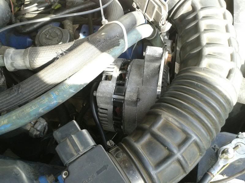

Here is the final product:

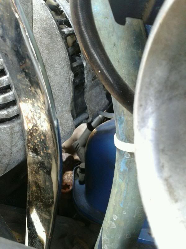

There is about 1/4 inch between the hose and bracket
There is about 1/2 inch between the alternator and the valve cover
Overall the whole swap took me about and hour start to finish. Before the swap the dash lights would dim if i turned on anything electrical. Now, I can have 2 sets of auxiliary lights, my headlights, my subwoofer and the heater or a/c full blast and there is no dimming at all. I am very happy with the swap and HIGHLY recommend it to anyone with charging issues or any electrical add ons.

I do wonder why you didn't simply adapt an alternator "pigtail" off of a 1993-94 Explorer
This pigtail includes a double fuseable link rated at 160amps and though I did my
4.0 conversion the way I did to eliminate as many fuseable links as possible, I've
never actually seen one of the "double links" on the 1993-94 Explorers "blown"
I've seen the "Singles" that were retrofitted onto 1991-92's blow when someone
ran a 130Amp alternator on a "single" link.
Last note, a 100amp mega fuse on a 130amp alternator?...
Just think on that a bit...
there is no fusible link in the system. i ran a straight cable from the charging post on the alternator to the hot side of the starter solenoid. it was easier than trying to track down the fusible set up from the explorer. also, i only used the diagram as a reference because it is using a 95 amp alternator. i actually used a 140 amp mega fuse as stated in the parts list. i chose 140 amps for two reason, i was always taught to go 10-15% higher on the fuse than the circuit will draw at max capacity. the 10% was 13amps over the 130 which gave me 143. i would rather have had a 150 amp fuse but it was twice as much and a special order at any local place. i havent had any issues with a 140 but if i do i will change to a 150 at that point.
