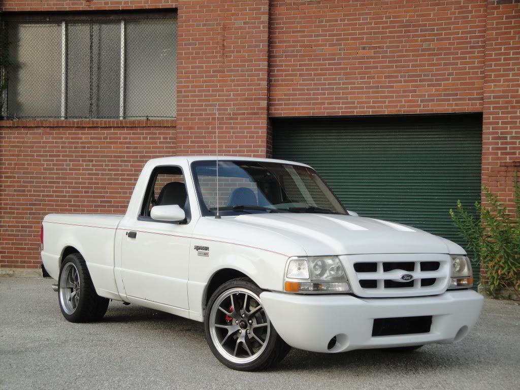

Here are your options.
Rear:
Axle flip (requires a flip kit)- 5 inches of rear drop
Hanger flip (requires hardware to replace the factory rivets)- 2 inches
Bell tech drop leaf springs (requires new leaf springs)- 3 inches
You can also get 3 inches of drop by adding 2 inch lift shackles to the flip kit, which would give you 3 inches of drop with better ride quality and load capacity than the drop leafs.
Front:
Cut your stock springs (do not drop more than 3 inches this way)- drop depends how much you cut off
DJM drop springs - 2inches
Bell tech drop coils - 3 inches
DJM control arms- 2 inches of drop
That's pretty much it. You can mix and match a lot of it depending on how much drop you want, and what your budget is. In my opinion, the dim 4/5 is the best quality, and final result. I've had it in my truck and love it. Pic for reference:
Any front drop will require an alignment. More than 2 inches will require adjustable camber bolts, and drop shocks too.
