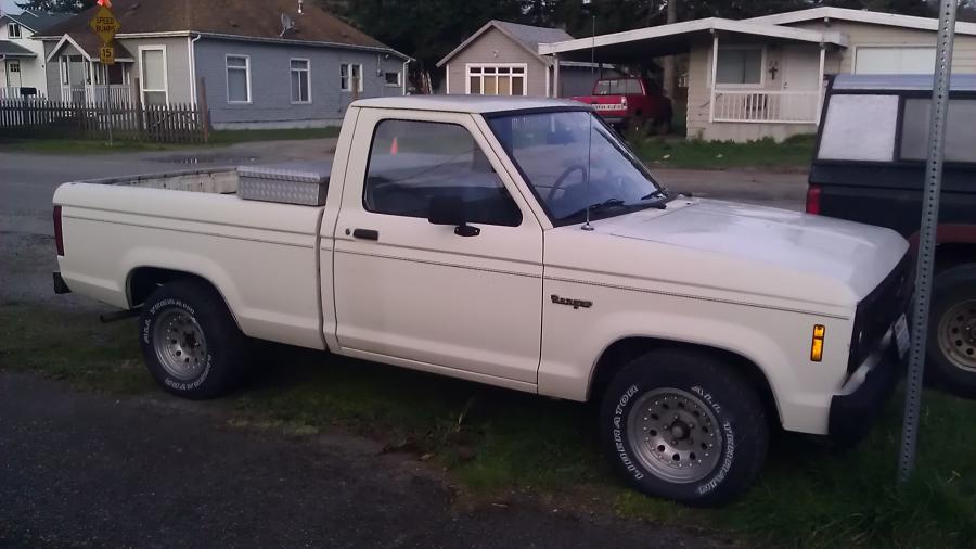

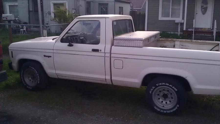

Heres the little truck i am posting about, cool little runner. slow but cool.

Very clean looking on the outside...had one like that originally but it became a game of hide and seek with the rust that I lost in the long run...
Check the firewall around the brake for rust as that was where mine finally got the better of me...actually pushed my clutch master right through one day...I guess I benched my cow a few too many times...but even that could have been repaired...
