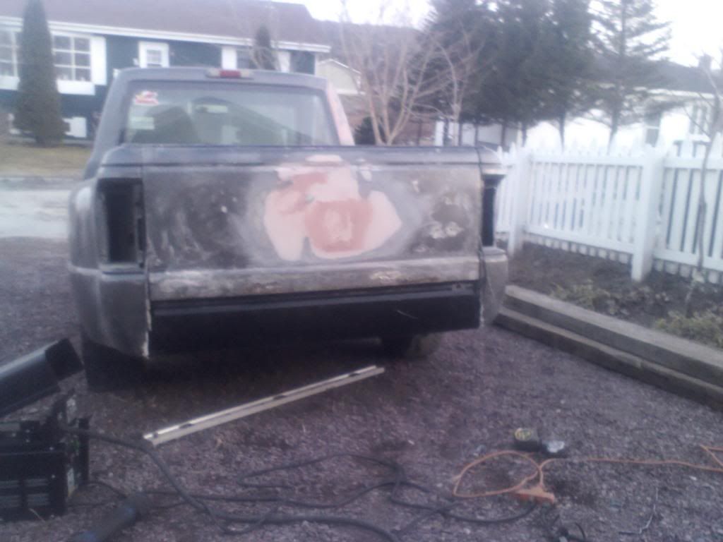

Heres a quick pic outside,but pardon the body lines to the box as i only have the box lodged on here

I then proceeded to weld a filler strip between my tailgate and roll pan and welding the tail gate on the inside, Also I had notch out the inside of my tail gate to access My tail light screws.
And after fiberglassing the seams to the glass box side and started filler and block sanding
