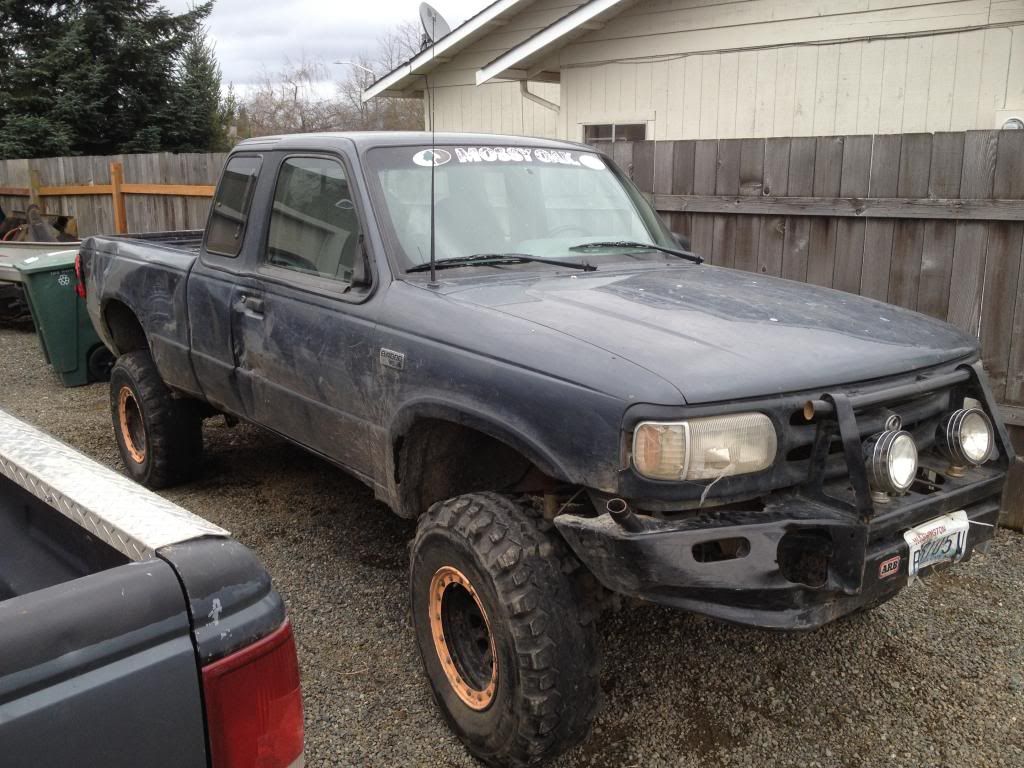

The starter truck:

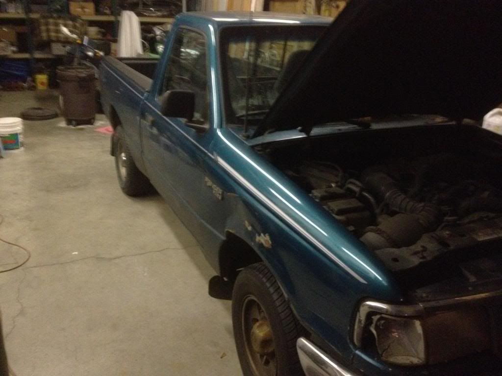

one parts truck

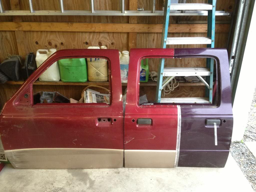

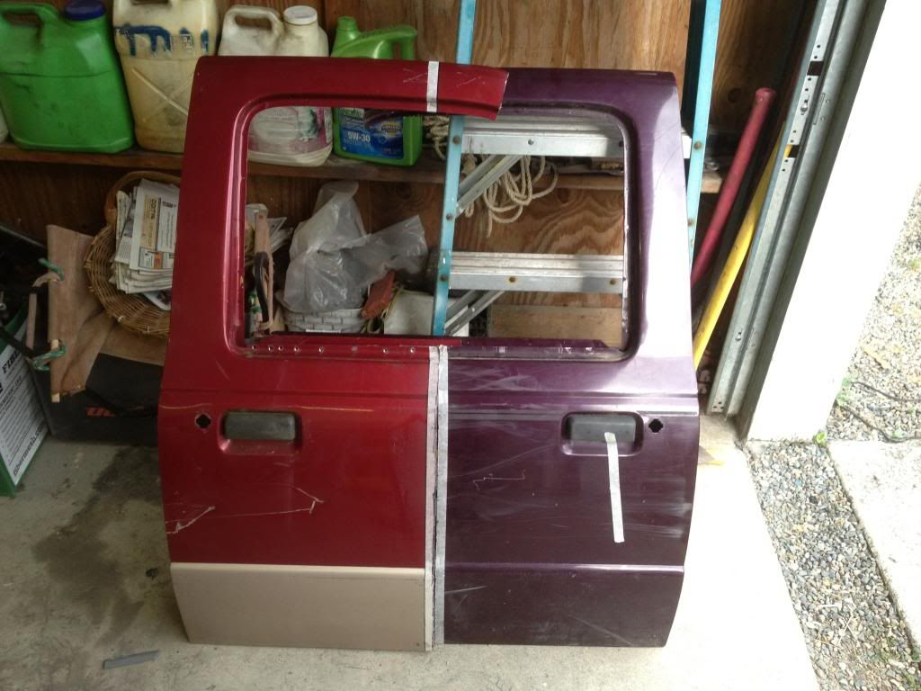

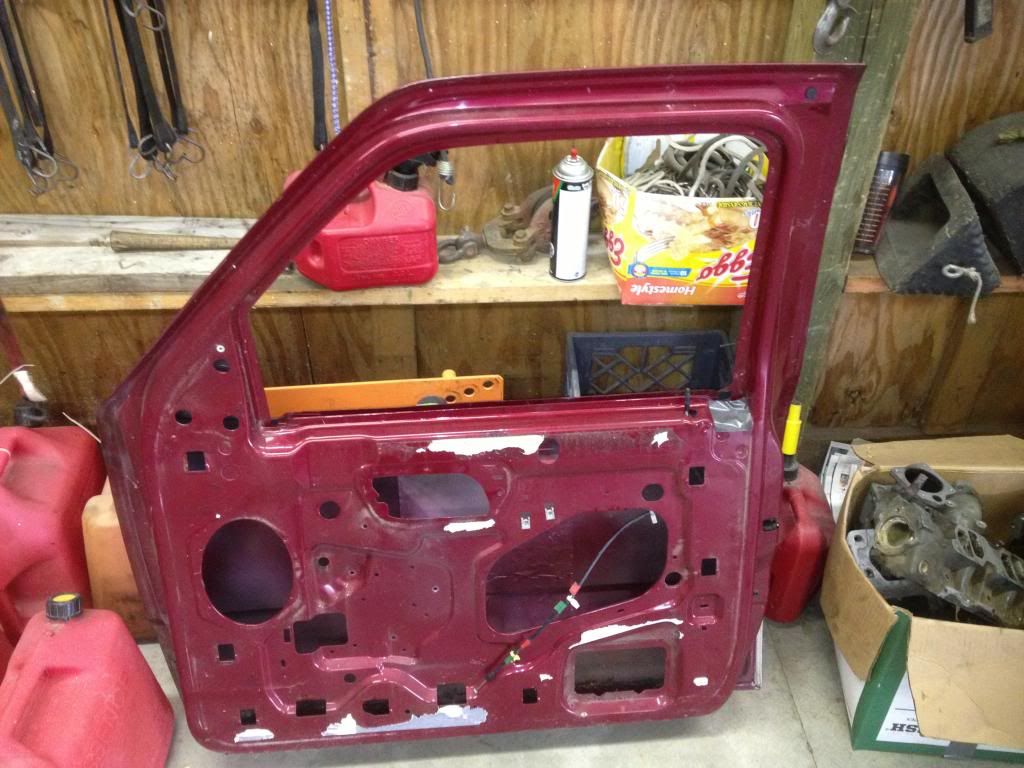

I started by cutting up 2 doors a couple months ago, just to make sure it was going to work.

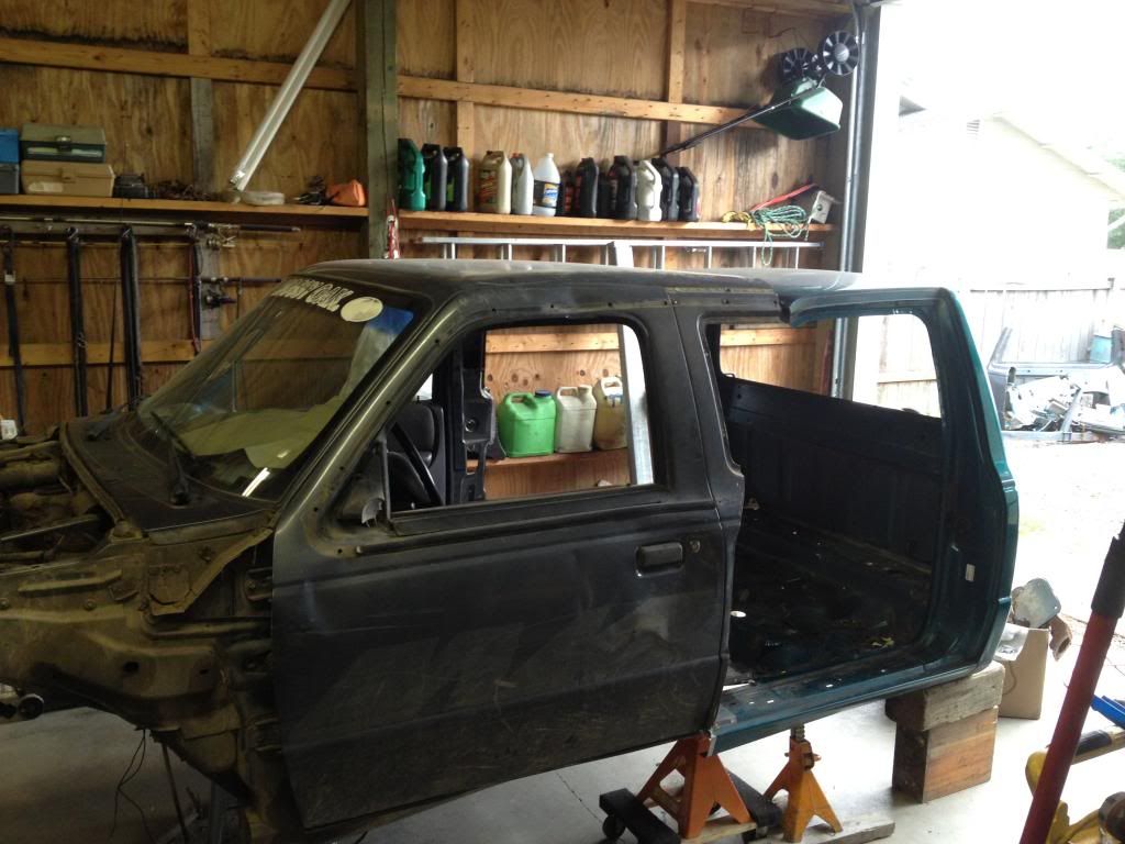

Then I brought the Mazda in, and started pulling it apart, and getting the cab off

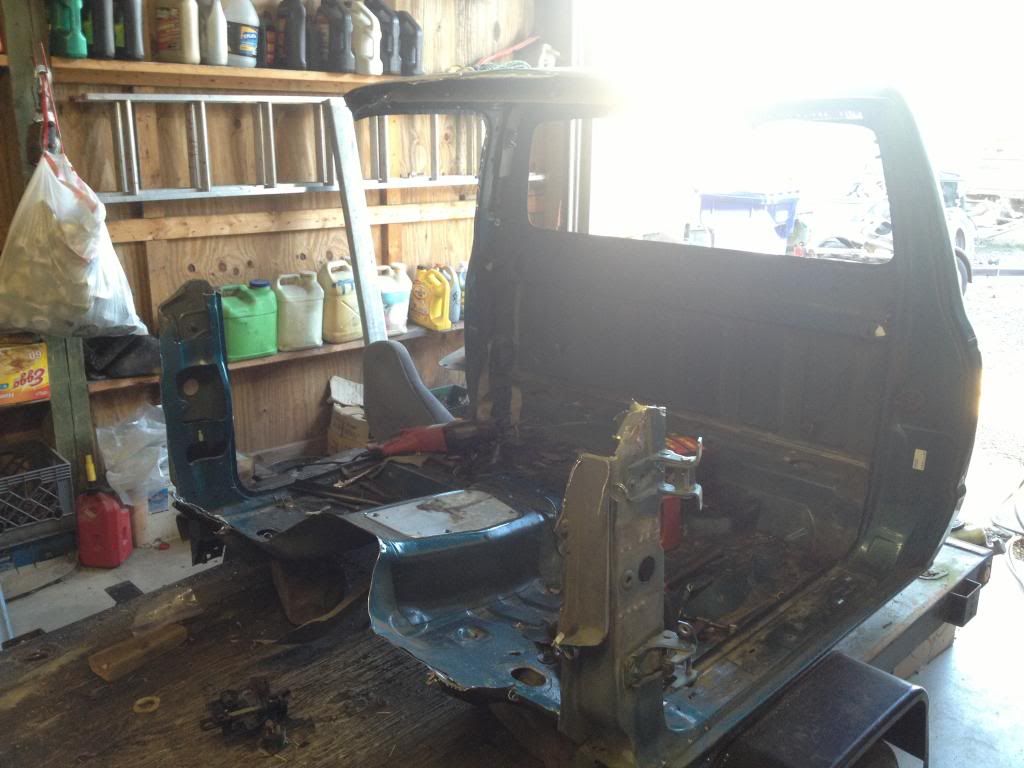

I pulled the trigger on the air hammer and sawzall a few times, and started getting the cab rough trimmed.

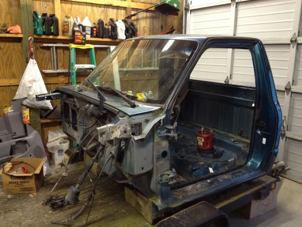

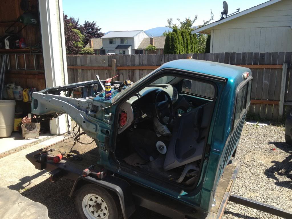

Next came the regular cab parts truck cab, which was already off the frame.
Then came rough trimming the front off of that cab, which leaves me with a core support for another Ranger, and the dash, which I'm going to try and put into the 4 door. If it doesn't work, its not the end of the world, I'd just like to have the newer dash and airbag/s.

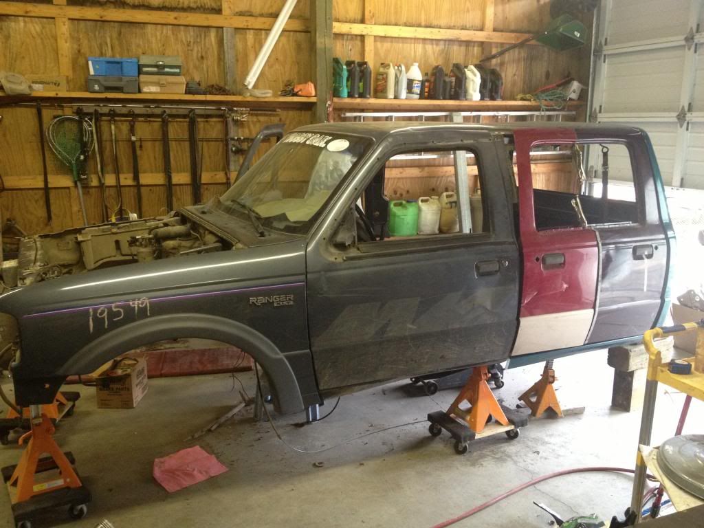

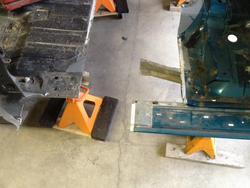

The cabs were rough trimmed enough to start sliding them together, and start further trimming.
And finally, where it sits as of today! The back door is justing held up with tie downs, so that I could tell how far the rear cab needed to come forward.
I'm not sure yet, for the gap at the top of the doors (3-4" at the top, narrowing to nothing around the body line), if I'm going to extend the front door like the photoshop, extend the rear door, or do a filler panel like a 90's 4 door F-250 would have. I'm leaning towards the filler panel.

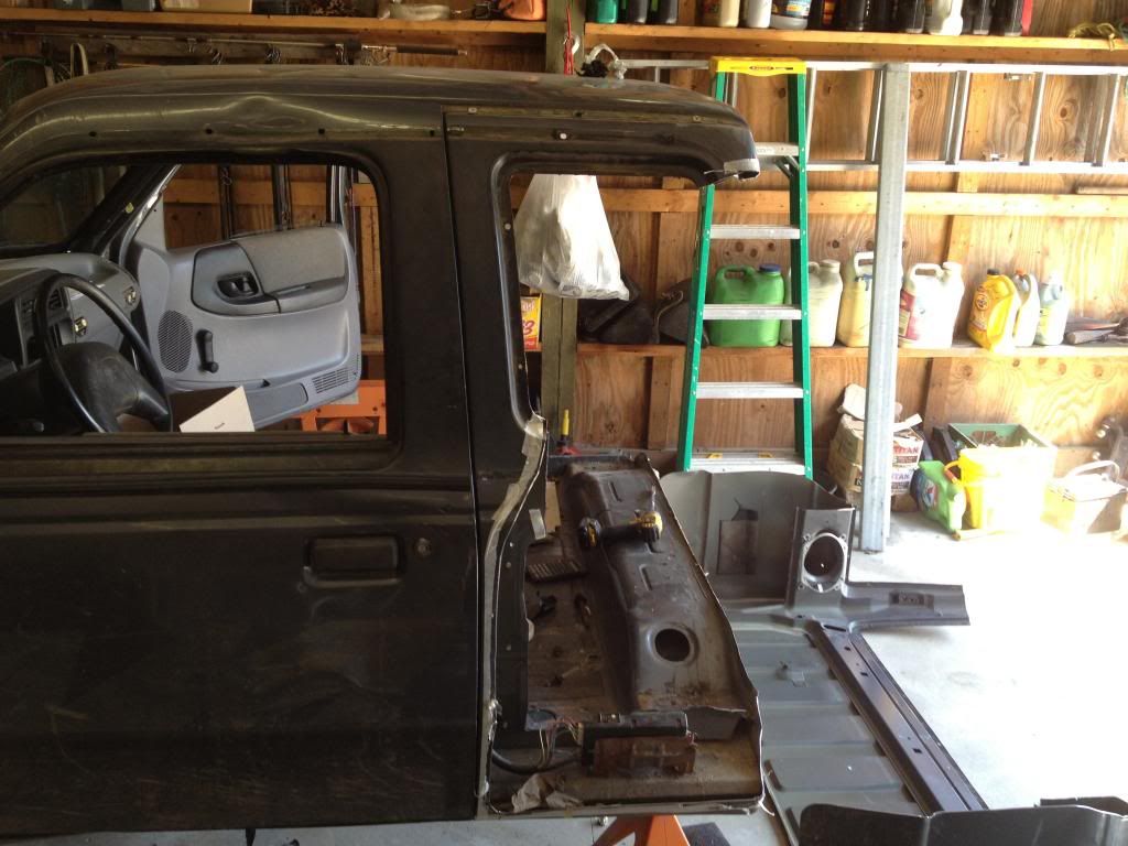

I'm almost to a stopping point until I find a cheap extended cab parts truck, because I need the rear part of the door jam, to for the back edge of the new B-pillar. I will also need the seats, possible the frame, and a few misc. interior parts. the Mazda frame is bent, but fixable, I'd just rather start with a straight one through.
