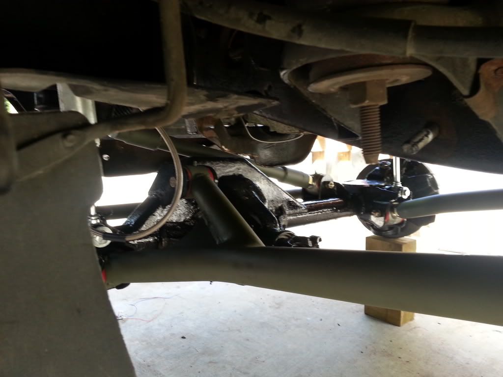

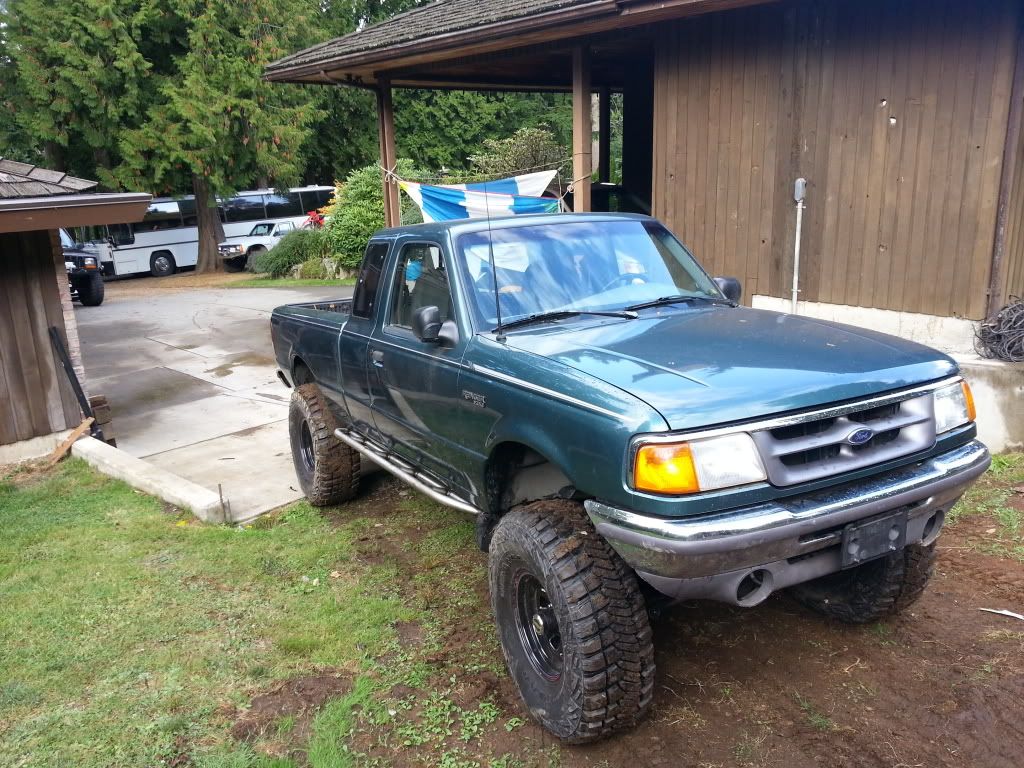

I started with a 1995 ford ranger 2wd
here are the mods.. still needs the finishing touches
1977 bronco front axle:
4.88 gears
Yukon zip locker (air)
warn premium hubs

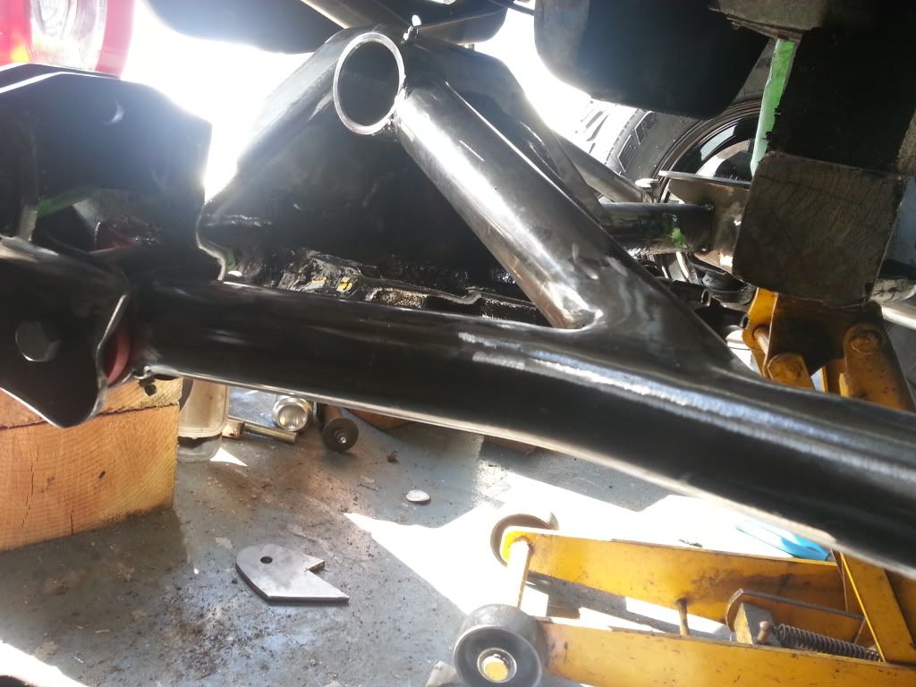

custom long are with currie enterprises johnny joints
rear axle:
out of a 1998 explorer (disc brake)
4.88 gears
arb air locker
custom forged axles made by Dutchman axles
shocks 14" bilstein 5125 front
12" bilstein 5125 back
front shock towers are early f150
arb compressor

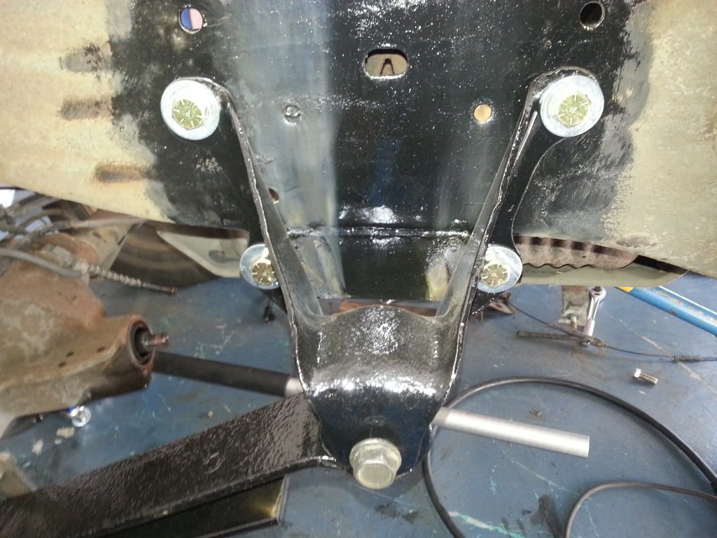

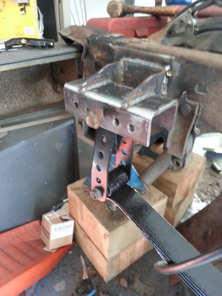

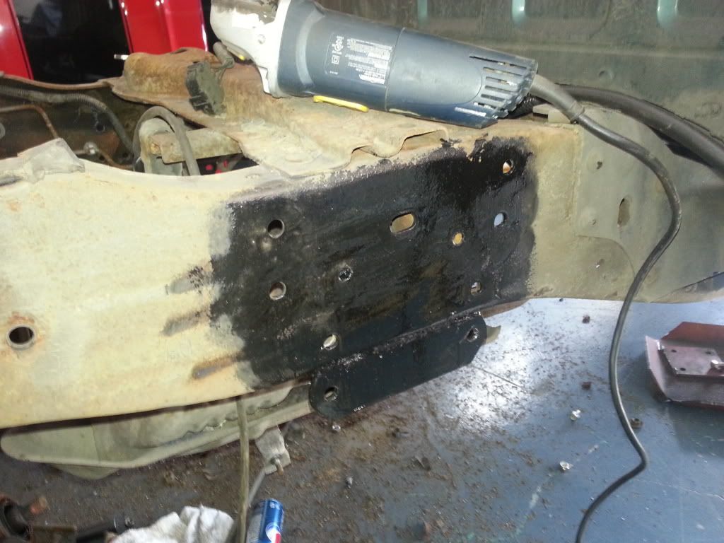

fab work:
custom front spring perches
5/16 bellypan kinda overkill but badass
for the rear suspension I made my own leafs out of ranger/ explorer packs
I dropped down the front brackets 2.5"
for the rear brackets I made them adjustable
made my own stronger 1 piece driveshaft
for tires I have goodyear wrangler 35x12.5 with Kevlar
here are the pics

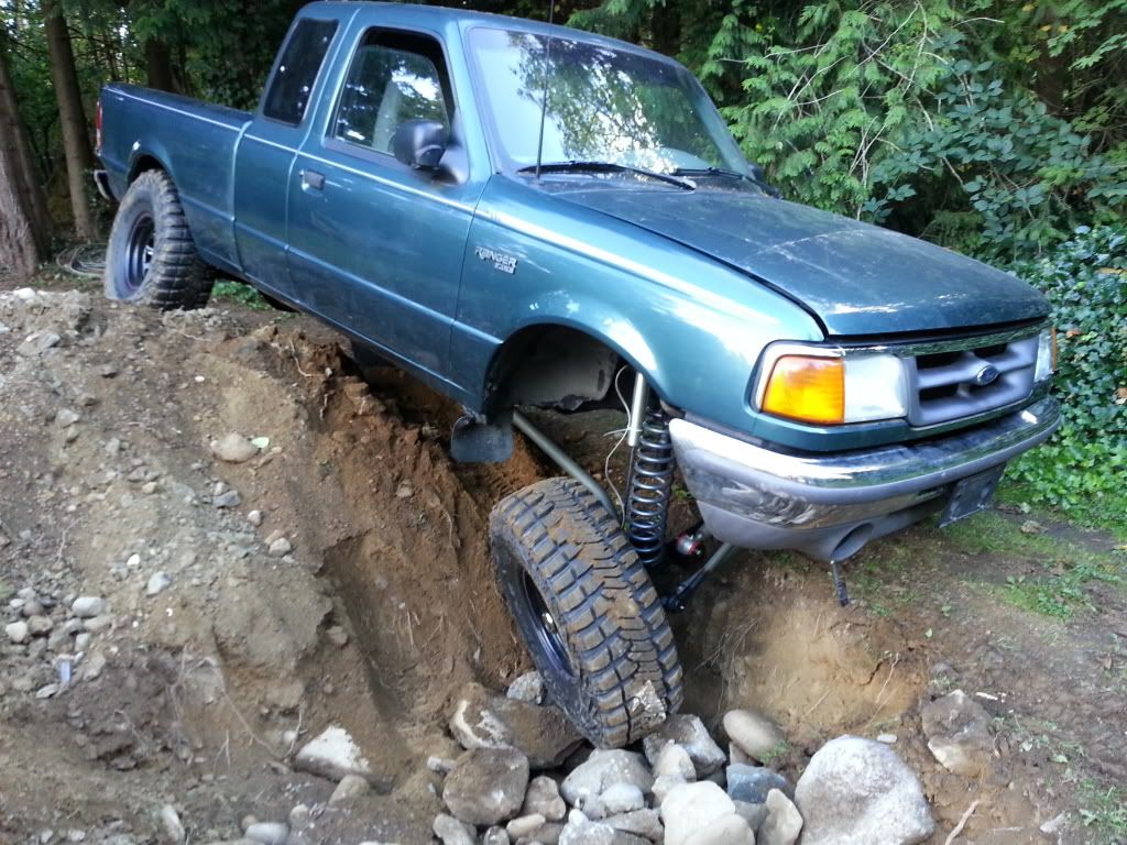

Looks good, you might want to add some limit straps, your coils are coming out of the buckets at the frame. Any future mods planned?

Those coil buckets are designed to do that. That's why there is the tubing in the middle

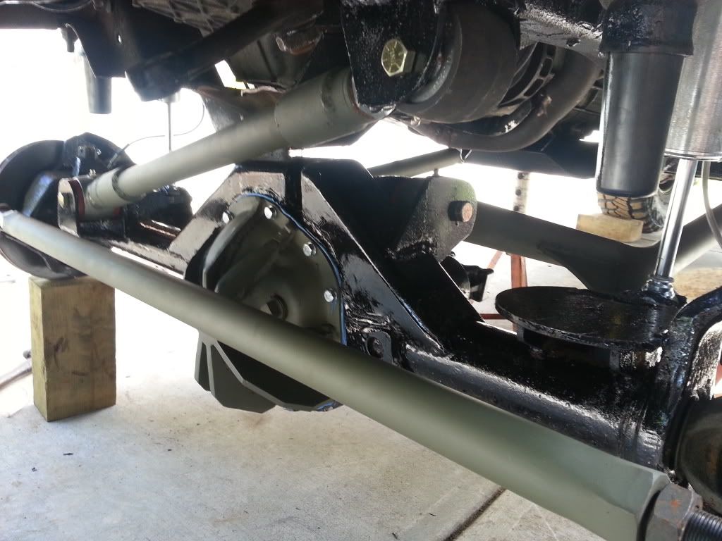

Nice truck. Did you make that front diff cover? How does she handle on the road now? without a sway bar?

yeah I made the diff cover myself. it handles ok on the road without the sway bar. I can do without it for now but I would like to have one in the future. cant go around corners too fast but that's to be expected

I went wheelin last week up by stave lake with some friends and I broke a stock front axle haha... needless to say my rcv's are on there way!

Nice set up man I was gunna go with the single radius arm set up on my exploder but ended up using early bronco arms
