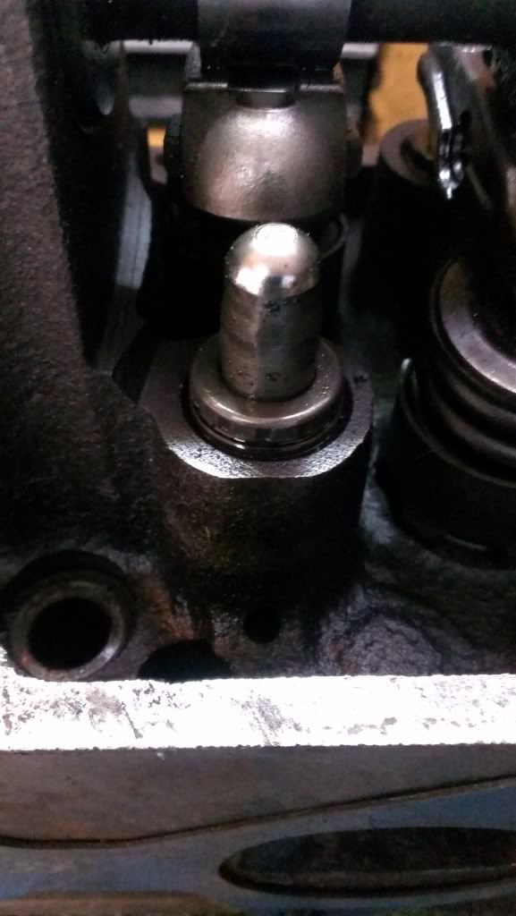

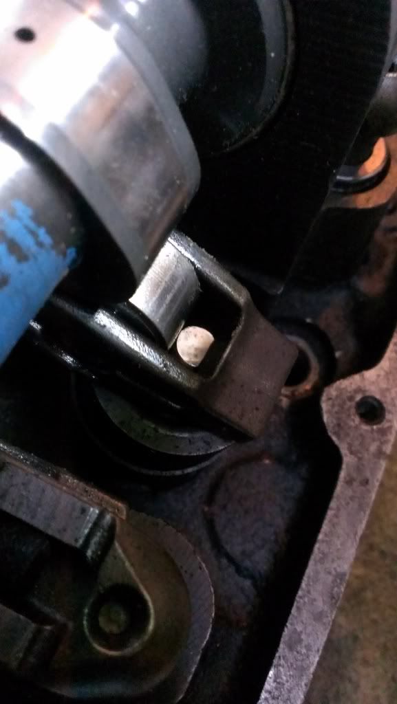

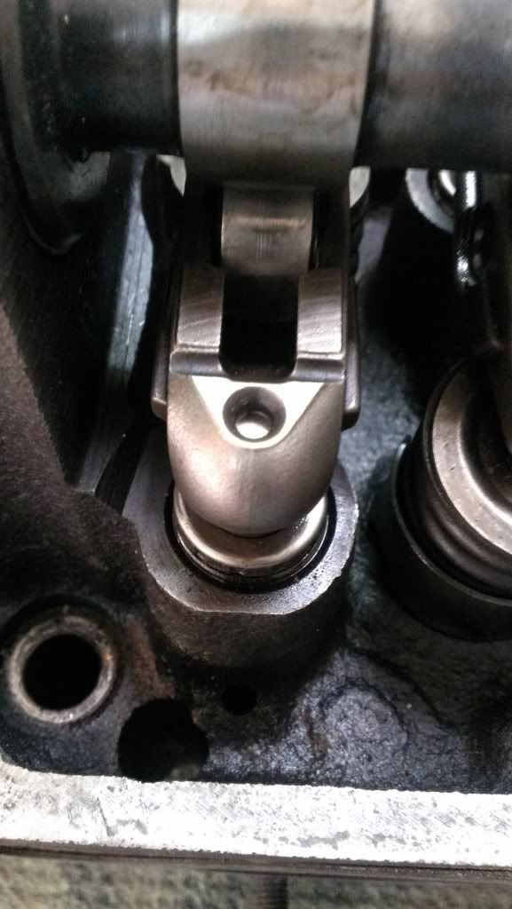

I have my 88 Stang Block pulled apart, in the middle of doing so, I found this!

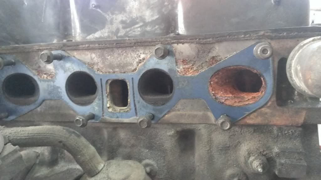

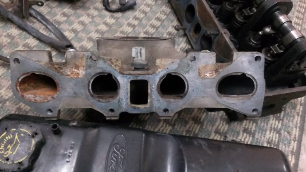

CYLINDER 4's intake runner and all looked jacked and this was also there...
This had slipped off, somehow...
I fixed it tthough, it was TOUGH to do without taking off the cam! Ugh...

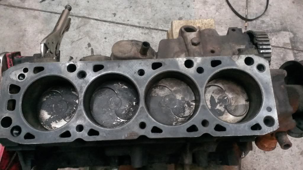

So QUESTION #1 is what was up with that? Why was it so corroded? It looked like the head gasket could've been blown on that end, but I'm not positive...? Ive cleaned it up a TON since then BUT still? The pistons looked fine!

The rust in the intake port is from water that got into the intake some how, luckily the intake valve was closed or else the cylinder would have looked like the intake port. I can't tell from the pic if the engine was run with the follower off like it was. You can run the TFI distributor, but I prefer the earlier Duraspark distributor.
Yea, figured water... I think she had a minor blown head gasket and somehow water was making it into the valve area! But not a LICK of even surface rust on the cylinder, the combustion chamber NOR the cylinder walls! (Got away w/ one! Haha! )
I'm having thE head reworked, so it shouldn't be a problem, the valve still moves freely. But that really doesnt matter when your having new, bigger valves put in, high rate springs, nice new cam, etc.... BUT, We'll find out once we get er in the shop. Thanks for your input nonetheless! I love the love of the LIMA!
