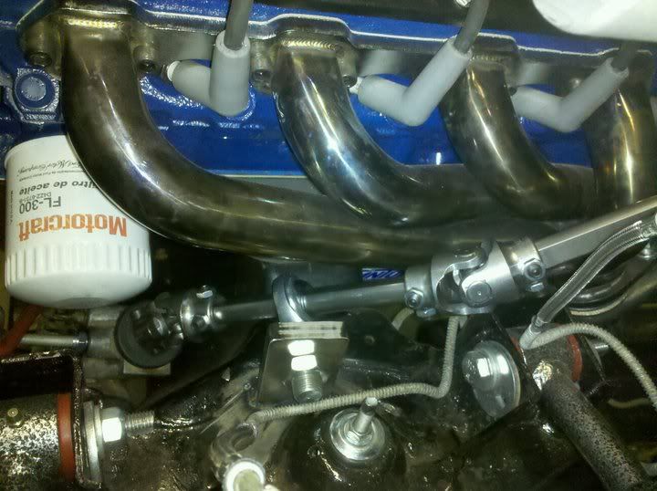

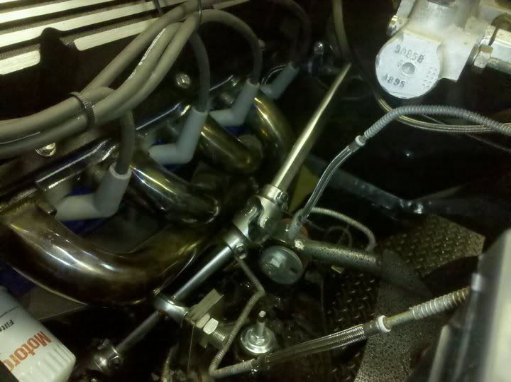

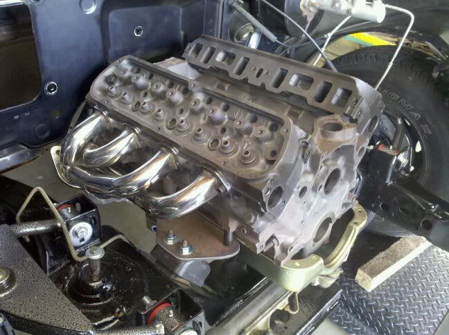

I have saved a couple of examples of different builds with headers. I know the first four are of a later model. He had to raise the motor /trans almost 2" for clearance. He used Kooks type headers. The last just show others using u-joints to clear the steering

Those are in a ttb truck, I guess I'll be figuring it out when it comes down to pulling the 4.0 out. I might end up just fabbing up my own set.

Nevermind, I just noticed the first pictures. Wouldn't I need a body lift to compensate for the engine being raised though? That's one thing I refuse to do.
