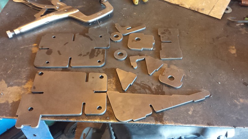

After multiple test fits and bracket mods I drew up a bracket in CAD and cut it on my Plasma table.
20150106_114522 by dresselhausfc, on Flickr

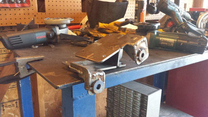

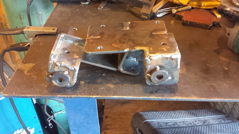

Once I assembled it taking care to make sure everything was square and aligned I welded it together.
20150106_133936 by dresselhausfc, on Flickr
20150106_133953 by dresselhausfc, on Flickr

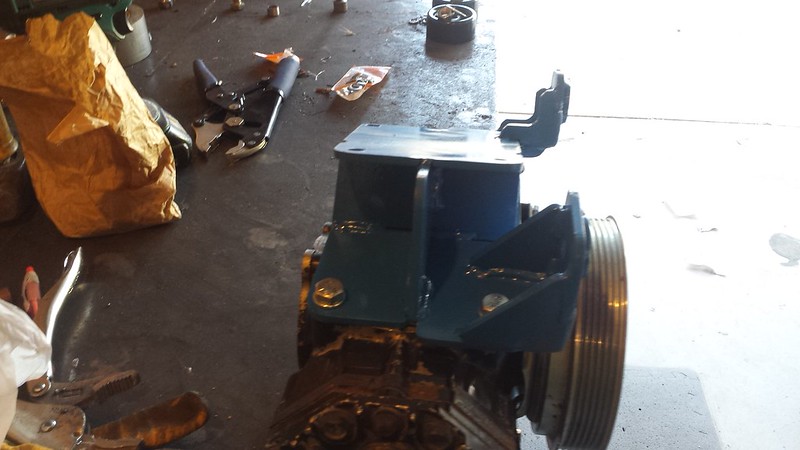

I gave it a quick coat of paint and then bolted the bracket to the York Compressor.
20150106_144648 by dresselhausfc, on Flickr
20150106_144653 by dresselhausfc, on Flickr

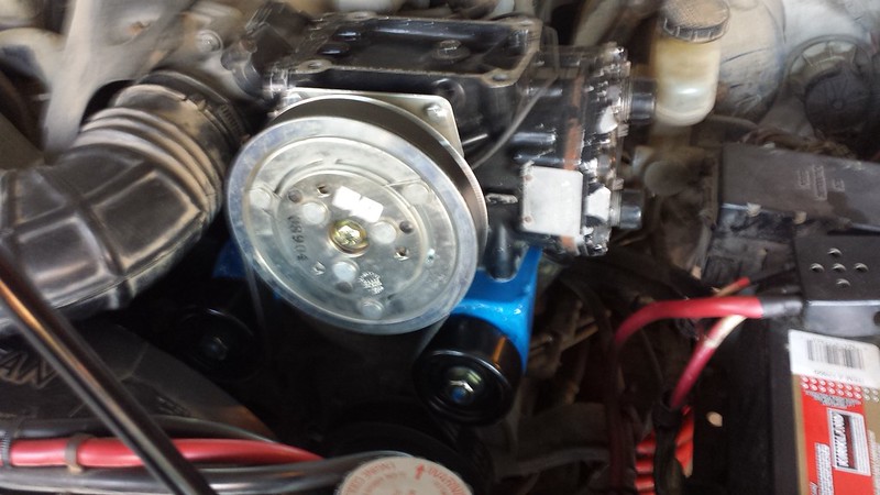

Then I installed it in the truck mounting it where the factory AC compressor was. Removing the air intake tube and throttle body made getting it in much easier. Also a ratcheting wrench is almost required to get two of the bolts in. Then installed the new belt.
20150106_155749 by dresselhausfc, on Flickr

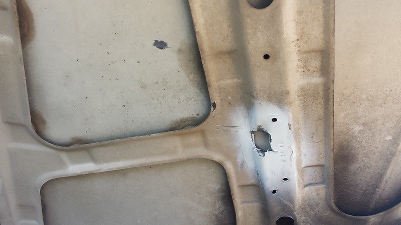

If you are not running a body lift then you will have to trim a hood support brace to allow the york to clear. I put a small dab of grease on the compressor and closed the hood. when I opened it the grease transferred to the hood showing were it hit. A trim with a grinder. After driving the truck the truck a bit I need to open the front side up about a 1/4" more but it is not much of a cut that needs to be made.

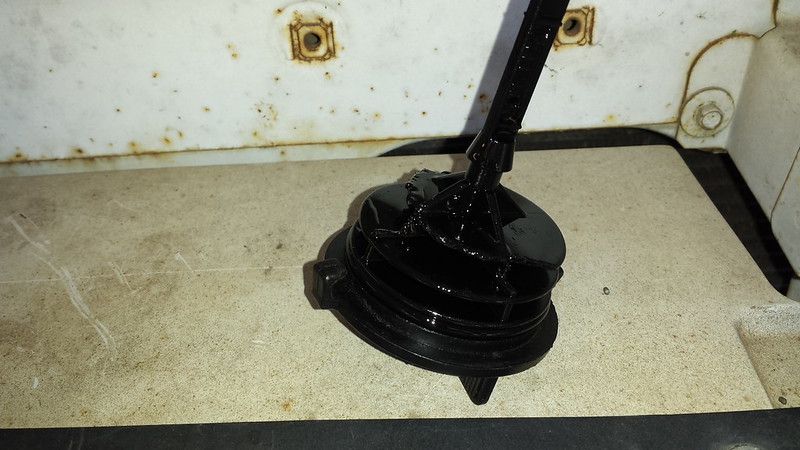

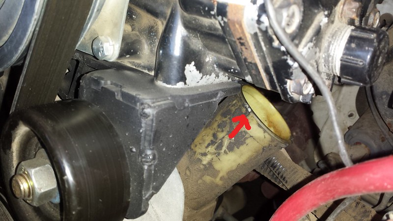

On the power steering reservoir 2 small cuts/ notches need to be made. The first is the stop on the backside. The stop that allows the cap to stop where it is removed has to be cut off to allow the cap to go past that point. Then approximately 90 degrees from there top top needs a small notch cut to allow the cap to be removed shown by the arrow in the photo.
20150607_144729 by Matthew Dresselhaus, on Flickr
To remove the cap it is turned till the side closest to the fender is able to come out. Pop that side out then rotate past the cut off stop. Then turn it to the point if the new cut out then remove the cap. With the trimming of the bottom of the cap it is able to come out. To add fluid you will need to use a funnel.
