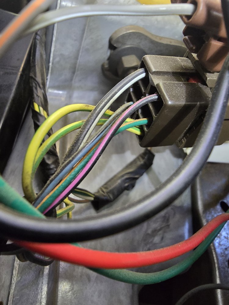

1.2- Under the dashboard: remove your kick panel and then she metal shield behind it. Check for a yelow plastic tube. This tube ends on 2 connectors, a brown one and a grey one. The grey is for the Air-Bag while the brown one is for the horn, ground and also, the C/C switches. You are prewired if this brown connector has 6 incoming wires. (See pic 2 below)

Pic 2: Connector under the dash: See the brown connector? It has 6 incoming wires and only 3 outgoing. This is that the truck is prewired on the steering column, as those extra wires are the wiring for the C/C switches on the steering wheel.
Now that we are sure our truck is prewired for the C/C, we can start mounting all the hardware on the truck.

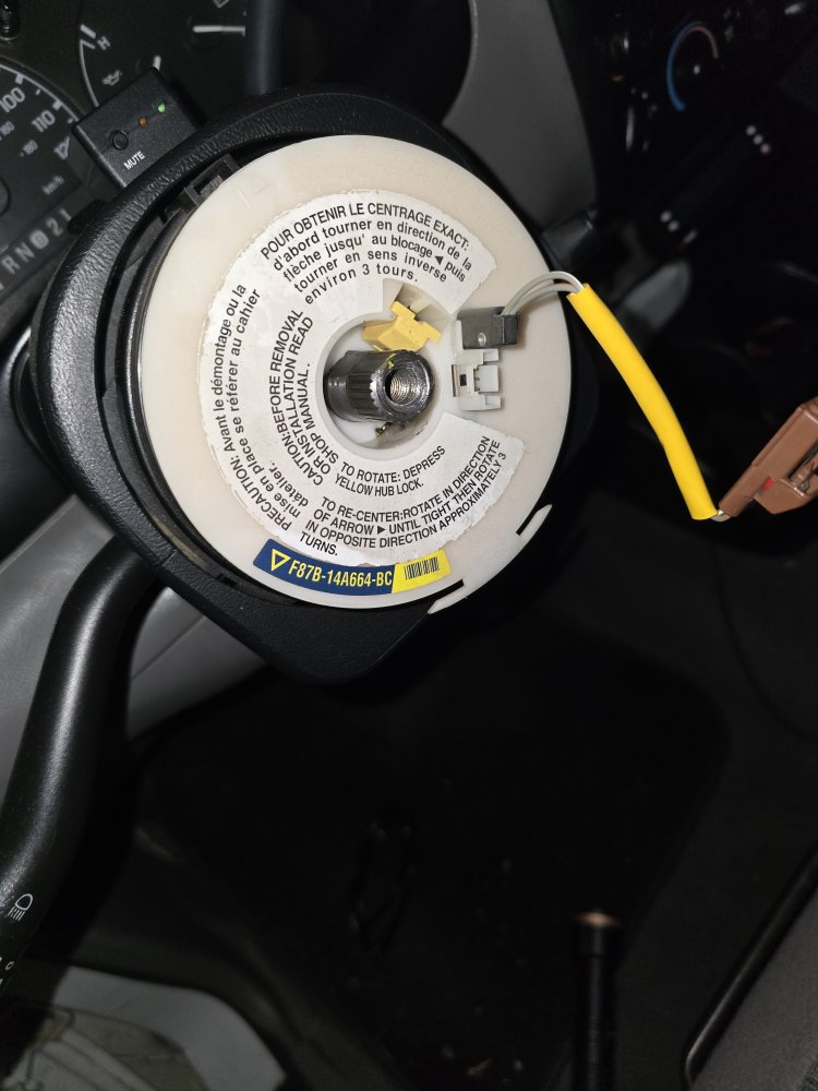

2.11- Remove the clockspring assy. There are 2 tabs on each side, pull them and remove the clockspring with the yelow tube assy. See pic 5
Pic 5: original clockspring and yellow tube on the steering column:
2.12- Once removed, put in place the new clockspring. Attach it firmly to both tabs. Route the yelow tube underneath the column, attaching all the mounting clips and also, the light blue connector on the ignition switch

Before installing the new steering wheel with the C/C switches, we have to pull the yelow retainer on the clockspring. This retainer keeps the clockspring centered and in place, so:
2.14- Pull the yellow tab and try not to move the clockspring. See pic 7.
Pic 7: yellow retaining clip on new clockspring:
2.15- Reinstall the new steering wheel. Theres a mark so you cant missalign it. Put the nut in place and tighten it. See pics 8 and 9.

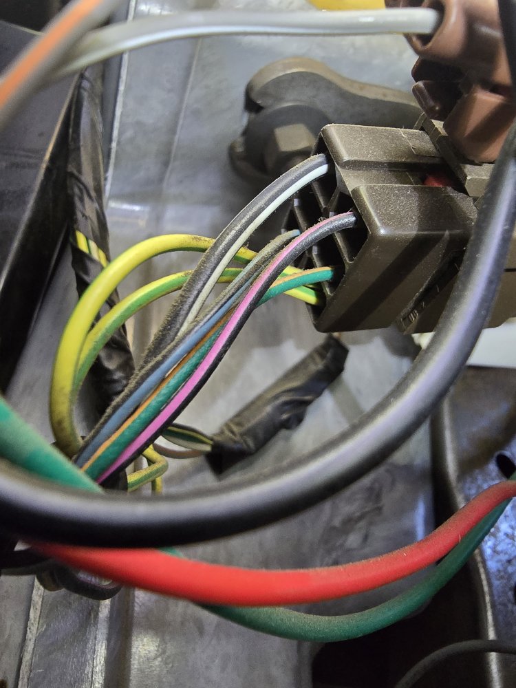

I have a 2005 edge that doesn't have cruise control. And I have a 2004 xlt with cruise control that is a parts truck. Would it be best to pull the column out of the other truck which would also give me tilt column or are they not interchangeable. Or would it be better to take individual parts? As far as being prewired I do not see a ten pin plug under the hood as shown in the pictures but I do see the wiring under the dash that was posted in the photos.

I don't know enough to give you a good answer. It should be all plug and play being only a year apart. But I never did the project, so I may be missing something.
That would be fantastic if it was. However I don't have the ten pin plug on the fender which I believe plugs into the cruise control servo. I have the servo and the plug that plugs into it from my parts truck, but I do not have anywhere to hook the wires to unless I wire it all myself.

I didn't see a different switch listed. How many wires are coming out of the connector? Try to find a wiring diagram
I have 7 wires coming out of the switch. Chilton's manual says the switch performes three functions. Depress to the floor to start, cuts speed control when pressed and provides a fuel control signal to the EEC system. Rock Auto only lists one switch. Nothing separate for cruise control. Maybe the switch is partially bad after 25 years. I will try replacing the switch.

Possibly, try to follow the wire on the diagram and see if it hits a relay or something like that. Is your cruise control servo from a manual truck?
It's the switch! It works intermittently. If I press the clutch normally it doesn't cut out. If I do a quick jab at the top it will cut the cruise.

Glad you figured it out, guess you need a new switch

I have 2000 ford ranger xlt that didn't have cruise control. I am adding cruise control to the truck and have all necessary prerequisites to be considered "prewired" i hope. I'm am a little iffy about the brown connector that connects to the clock spring. I have 6 incoming wires but I have 2 lightgreen/yellow wires in one slot. Am I still "prewired". I have the connector for the servo, I have the connector for the deactivation switch on the master cylinder.
Agarza34
Dec 21, 2024
13
Reaction score
1
Location
California
2000
Make / Model
Ford Ranger XLT
I have 2000 ford ranger xlt that didn't have cruise control. I am adding cruise control to the truck and have all necessary prerequisites to be considered "prewired" i hope. I'm am a little iffy about the brown connector that connects to the clock spring. I have 6 incoming wires but I have 2 lightgreen/yellow wires in one slot. Am I still "prewired". I have the connector for the servo, I have the connector for the deactivation switch on the master cylinder.View attachment 121388
This is my current clock spring, I only have 3 wires coming out from it. I ordered a newer clockspring from ebay with the part number "1998-2005 F87B-14A664-CC OEM" the newer clockspring has 6 incoming and outgoing wires.
Please tell me I'm prewired and just need the clockspring to complete my install

Should be, don't remember what it looks like on mine
