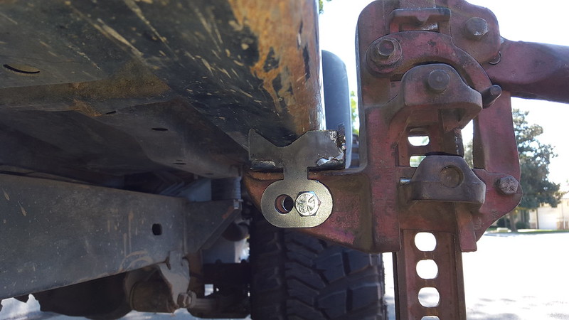

One thing most wheelers carry is a hilift jack. It seems like every time it is used the jack has a tendency to slide on the sliders and seems very unstable. I built the bracket below to help grab onto my sliders and hopefully make it more stable.
Here is the bracket.
20150901_134556 by Matthew Dresselhaus, on Flickr

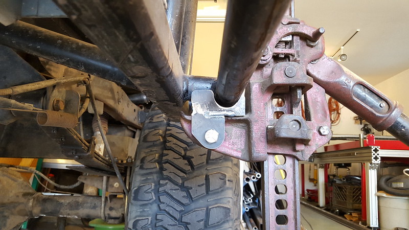

It mounts onto the jack with a 1/2" bolt holding it to the jack.
20150901_134829 by Matthew Dresselhaus, on Flickr

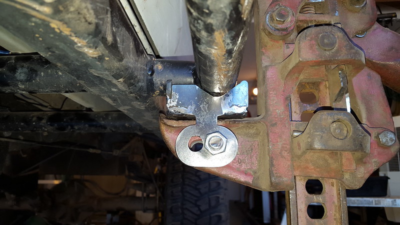

Here is how it latches onto the sliders. Mine are 1.5" tube. I forgot to account for the weld on the back side so version two will be changed there.

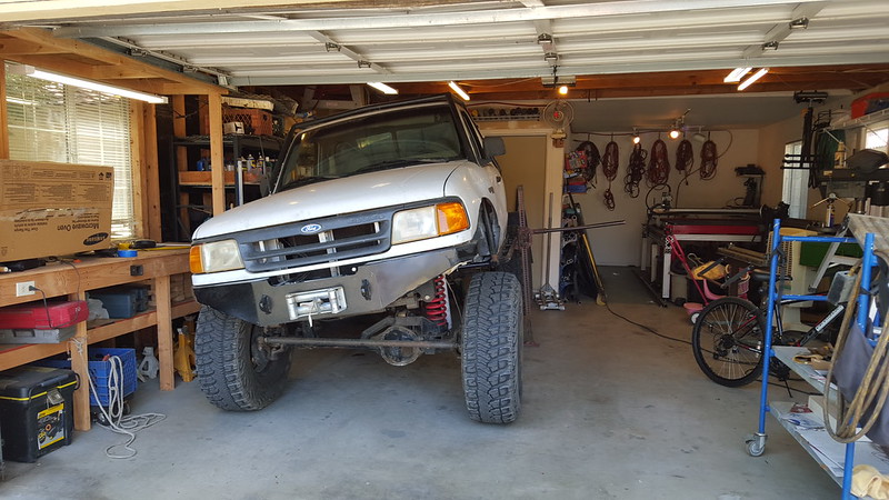

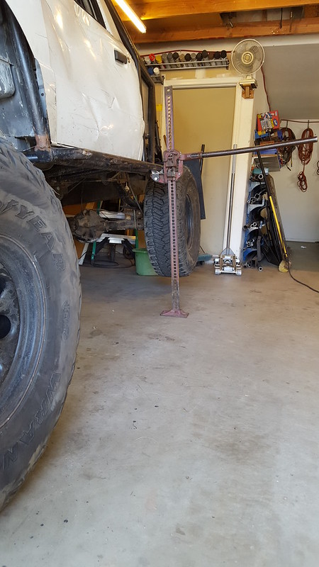

Here it is lifting the truck. For the front I carry a chain to limit wheel travel so I don't have to jack so high.
20150901_135246 by Matthew Dresselhaus, on Flickr
20150901_135302 by Matthew Dresselhaus, on Flickr

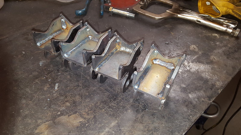

Made a few modifications to this to make it more useful.
20151002_123825 by Matthew Dresselhaus, on Flickr

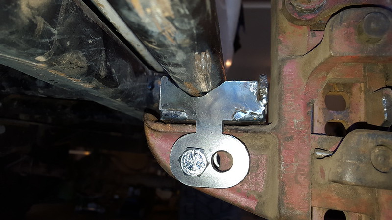

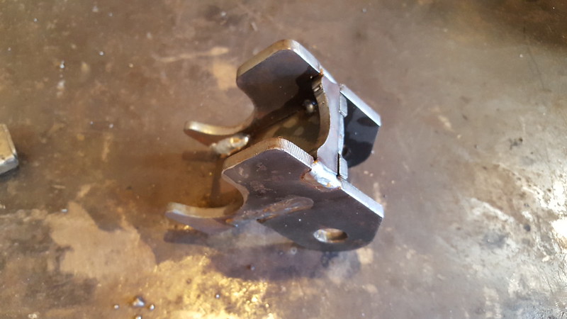

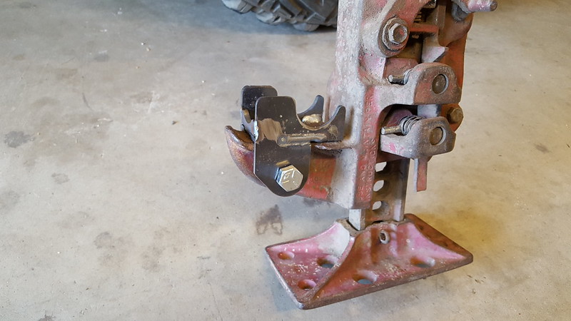

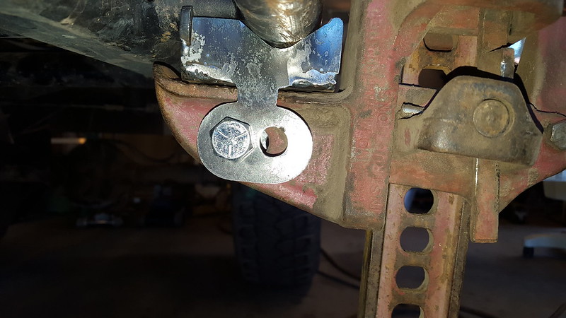

First I went to a "V" shape so it would fit different size tubes. I also added a second hole and made it reversible. There are 4 ways this can be used now.
First is on the slider tube and the spacer tube. It can be mounted on the fist or second hole depending on if you need clearance to clear the body.
20151002_124622 by Matthew Dresselhaus, on Flickr
20151002_124055 by Matthew Dresselhaus, on Flickr

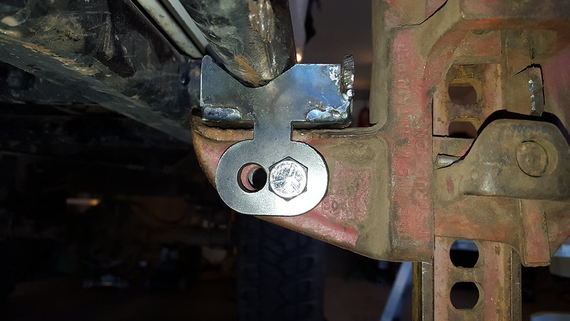

The third and fourth is flipped around just on the slider tube. This allows for more clearance between the jack and body.

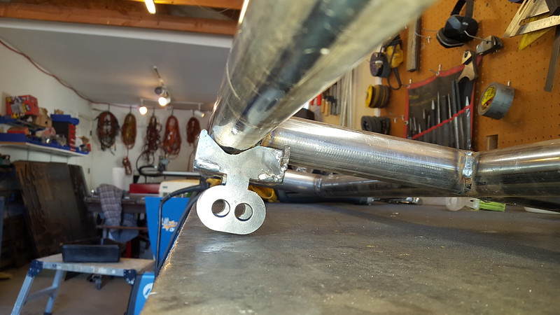

Here it is shown on 1.75" tube joint.
